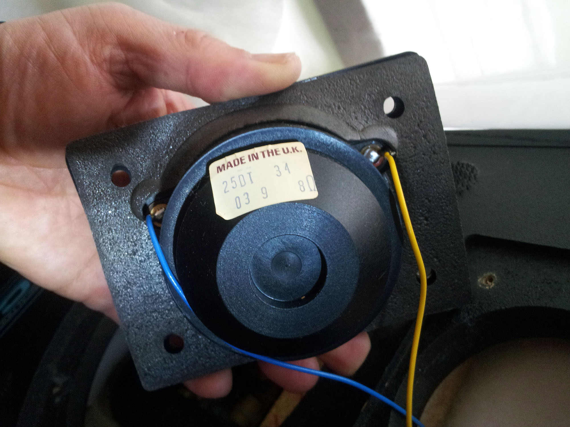

i am wondering if they hare the same tweeter as mc4's (mk1), i found some info on another forum about mc2 mk1 tweeters which sounds almost identical to mine he said - 'the label on the back of the (tweeter) unit is printed "MADE IN THE UK" and stamped 25DT 34 348 8Ohm'
mine have same label, with 25DT 34 398 9 Ohm, his MC2 mk1 have same tweeter housing as well, would they be a possible replacemnet for my mc4's? 😕

correction 8 Ohm, lol
Happy ending!
😀 turns out that the mesh protector grill was touching tweeter, when dismantled tweeter and pushed out grill works fine!😀

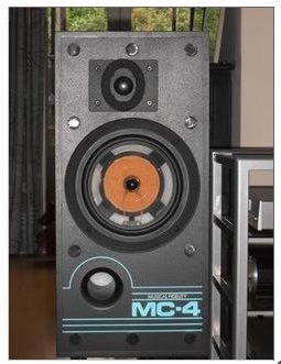

MC4s too bright
Hi all, my MC4s (V1) are overly bright but the tweeters sound fine with no distortion.

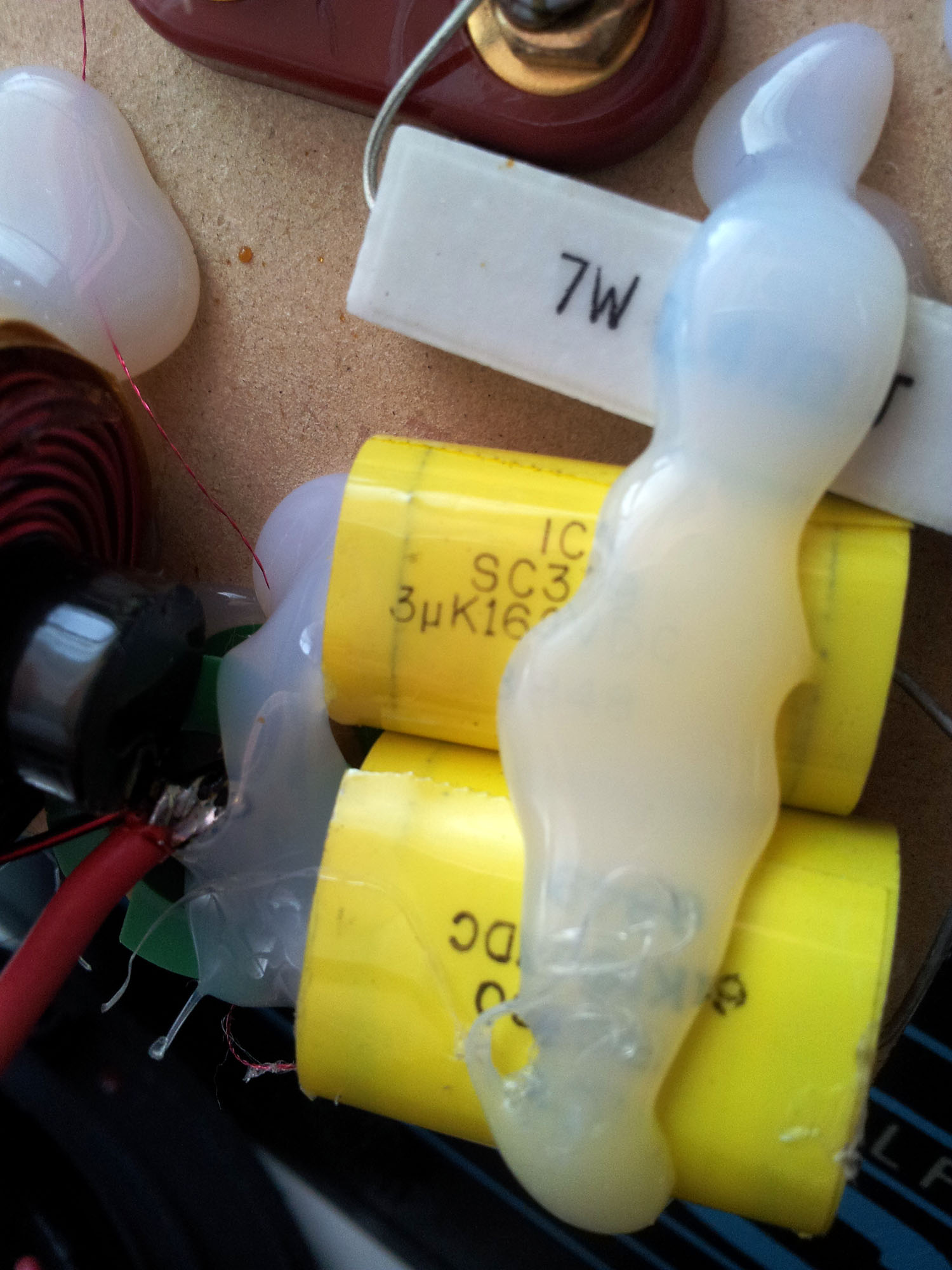

Took a look inside and all is original and untouched.
Only took a close up of the xover caps for the bass, but the highs have the same capacitors again.

Possibly the metal tweeters are not set to your taste. There's a thing in the industry called showroom brightness that sells speakers, but they get on your nerves when you get home. 😀

I take it you have the below model. Looks like polycone and metal tweet. It is common enough for ferrofluid, if applied here, to dry out and solidify. But that usually just stops the tweeters working at all.

From what I understand caps can go off tune with age. So replacing them might tame the treble or bring up the bass so they are even again.
Got no schematic, but there are 4 caps, 2x @3u and 2x @6u

The schematic is something you work out from observation. I'd expect a coil on the bass and maybe an RC shunt, and a capacitor and resistor to the tweeter at least. Perhaps a coil on the tweeter too. Bit like this maybe, but not too interested in coil values anyway. Resistor and capacitor values are readable.
Those plastic capacitors really shouldn't age. But some connectors and joints could be corroded or dry jointed. Crimp connectors to the drivers might be worth pulling off and reconnecting for fresh metal. It's worth noting polarity before you disassemble though. Otherwise you're scratching your head to get the phase right!

I never spend too much on capacitors these days. Good 250V polys are quite adequate. Get 400V types if you've got room.

Now come on. Work out the schematic. I can then tell you why they sound bright and how to fix it. Soggy bass is a given with valves. They don't drive reflex too well. Something to do with damping factor, or lack of it! 😀

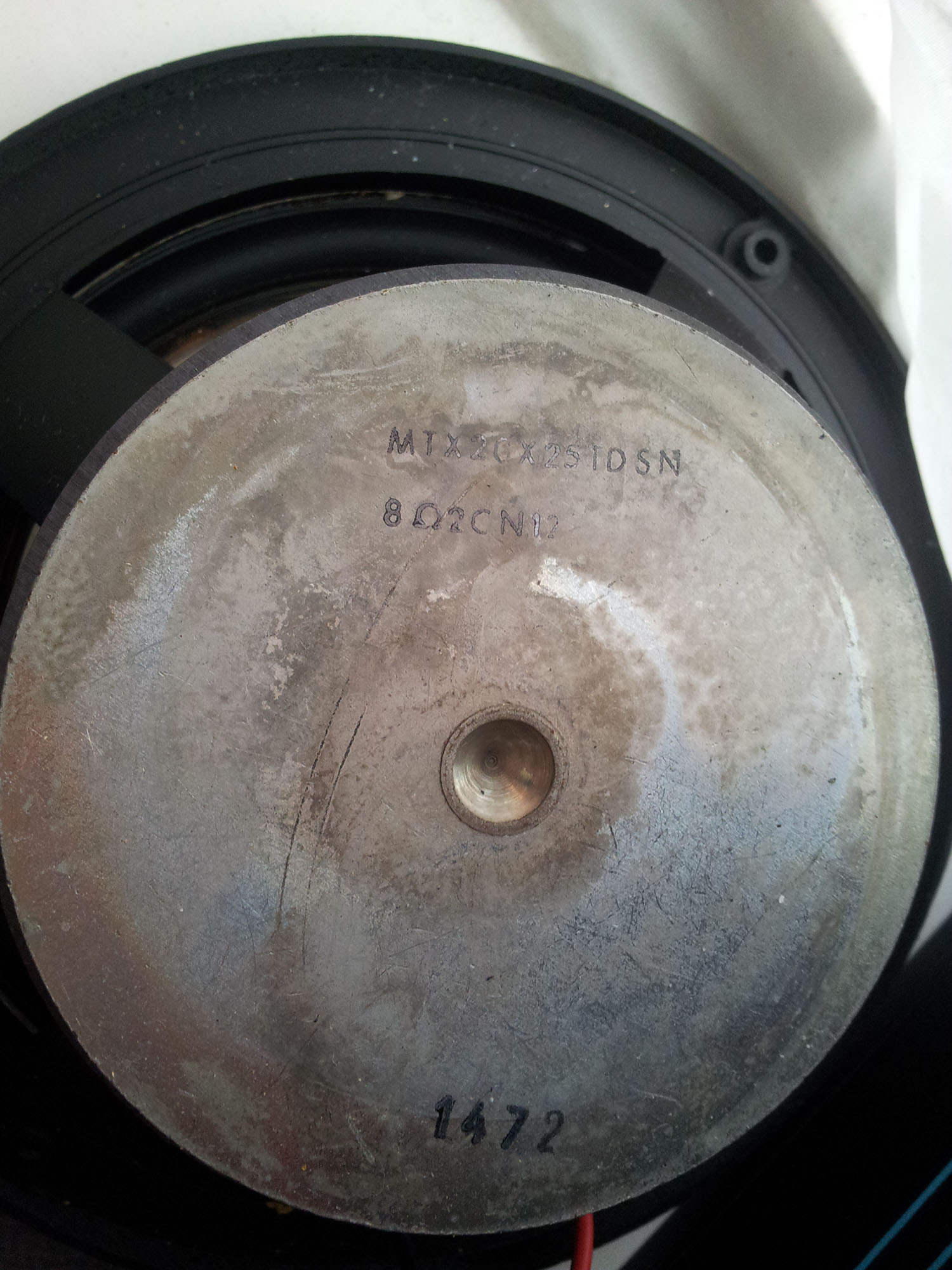

FWIW, I think that bass was used in the Spendor BC1 too. Tweeters are tweeters though, IMO. All much the same.
wonder if bass drivers loose their magnetism or something after a while which could explain the situ ?
Ferrite is perfectly stable. It's the old AlNiCo drivers that needed periodic remagnetising. No, that's not it...🙂wonder if bass drivers loose their magnetism or something after a while which could explain the situ ?
