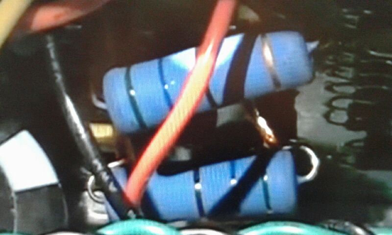

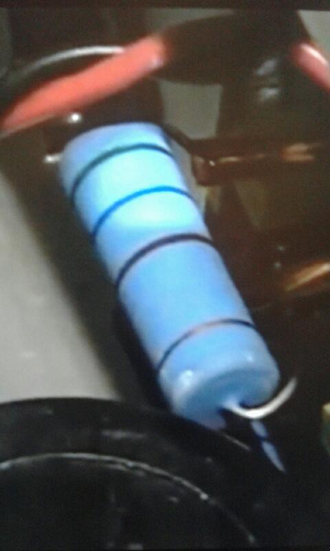

Can someone please help me find a resistor (preferably Vishay) that is;
4 WATTS, 560 Ohm, 5%
I've looked everywhere but i just can't find anything. I'm new to this, maybe there's something i'm missing when searching?

What's it for?
4 watts is an odd size. OEMs order their parts to spec, so if they want 4 watts, someone makes them for them. 5 watts is a standard value, look for that.
And for that matter, if you actually find 4 watt resistors, don't hang up on the 5%. 3%, 2%, 1% work just as well, 560 ohms is 560 ohms.

If it is Green, Blue, Brown then 560R with a silver ring makes it 5% tolerance. If about 1" long and glazed finish, 2Watt. Probably MF type or CF.

You missed the blue body, meaning "flame proof."
On my screen the multiplier looks black which is 56 ohms and would then might be metal oxide. Of course the type of film will most likely not affect performance.
