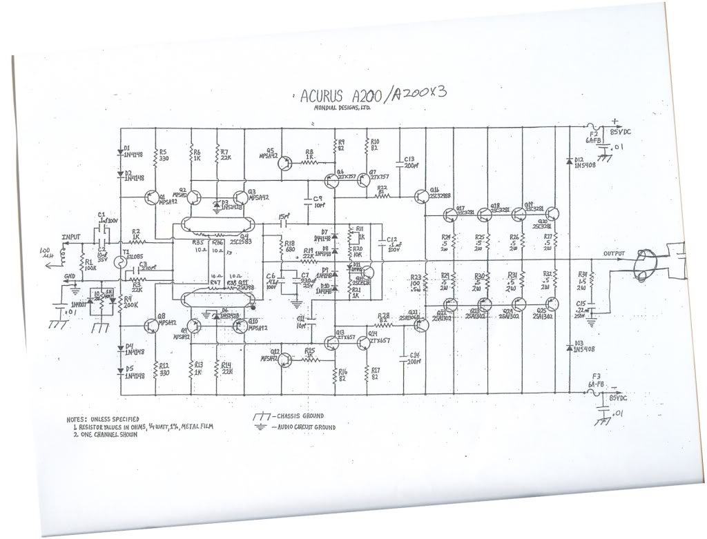

here is the schematic, i really would like to implement a dc servo but do not have the knowledge to do so. Anyone care to give me a how to 🙂 short of that, it looks like ES muse or doubling a pair of Nichicon KZ's or elna silmic II's.
From the schematic, the designer already bypassed these two caps (c2 and c7) with film caps (c1 and c6). Wima MKS caps were used. I am going to replace those as well with WIMA MKP.
ok so here is what I have come up with so far.
input coupling cap C2 - 10uf Claritycap ESA
input bypass cap C1 - .1uf vishay MKP 1837
feedback cap C7 - 220uf Nichicon Muse ES
feedback bypass C6 - undecided (possibles: Wima mkp4 or MKP10 or open to suggestion)
c12 .1uf - vishay 1837 or wima mkp4 or mkp10
here is the schematic.....

ok, the input cap now is a 10uf non polar electrolytic. I have been told that this is the most important cap to swap to a film type. My options are either keep using an electrolytic such as the Nichicon ES Muse or change to the Claritycap ESA MKP which is axial and much bigger.(there are better film caps but money was much more) All of the MKP caps are much bigger in 10uf. I know there is the possibility of picking up noise. The questions is, if I shield the larger Film cap to keep noise out, will it be worth the effort over the Muse bi-polar electrolytic option. This cap is also bypassed from factory with a .1uf Wima MKS. I am switching the stock MKS for a Vishay 1837. Vishay only cost $1 so no brainer. The only cap that is expensive is the Claritycap at $20 ea. I need 2. The feedback cap is 220uf NP and will remain an electrolytic and I will be using the Muse BI-polar there. It gets bipassed with a .47uf cap and I will use a Wima MKP4 as it is the same size as the MKS that is there now. The mkp10 is larger so its out. There is also the one other .1uf cap (c12) which I don't know what it does but for $1, it is getting a 1837 vishay 🙂

Thanks for the schematic - some nice features there. The 10uf value is not necessary for an input impedance around 50k so I think you could use a smaller, cheaper part without bass penalty. It is normal to use much higher electrolytic values to avoid the bass distortion they introduce. The bypass cap does nothing to help there but it will probably sound fair, if a little weak in the bass, on its own - try it and listen for deep bass.
Use a 2.2uF MKP there initially, as these are inexpensive and tolerably proportioned. Brand is irrelevant unless you are considering specialty, unique high-end products with stellar prices.
AndrewT's comment on the feedback cap is fair and the issue of no DC across it considered poor in some circles. Many types have been tried there. Why not a Sanyo OSCON? They are rated to only low voltage in that capacitance range but can be protected by a couple of 5c inverse parallel diodes across them - if you fear the output stage may fail and expose it to rail voltage. It hasn't happened yet, apparently 🙂
M,
the 10uF is followed by 22k to ground this gives an input filter RC time constant of 220ms.
The NFB is 680r & 220uF. This is a filter RC time constant of ~150ms.
These two time constants have been inadvertently swapped because the designer did not think it important enough to avoid AC voltage across the NFB capacitor.
I strongly suggest you at least listen to the amp with the RC swapped. i.e make the input cap smaller to reduce the time constant to ~100ms.
Andrew and Ian, if I put together the advice from both of you, it seems a smaller input cap is the order of the day. I could use a 4.7uf input cap and get a RC time constant of 103.4ms. Does that sound right? A 2.2uf would be 48.4ms. Which would be the better choice?

btw, That's an interesting doodle on the right side of the schematic, after the "output". Does it indicate you've got the loudspeaker cable looped through a ferrite ring or something?
Those time constants give -3dB points of ~10 and 20 Hz respectively. It will depend on your speaker capabilities whether it is "feelable" more than audible. In recent times, design has shifted to keeping bandwidth defined at the input rather than in the amp and increasing distortion. As AndrewT pointed out, the design doesn't address that problem but few older amps do anyway. They still work and people like them.
If you need to restore the -3dB roll-off point to the 5Hz region, you then need the huge 10uF cap and increase the feedback cap to 470uF or much more, to compensate.
Electrolytics need to be 5-10x larger than lowest frequency requires it to be for a flat response, in order to avoid distortion and that's a good reason for not using them in filters, because that condition can obviously be self-defeating.
Andrew also brought my attention to this being closer to 22k resistance so I would not go smaller than 2.2 uF on test as this will then considerably cut the response. For the cost of 1 or 2 cheap MKPs, test and learn rather than accept opinion as right or wrong about ultra-low frequency limitations. DIY! 🙂
PS - Godfrey, didn't see your post but I think that's an output relay.

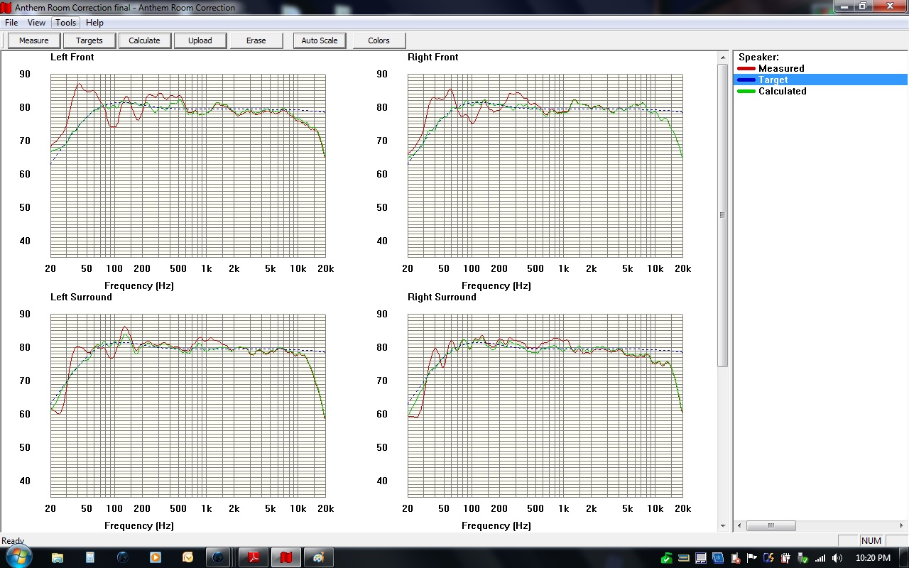

I happen to have a graph from my Anthem room correction software from my preamp. It shows the frequency response of my speakers. they roll off pretty good above 12k for some reason. Fronts are KEF Reference model Two's. These are powered by the Acurus A250. My rears are KEFq80's which use the same tweeter. Center is KEK Ref. 100. Same tweeter again. They are a soft dome.
Looking at these graphs, what would be a good place to start? the Anthem is able to boost or cut frequencies only up to 5k. Above that it can't control. The rear speakers are hooked to an Adcom 2535 so I don't think the roll off has anything to do with amps. the blue line is the target curve and the other two plots are before correction and after correction to achieve target.
ok, so I see the trend. The smaller the cap the higher the frequency for the -3db down point but the lower the time constant. By raising the value of the cap you raise the time constant and lower the -3db down point. My mains have two 6.5" coupled subs. They can go pretty low but I also have a 12" sub that I use. If listening to movies, it is always on and when listening to stereo, I can turn it on or off in the Anthem. When on, it applies a 60hz high pass to the mains and when off, it runs the mains full band width. I will try different caps but the 4.7uf value looks pretty good from both a TC and frequency stand point. I will get something in the 3uf range as well.
