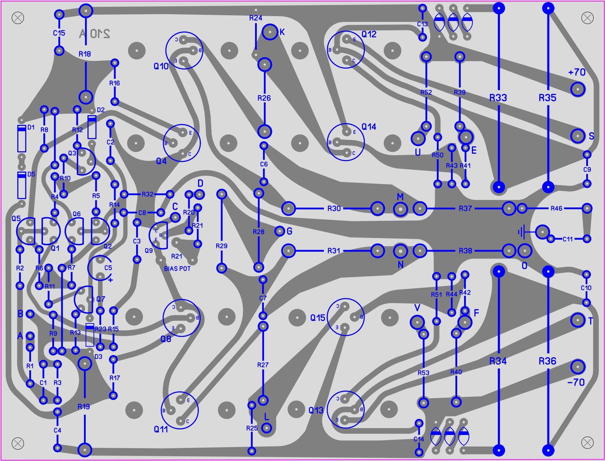

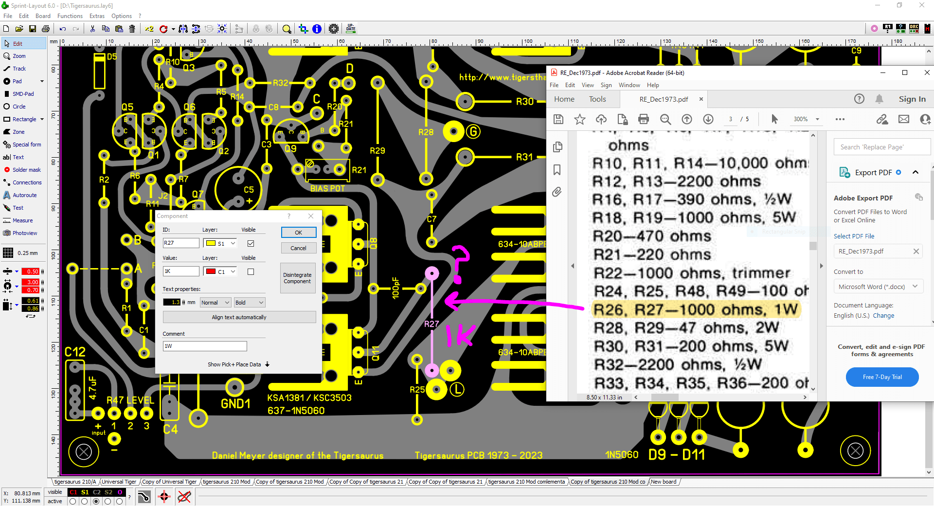

hi has been a long time since I post something I'm just going to post this image of the Tigersaurus 210 here as purpose of documentation here is the idea I have to replace all of those vintage RCA transistors with a new one and new heat sink designs
It looks like you could lay down a ECB-type TO-126 in the right orientation and make the connections to the board using tinned bus wire of the appropriate gauge. With the room that the old RCA transistors took with their relatively enormous heat sinks, you could slip a TO-220 type heat sink (or an aluminum L-bend for that matter) under the part and get by just fine in terms of voltage rating (the old RCAs were only good for 90V anyway) and power dissipation. The new TO-126s are complete overmold, so the heat sink would be isolated - a plus. I would use a squirt or two of hot melt or silicone or epoxy to make sure the new part doesn't get jacked around and broken off.

Years ago, I reused the 40409(etc) heat sinks by soldering metal TO-39/TO-5 transistors into the old heat sink. Bang the original ~TO-39 out with a hammer and punch. But given other issues with this amp, today I would replace the PCB and update the circuit with a "Blameless" circuit. The old outputs were slow, but you could still use them.

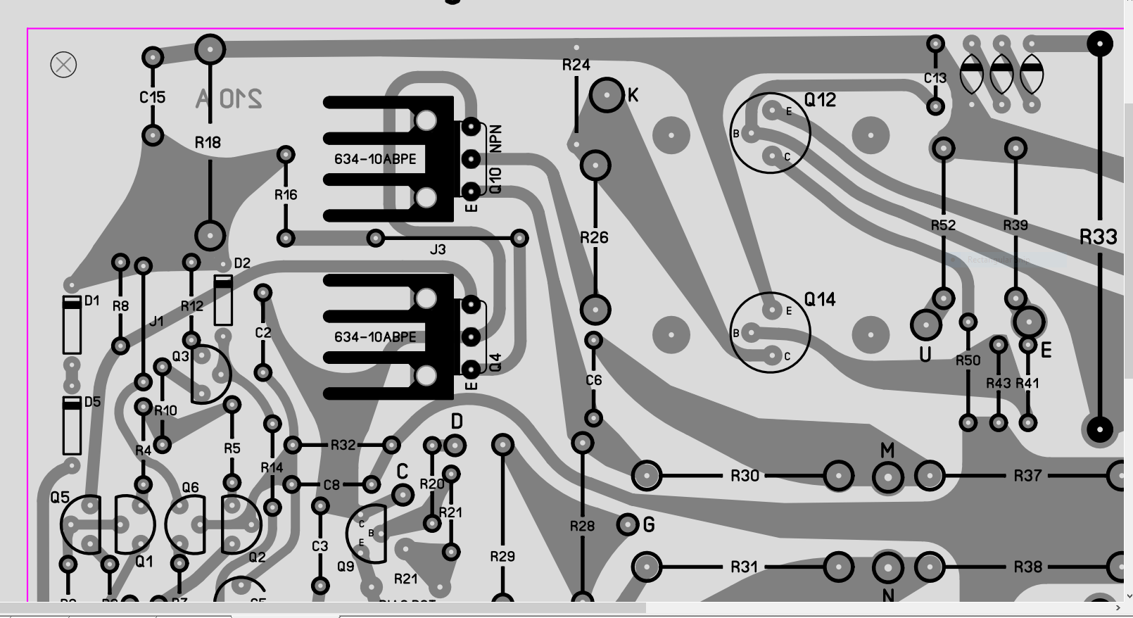

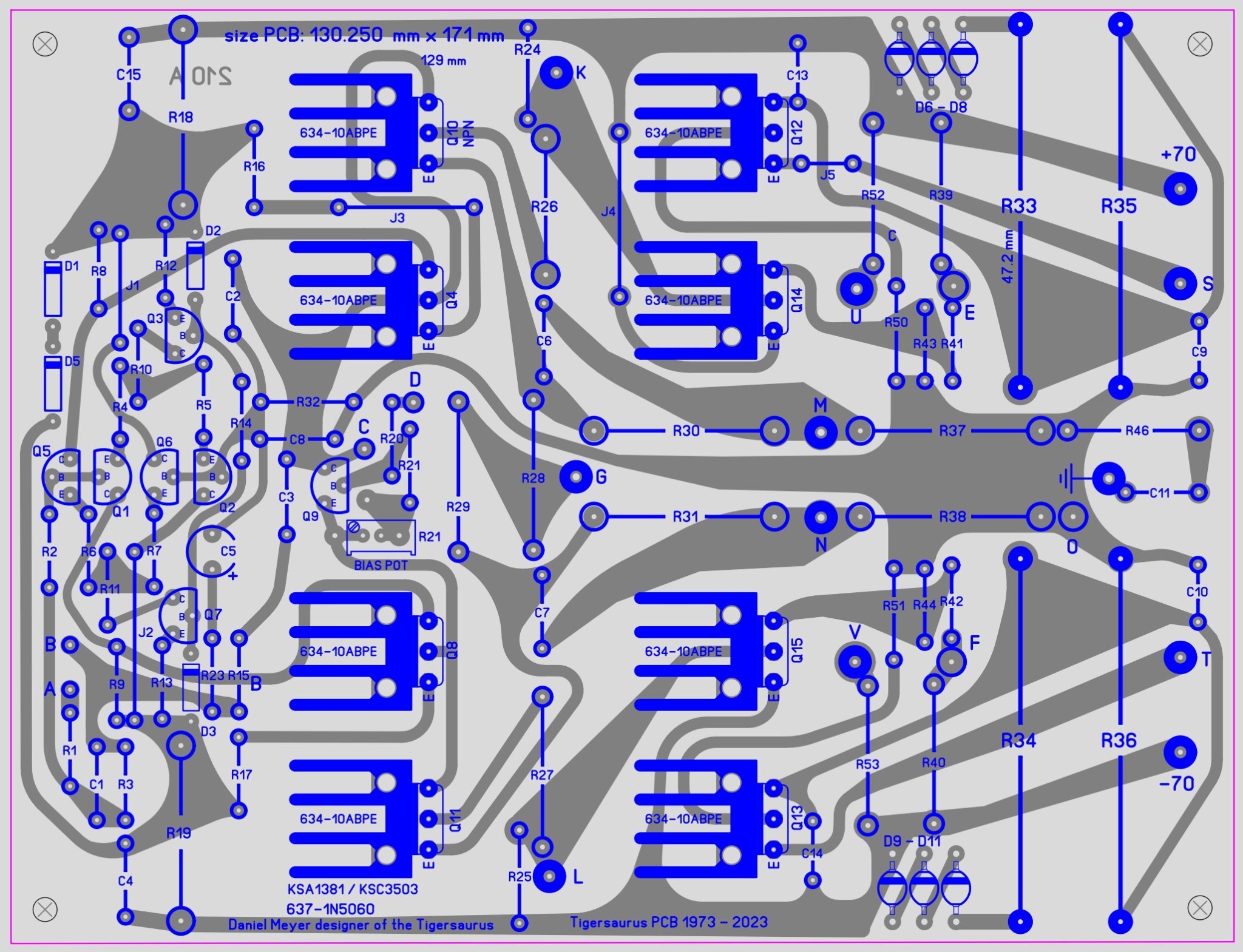

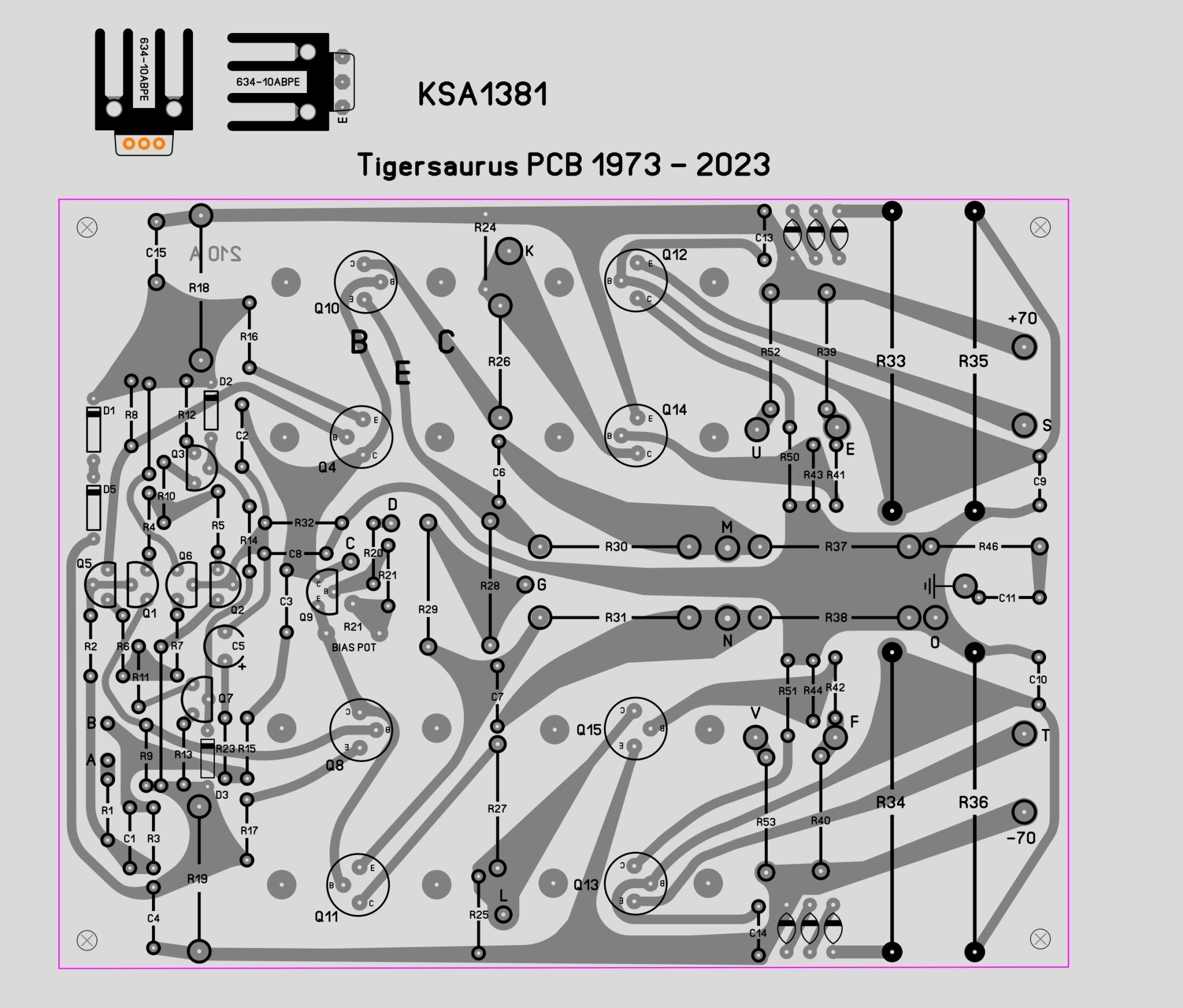

hi I completed the PCB and what I did is reconfigured the traces to fit TO-126 transistors, question is there any extra modification that can be added to the circuit? Yes, I understand that there are newer design that I know, but this will be nice as reference for those that own the design and have images here that
I'm going to post as I go, the first image is how originally goes for those RCA's 40409's the second image is the PCB with the modification for all RCA 40409/etc, those heat sinks can be solder to the PCB too.

with newer heat sink design

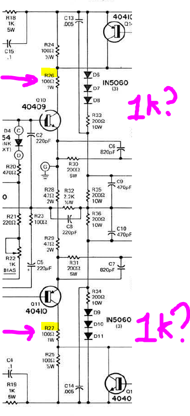

Can you guys help here I was doing the PCB and I notice that on schematic R26, R27 the values are 100R both but on the BOM the value are different they are 1K?
