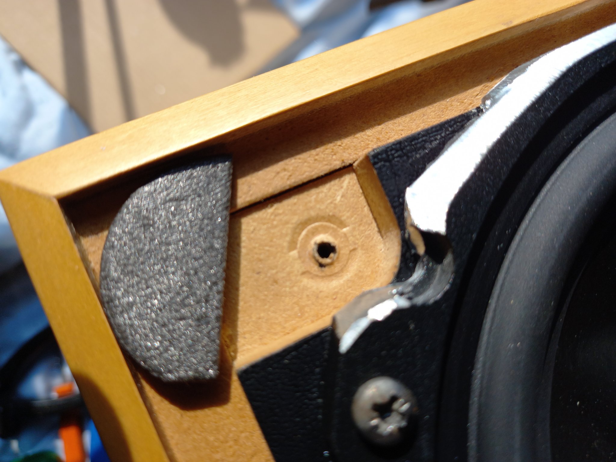

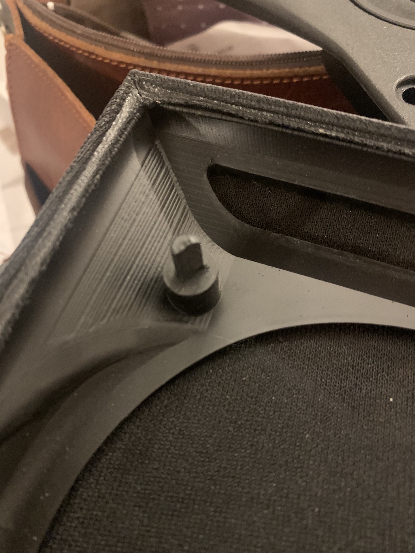

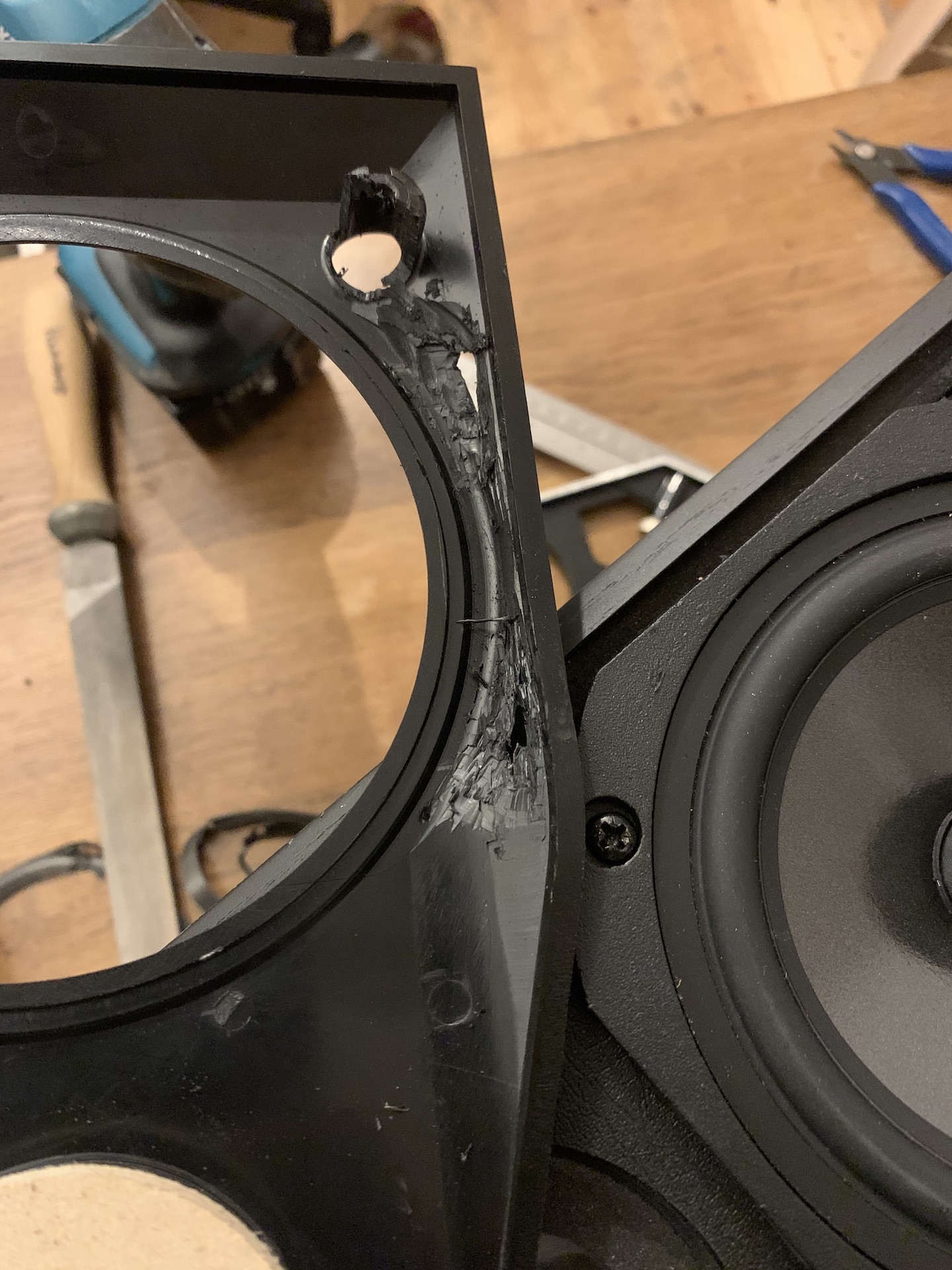

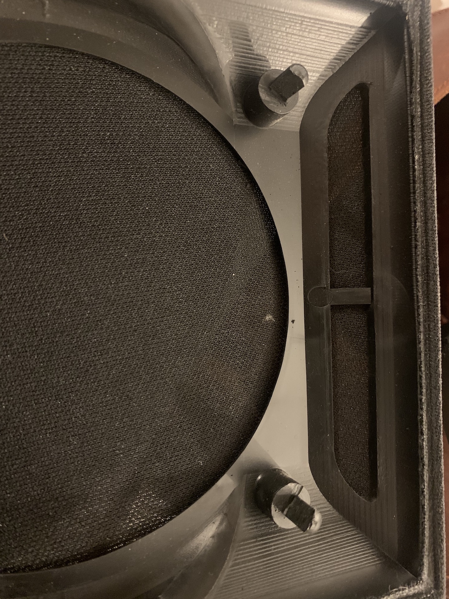

Here's how I went about it. Remember that my criteria were:
1. Don't damage the drivers, or cut the aluminium frame/ surrounds.
Which lead me to imagine I would do the "rout the wood" technique, but this leaves too much of a gap between the front of the driver and the plastic frame, which could really mess with the sound waves, and looks weird. So....
2. Make them sound as well as they possibly can, fitting tightly to the plastic surround/ cover.

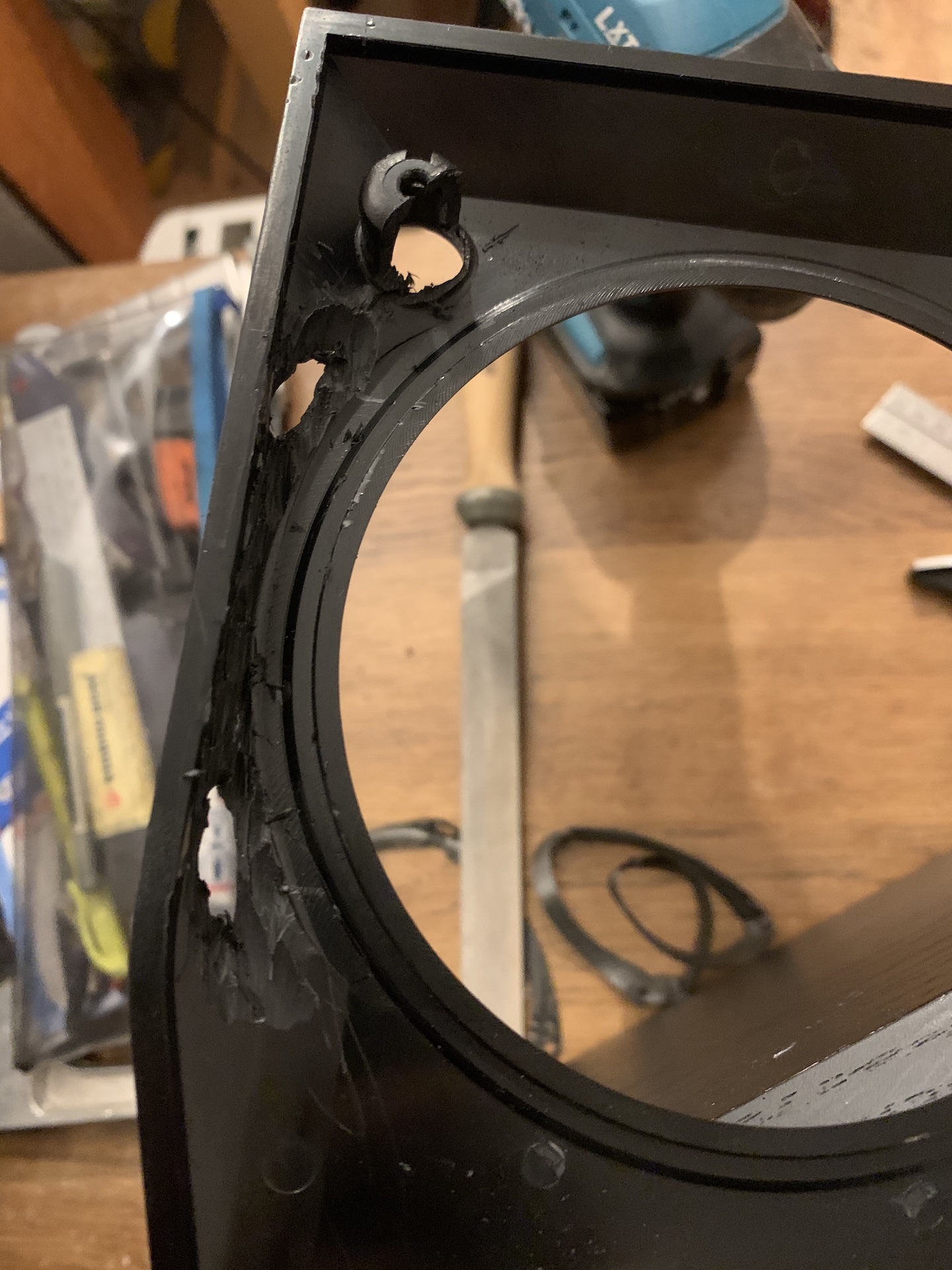

So, I carved the plastic surround to fit the drivers, which meant carving them right through on 4 corners of the drivers, leading to four holes. These aren't 4 holes to the cabinet - they are just aesthetic, and with the grilles on, are invisible.
For my criteria, this method worked well and I recommend it to those with similar aims.

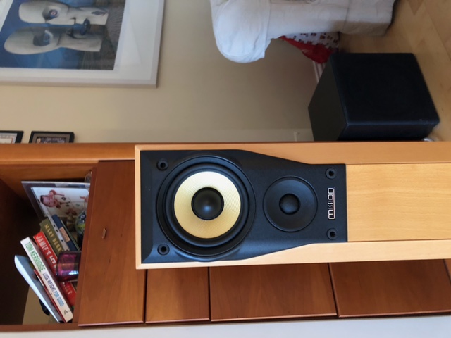

The finished result. Note that the speaker cones fit snugly inside the surround, as the originals, which I feel is important. This is only achievable by either cutting the driver aluminium surround, or by carving the plastic surround piece. You can see the aluminium driver surround both through the 4 new holes, and also where the grill pins go through. The grille pins needed to be halved in size to fit too. Easily done. In total, about an hour's work for both speakers.
I must say that looks way better than I imagined. 🙂
Just some suitable filler if you are so inclined to finish it off.
I do not know if you could get hold of the stuff the car repair people use when fixing plastic bumpers.
As you say its only cosmetic so it doesn't effect the sound.

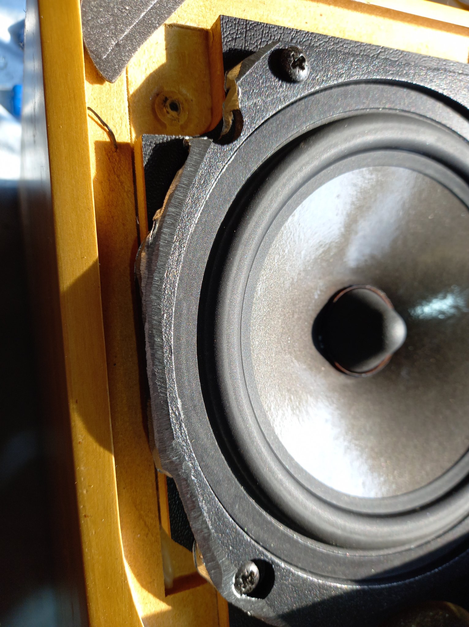

Thanks! Yes, it may not be everybody's best solution, but I had to invent a third way, as neither of the other methods on the internet seemed as good to me, for my spec.
Oh, I should also mention, should anybody want to replicate this, I used a Dremel rotary tool (a cheap copy actually) with those super fragile cut off wheels, about 30mm in diameter, which break far too easily as they're so thin. I got through about 6 of them, rather tediously, doing this job. They're cheap, but replacing them every 5 minutes is a pita. I also used a sharp 10mm wide chisel to neaten things up.

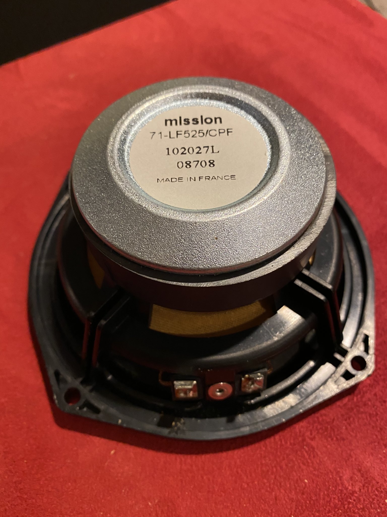

Hello Lucas,can i ask were you bought the replacement drivers? My 782s are in need of a pair too,thanks

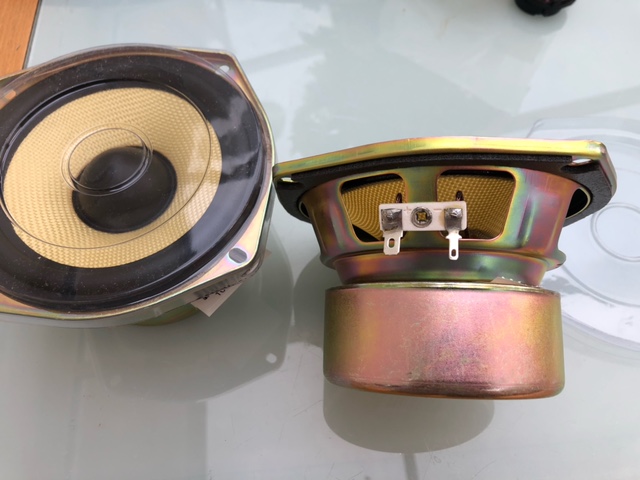

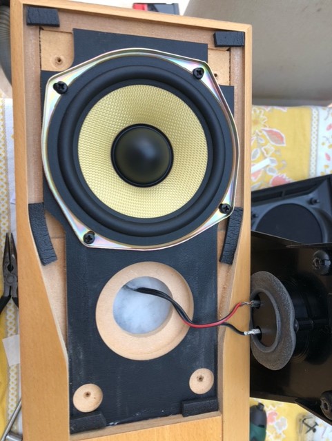

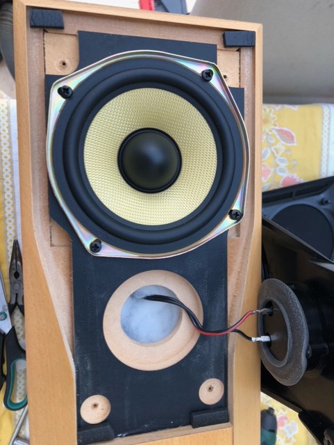

Hi Every one

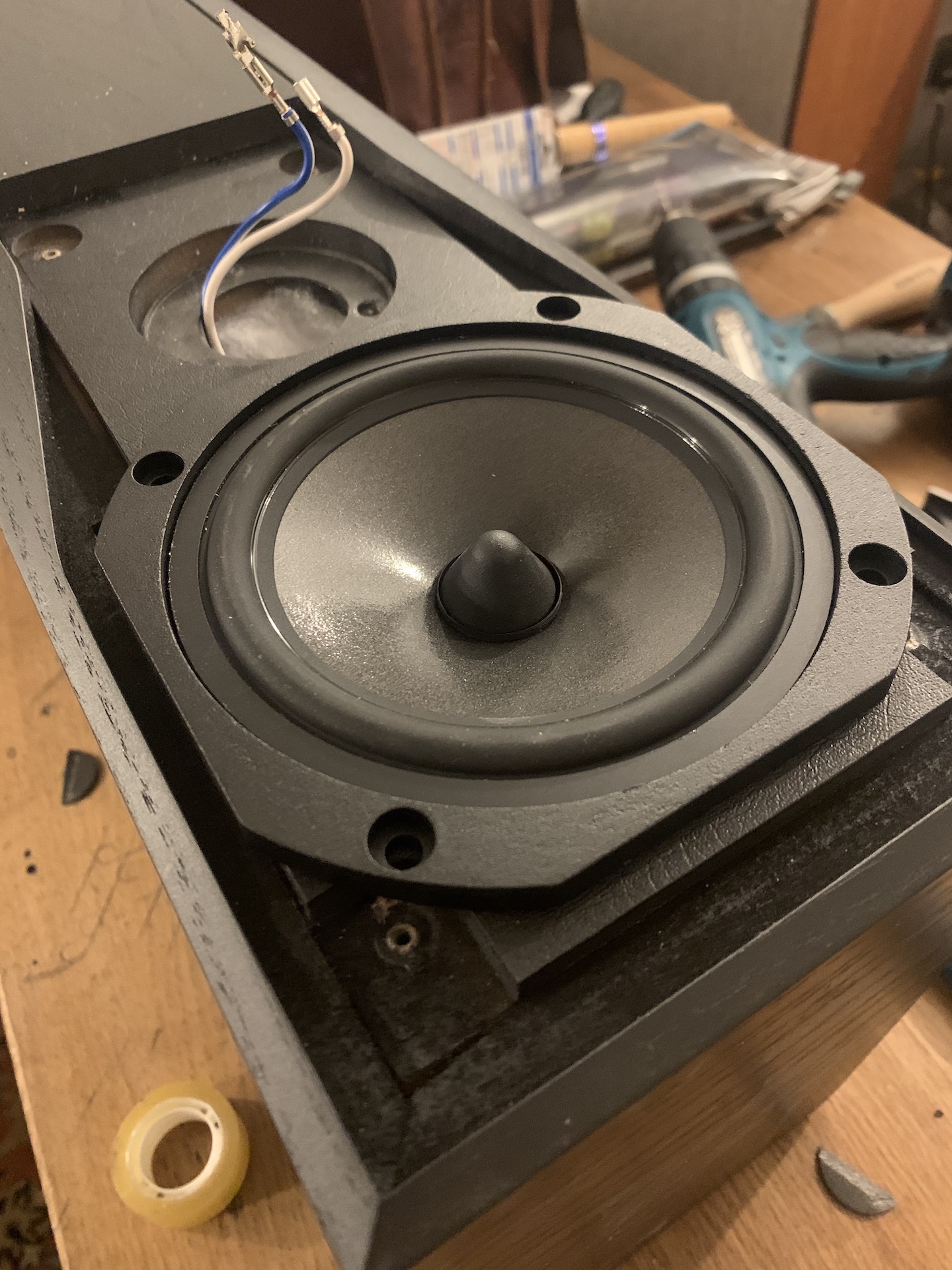

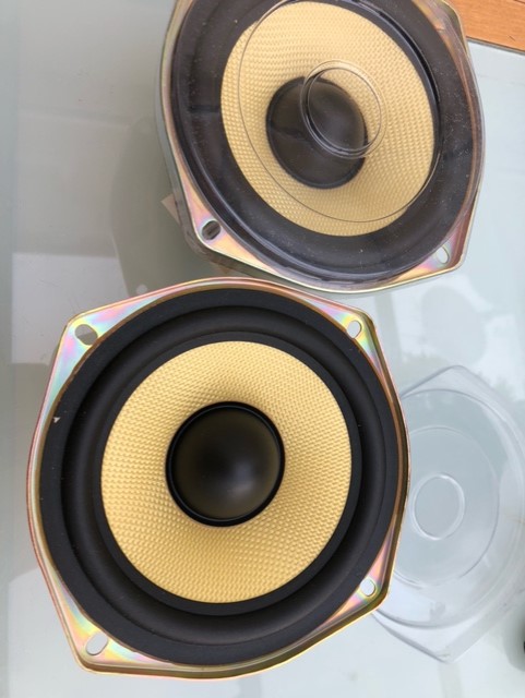

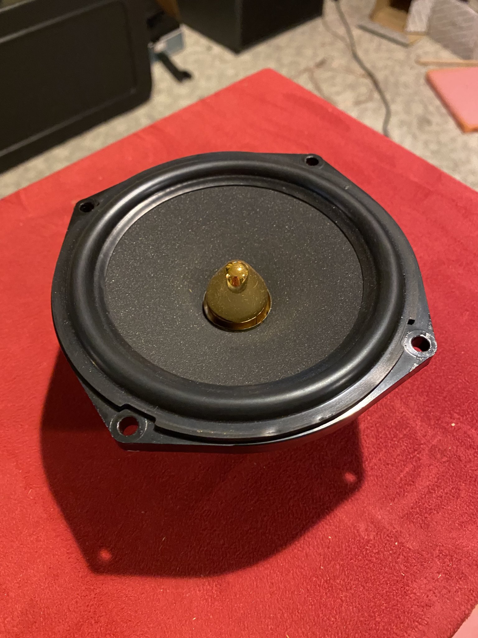

New user here. As all of you had the same issue but rather than butchering the speakers I managed to fit midrange drivers which were originally produced for B&W and there is no need to become a carpenter to fit them and personally the sound is better too and sharper.
Originally produced for Bowers and Wilkins and bearing the ID ref - ZZ11681
It is an ideal replacement for the KEF B110, both as a mid range in such systems as the KEF Concerto and Cambridge R50, or as a mid/bass unit in the LS3/5A and Linn Kan's.
Can also be used in many Mission speakers such as the 753, Castle models such as the Severn and many other speakers which are fitted with a 5" mid/bass units of this shape.

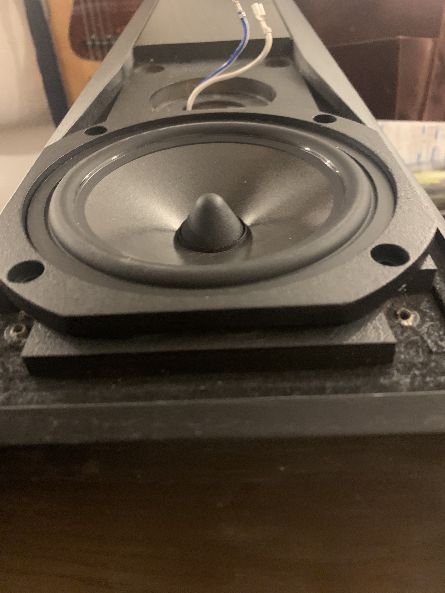

just a few photos to give you the idea
Thanks- how do they sound on the 782s?
Perfectly fine
The sound I would say is a bit more open compared to the original Audax mid with better clarity for the mid/high notes, or at least that is my impression comparing them with another set of 782 I have with the improved Audax mid.
France! I bought them from a French company that shipped them over.
https://en.toutlehautparleur.com/speaker-audax-hm130z12-8-ohm-5-35-x-5-35-inch.html

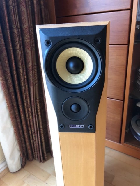

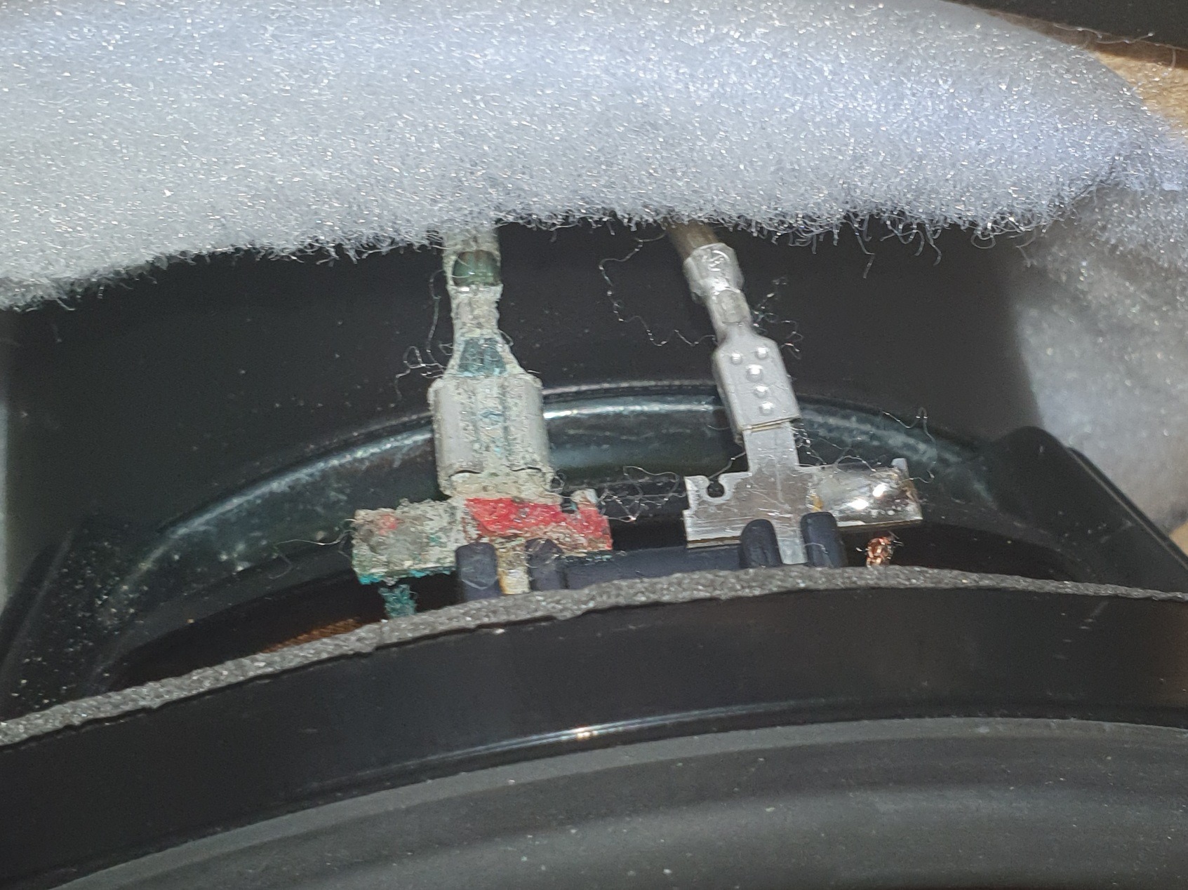

Checked one of my speakers this morning and its starting to corrode, they were in storage for a long time, then mainly used for AV, but back to stereo now.
I would prefer not to alter the speaker cabinet etc. at all, if it can be helped. Which is why I'm interested in the B&W option as a direct replacement.

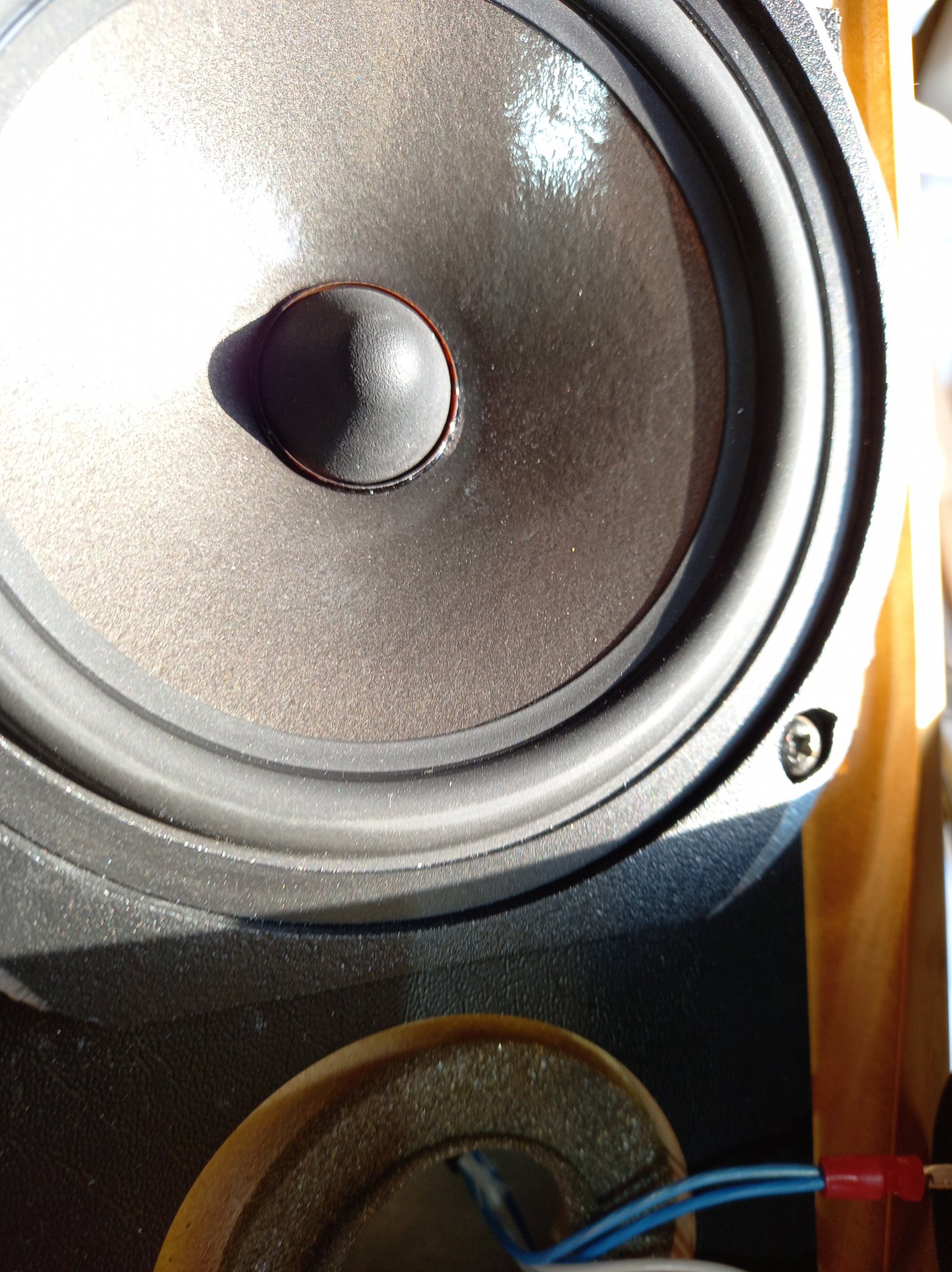

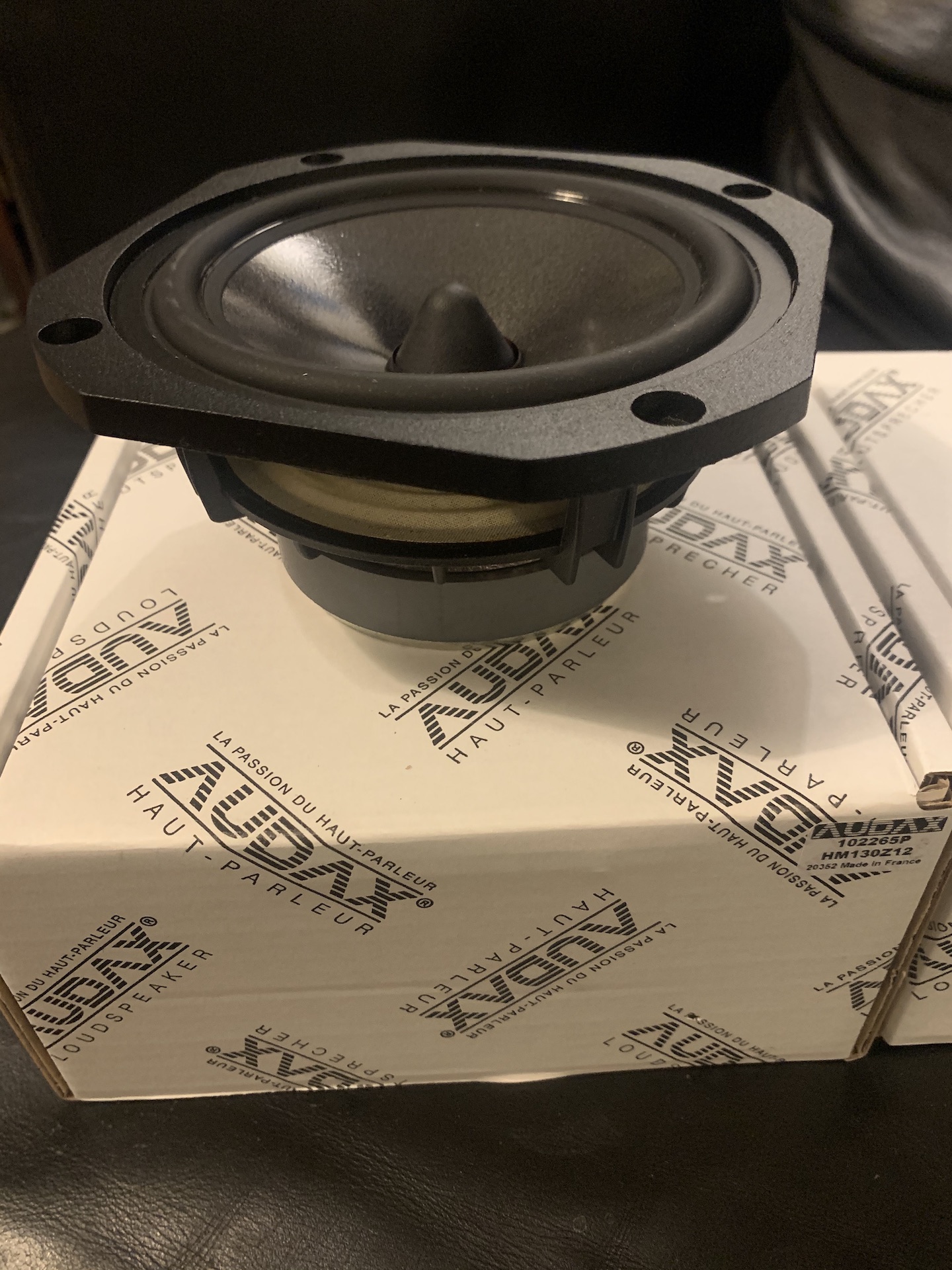

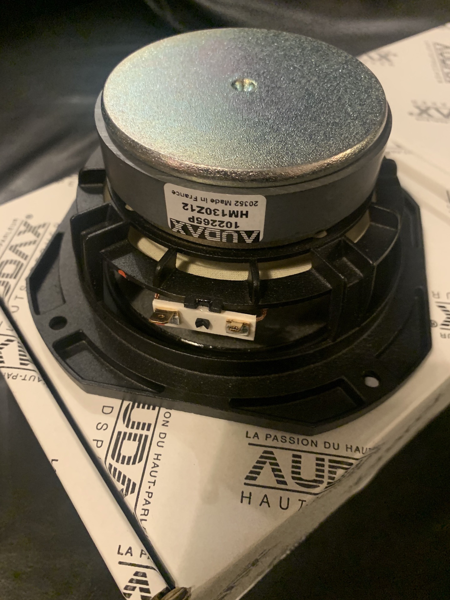

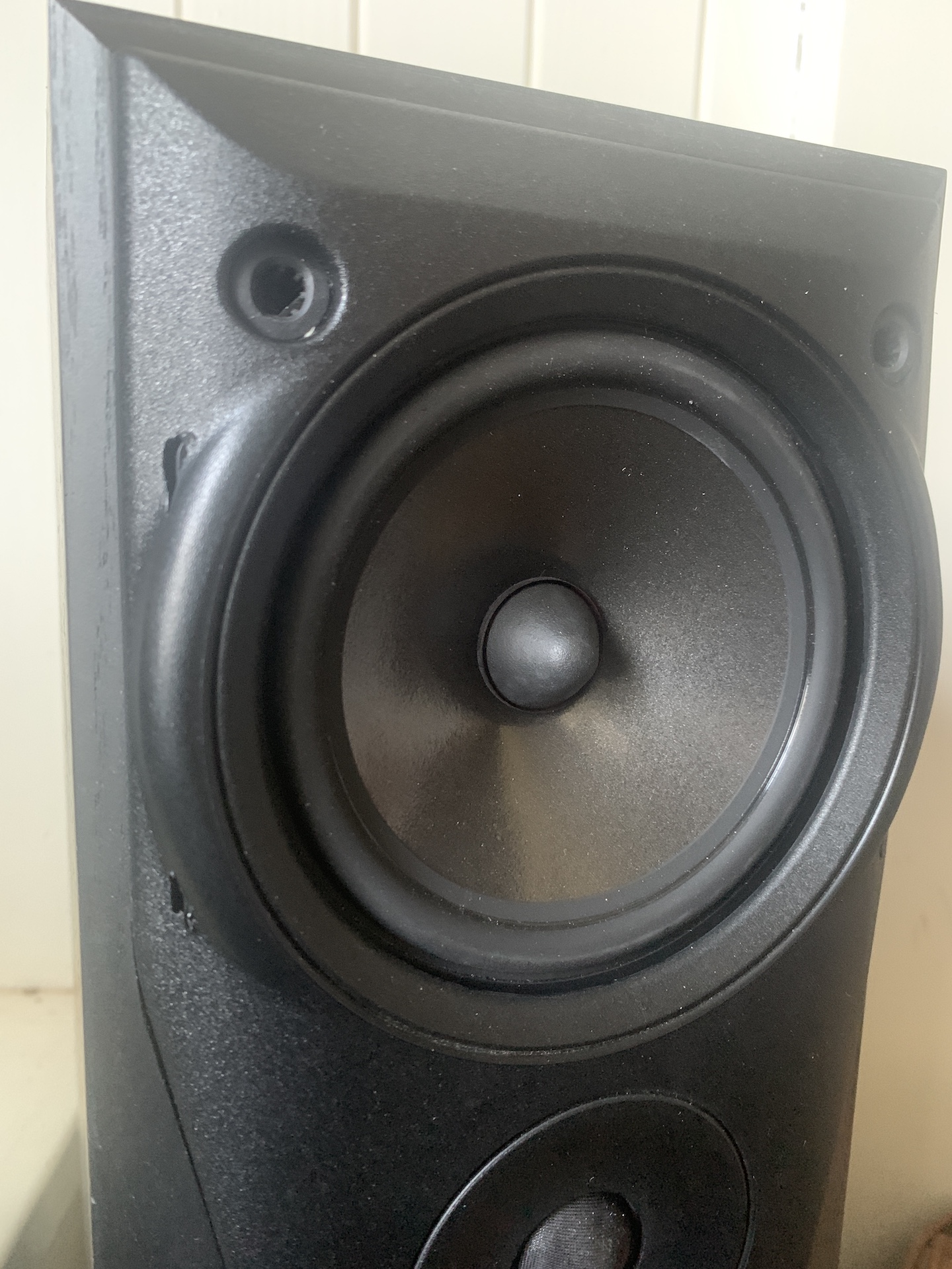

I have just repaired my Mission 782 SEs with the Audax HM130Z12 drivers, ordered on-line from TLHP in France. They arrived here in the UK in less than a week. I fitted them without altering the woodwork or the plastic cover & grill. Rather than hours of cutting using a dremmel I used a bench grinder to take of the bits that stopped the cover fitting back on. Namely, you sacrifice the 2 top holes altogether (make new ones on the top edge where you don't have to grind at all). You don't have to grind the bottom edge at all. You DO have to grind bits of the sides (the bits where Lucas Adamson above made holes in the plastic to accommodate). Less than an hour per speaker. All done. They look and sound good.

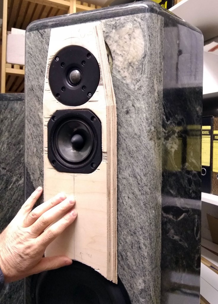

I think that people are wasting a lot of energy with reading reports and guessing which driver and inductor etc. to use, instead of investing some 100€ to a measurement microphone.
Sad is also how many well respected commercial loudspeakers have poor performance and poor crossovers that waste the potential.
I can't design passive xo, so I use multichannel dsp in my projects. Here a 3-way analog-active converted to dsp-active, using Audax HM100Z0

You have to 'go for it' a bit with the grinder and take the view that they were built to vibrate! At about £60 per driver and not hacking the cabinets about the risk is limited if you screw up. And the risk was all worthwhile. . .Yikes! I'd have a hard time taking an Aerogel to a bench grinder. I'm sure you covered all the various VC openings? Otherwise, looks great.
Have had a lot more time to hear them today with various genres of music including Morgan Wade, Mendelssohn Violin Concerto, Dr Feelgood, Johnny Kidd & the Pirates, Brighouse & Rastick Brass Band & Alison Krause and Elvis too. Really pleased to have them back in action. The Arcam A29 drives them well and they arguably do sound better than when I got them new about 20 years ago. Mind you, back then my Amp was a Pioneer A400, which was great in its day but probably not quite so good for these speakers.

Further to mending my Mission 782 SEs above I found a pair of 780 Mk2s with dead Keraform drivers on eBAY and got them for £25 incl. postage. I ordered up another pair of the Audax HM130Z12s from TLHP in France,(about £110 for the pair delivered) which again arrived here in the UK in less than a week. Less than an hour per speaker again, using the same technique and they are 'as good as new'. I now have some very fine sounding kitchen speakers, I cook a lot!
