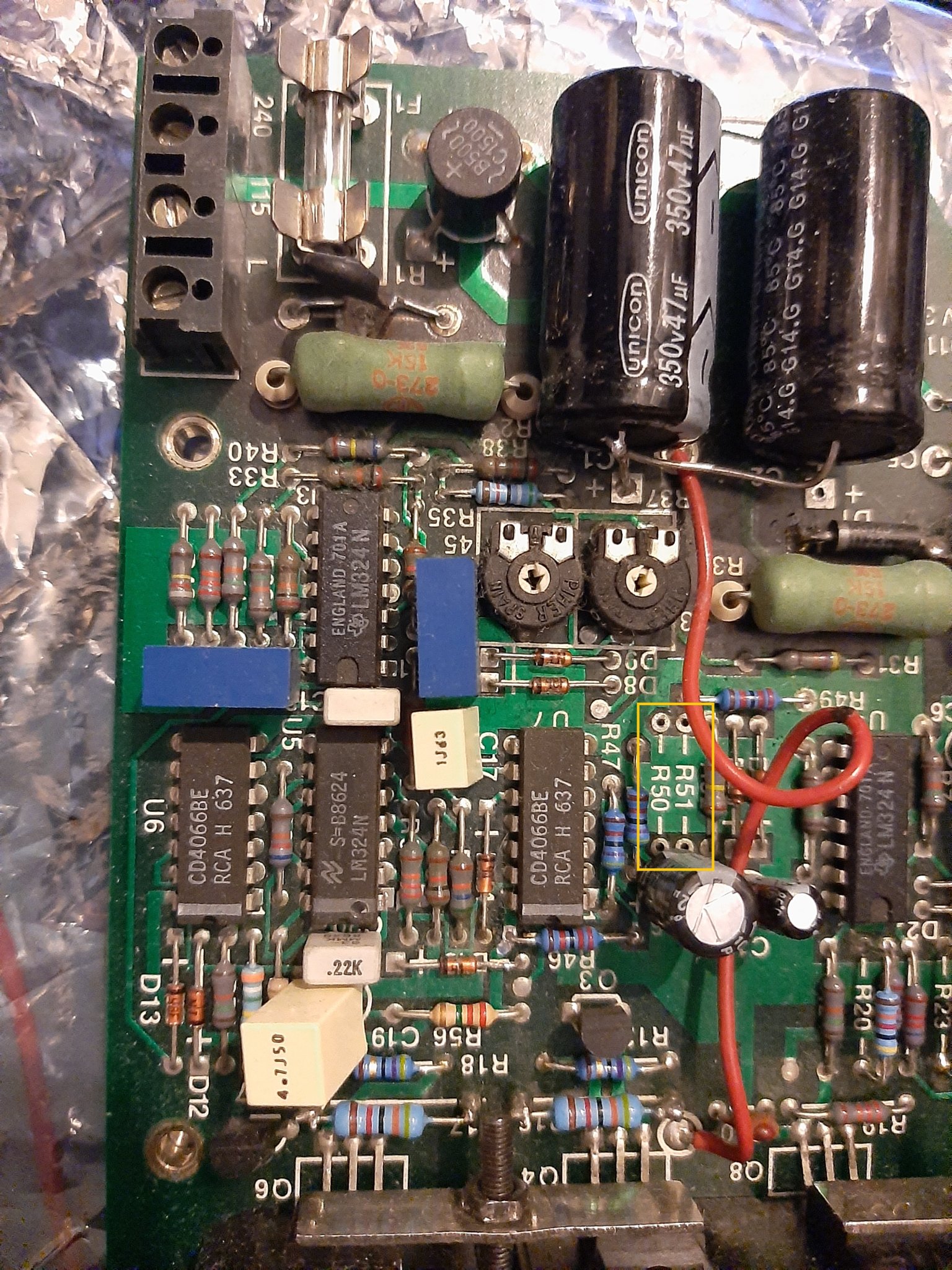

If you alter the values of R50 (33.33 rpm) and/or R51 (45 rpm), the 'motor run' voltage will change.
If you remove R50 and/or R51, the 'motor run' voltage will always be maximum.
Good Luck experimenting...!
I've been experimenting and I thing R50/R51 needs to be there since it (if I understand correctly) controls the switching between high and low voltage drive at U6 (pin10-12) and U7 (pin 6-9). With other values the drive becomes unstable, since switching occurs intermittently.
To change drive voltage it must include both U3 and/or U4 amplification, as I see it. This would require more calculations to switch components, I believe.
I finally ended up using the old motor which "works" with 25 VAC during operation. I managed to switch the pulley to the LP12 pulley so now it does not wobble anymore.
I still have one error though, and I don't get the 87V start-up voltage and the current sensing during operation. So I do a manual start by hand.
I have 12.6V on SD but it does not drop down upon start. The only ICs I have not changed are the LM324 U5 and U3. Perhaps the first pair U5 amps have blown? I still not certain what it is that makes the 87 to 25 VAC drop, but this is the only amps connected to the motor ground.

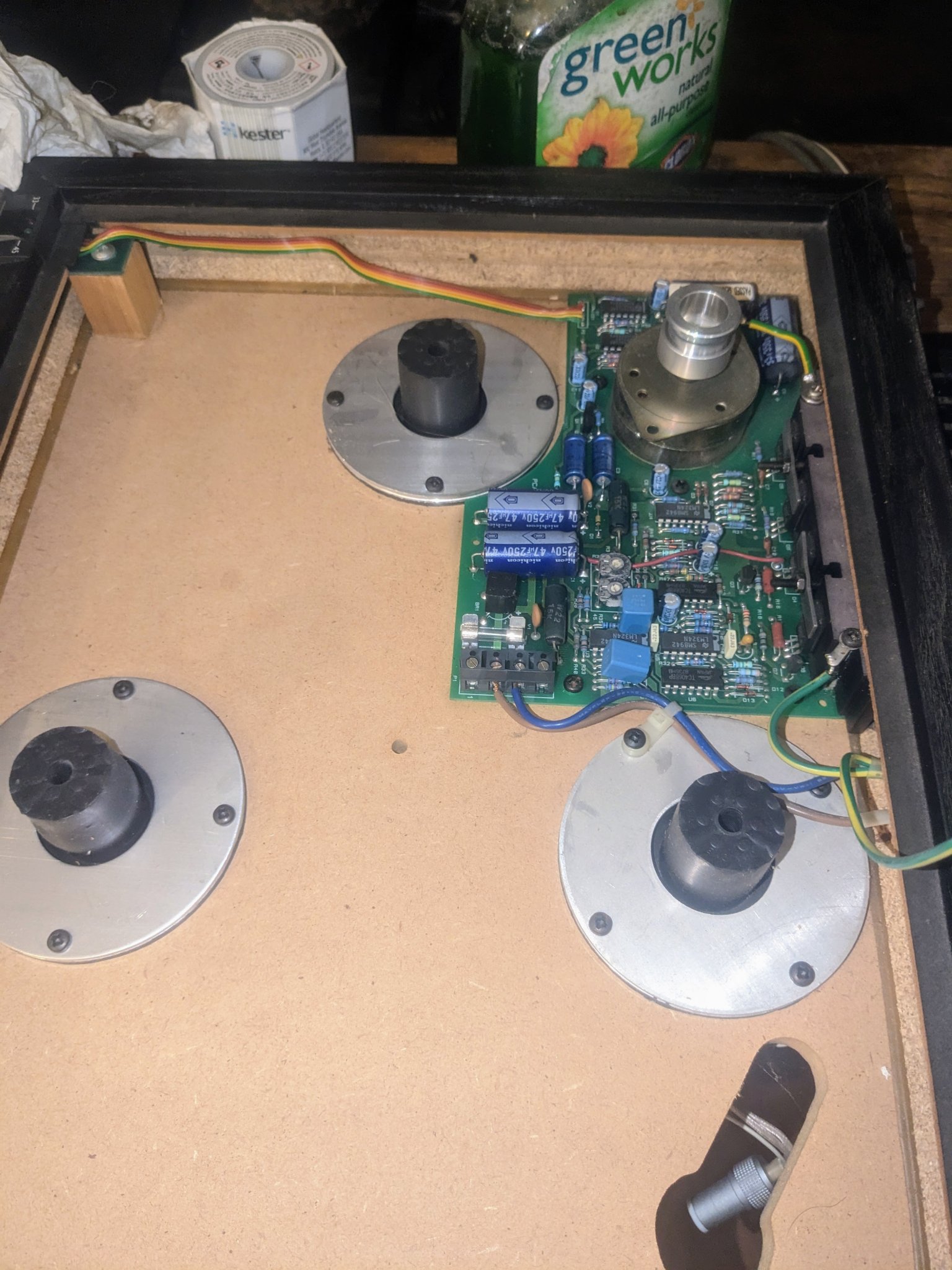

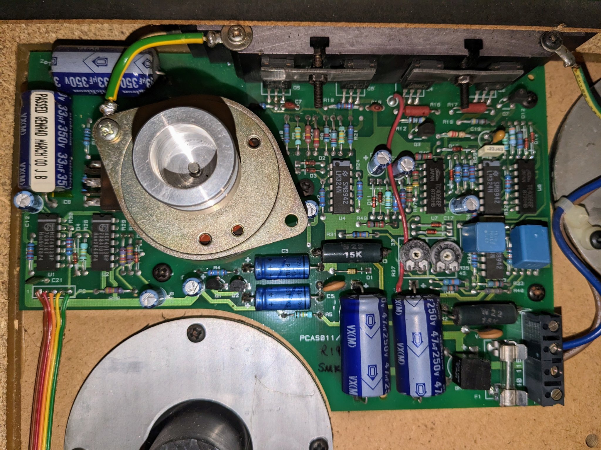

I have an Axis from very early - 1988, maybe? Basik Plus was the standard arm. It is still running fine, but I am worried. I am trying to figure out how to open it up? There are not many pictures in this thread. I am a visual person.
How long after unplugging it is there high voltages present?
Okay - dumb question - here's a video showing the initial disassembly:
It has a different ribbon cable - the switch is mounted on the plinth, so is not detachable. Caps look good - but obviously they are 35+ years old.

If the TT works as it should, nothing needs to be changed. Just leave it. You can
1) look at the motor pulley when running. Is it smooth or does it wobble? Mine did and I finally made a change of the pulley, but it is hard if you don't have a puller. And expensive as I bought an LP12 motor and used that pulley.
2) change belt if it is old (yes it will actually affect speed!)
3) clean pulley, belt and rim of platter drive. The pulley and platter should SHINE.
4) change oil if very old
5) adjust speed with a test record (it is a bit tricky, but I put the TT on two chairs, having my phone on spectrum detection while playing 3150 Hz, and lying on the floor under the TT. Then setting the trim pot closest to the motor from under the TT as close to 3150 Hz as possible. Switching to 45 RPM, setting the other pot to 4252 Hz.
All those things would probably be better if the drive works as it should. (You could measure the drive at the motor IF YOU FEEL SAFE doing so. Around 87 volts at start-up, and 25 volt at run state.)
