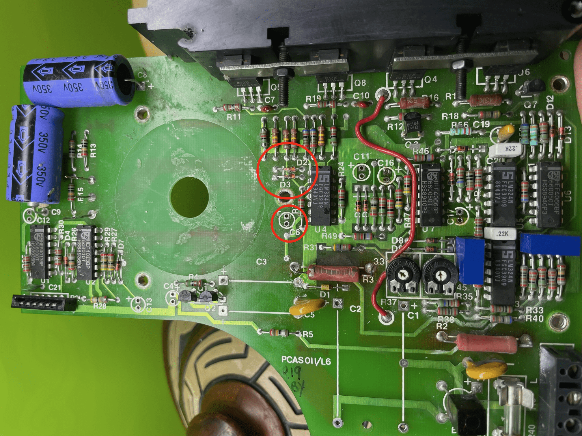

I was going to replace the motor and managed, but unfortunately I made a few mistakes and shorted the PCB due to small copper threads stuck on the PCB. I should have been more careful cleaning it. Nevertheless I am in the process of desoldering and trouble-shooting. Found that the D2/D3 and C6 were dead (see also image). Also C3/C5 measured strange. C1/C2 ok, as C8/C9. Remaining electrolytic caps seemed fine. R2/R3 and D1 measures fine.
I suspect however that some of the ICs might have failed. Any way to measure them with a DMM to check? I suspect U1/U2. How about U4 (LM324).

Best to change the resistors regardless of how they measure. R3 has certainly been overheated. Are you measuring the caps in circuit? This won't give you proper readings as some of them are paralleled. Either way, regardless of how they measure, all of the electrolytic caps should be replaced. They're not expensive and those ones in there are at least 25 years old.
The Axis boards is a rather fragile thing and traces are easily damaged when removing components. It's very easy to pull the pass throughs from the component holes that connect the traces from the lower and upper side of the board.
The ICs in my experience are pretty robust and I've never had to change any. Which part of the board shorted and do you have the circuit schematic?
Agree that R3 is "on its way". Traces are ok so far. One part which was damaged was the D2/D3 diodes; they were split in half (se picture). C6 was gone as well. R10 looked as if had a "choke" as well but it measures ok. The closest IC is U1 and U4 connected to diodes, which I suspect may have been damaged.
The record player initially played after the motor change, but did not come up to speed. Checked and it turned on directly (red diode on) when plugged in, but no function. Found out there were some shorts but difficult to say if there are more than what I've observed.
The caps have been measured outside the PCB and all were fine except for C6 and C3/C5. The C1/C2 measured 46 uF. Q1/Q2 fine as well.
Will replace caps except for C8/C9, D2/D3, U1 and U4. Then well see. Will install an LP12 motor with its pulley.

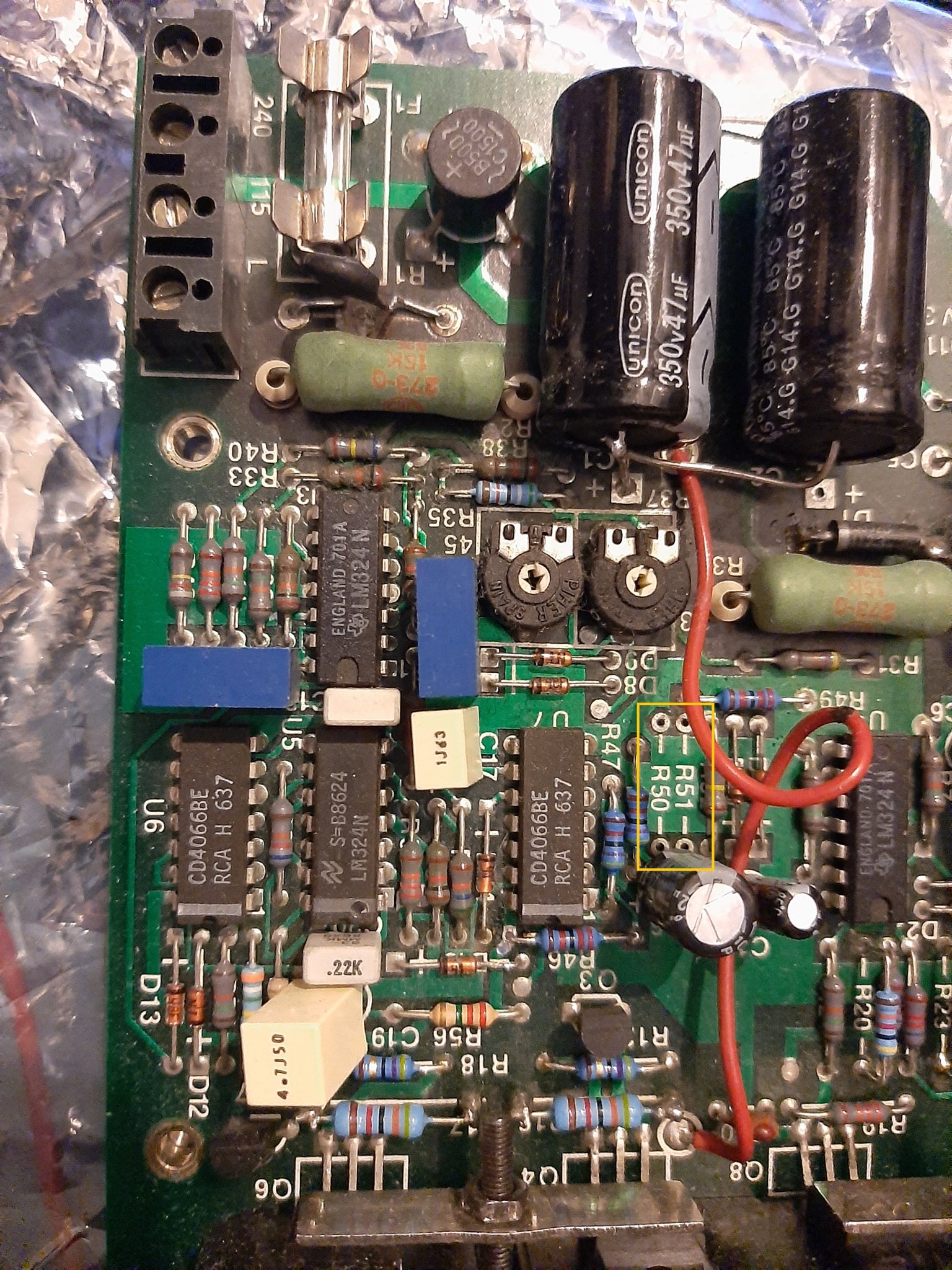

I wonder if someone could help with modifying the control so that the operational voltage would be 45V rather than 25V? It could probably solve the operation of the new motors with higher winding resistance.
If you alter the values of R50 (33.33 rpm) and/or R51 (45 rpm), the 'motor run' voltage will change.
If you remove R50 and/or R51, the 'motor run' voltage will always be maximum.

(BTW Changing the R50 to 30K makes the drive voltage at 45V, which I am aiming for with the LP12 motor. Will check the 45 RPM as well/R51 to get about the same)
Still working on it and 45 RPM works. But not 33 RPM. Voltage at O1 is stable at 45 RPM and gives around 89 V at motor windings, but fluctuates at 33 RPM at U4 (pin 1) and at motor windings as well. (I have left out the R50 and R51.) Scratching my head about this.
It is up an running with the LP12 motor now. I did not manage to fix it completely but it is now running at around 60V at 33.3 RPM and 80V at 45 RPM instead of around 90V. I seems stable with added resistors, quite high values for R50 and R51 added 68k and 270k.

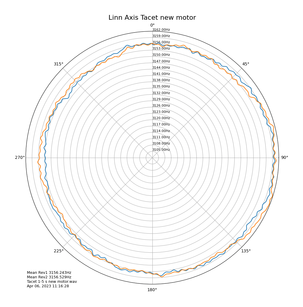

I have adjusted the values further, R50 to 30k - giving a voltage of around 45 V. The load sensing does not work though, and it could be short in U7. But I also wonder if the motor restistor R14 (10 ohm) needs to be adjusted to the new motor, since winding R is higher? I got a bit more stable pulley and lower 4.16 Hz wow with the new motor, but also gained 50 Hz noise.

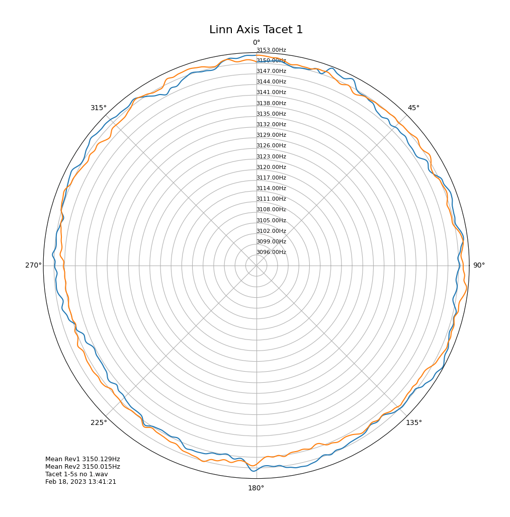

Old motor vs new motor:

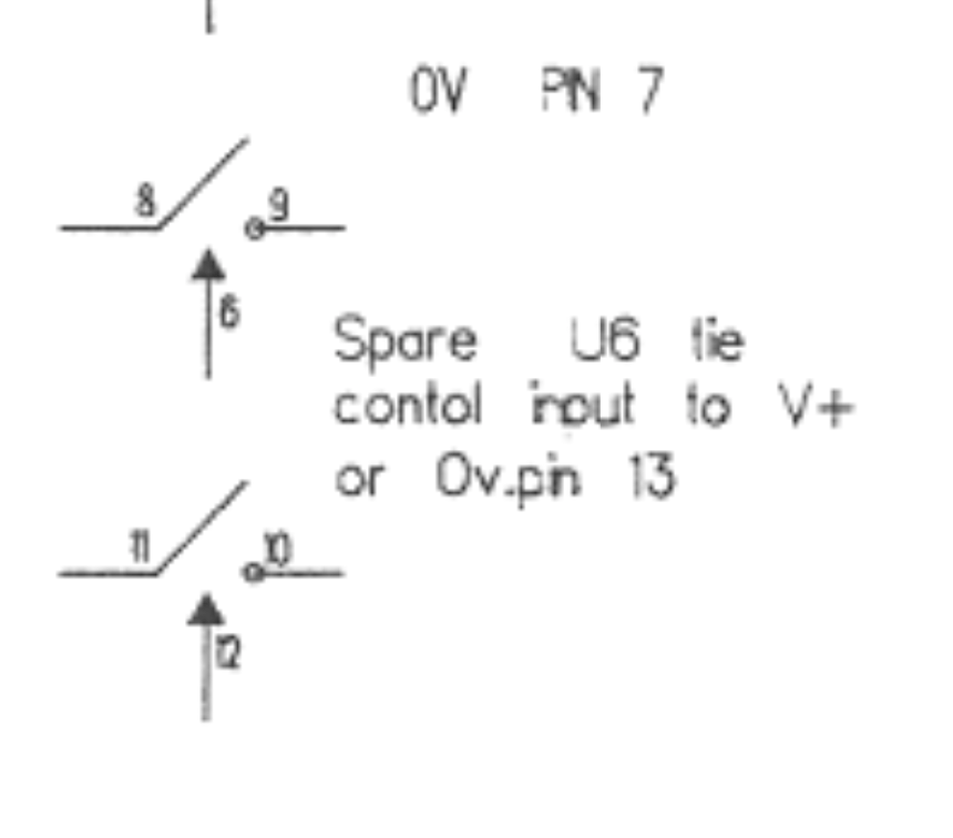

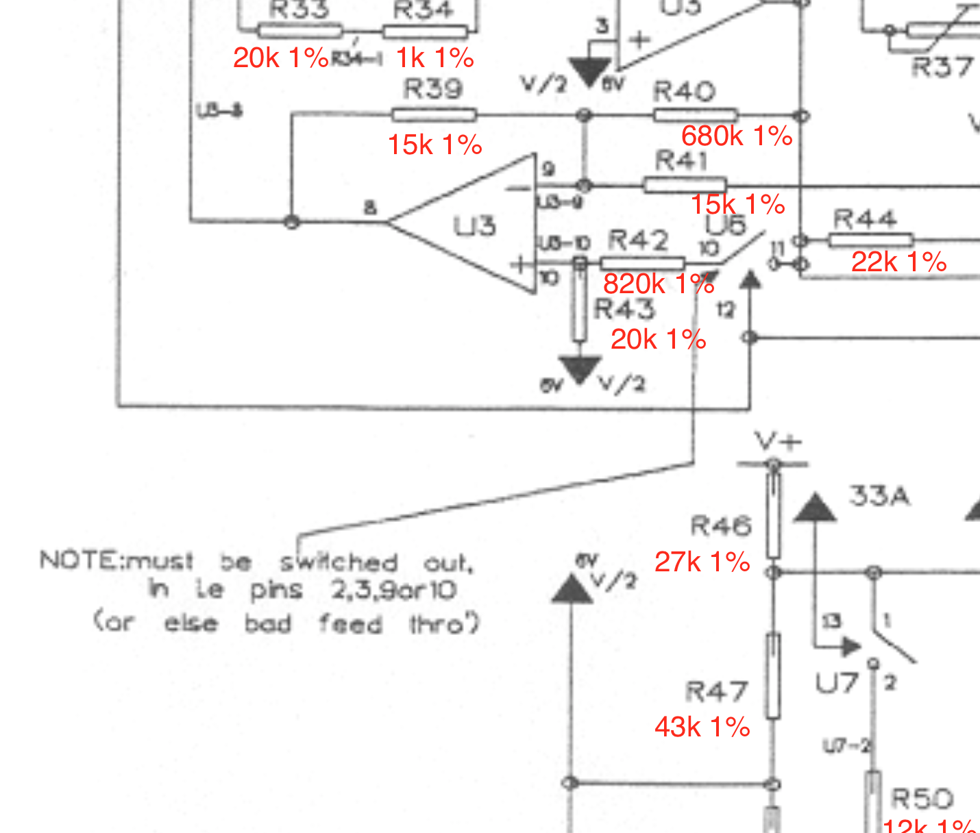

I still have not managed to get it "back in track", even if it works at high voltage when stable. I can set resistors at R50/R51 to lower the voltage, but it is intermittently unstable, with fluctuating drive voltage. I have checked what I can, and I have only two suspicions. Either it is the motor resistor that need change or there is something going on with the U6 or U7 switching. Does anyone know what the "NOTE means for the U6 chip?
