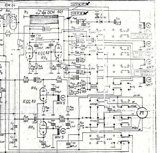

Hi everybody,
First post overhere...found this thread while researching info about my Klemt Echolette S NG51 "Goldcage" from 1962 which im trying to repair at the moment.
Why post that in this thread you might ask...well Klemt was acquired by Dynacord and actually the S62 is very similar to the Klemt. Take off both transformer inputs and you have the Echolette....
The story so far:
Got this Klemt cheap and it is stacked with all the original Telefunken ECC83 Smooth Plates 🙂 So even when not working i have agreat pre amp was my thought, and looking at 2nd hand prices for these kind of tubes...well...a good investment to buy this broken Klemt.
So when it got in by mail i tested it but only the pre amp was working, no echo..did some measurements and first thing that i did was swap the bridge rectifier and smoothing caps, also replaced one of the resistors in the power supply and some very old capacitors...
Turned it back on and yes i could hear the tape now and faintly something is also recorded. But all sound is infected with heavy distortion.
So desoldered the rec heads and only one is within its specs of about 1.1k, the other two are around 3meg so those are busted and will need relapping.
One of the playback heads is also gone and when engaged by the pull up switch on the 'nachhalldauer' only adds hum.
But progress is progress and its working more than it did when i got it...
I get a HF signal on the bias transformer but this is only when the machine is cold. After 5 minutes it just goes flat, no more oscillation. But there is oscillation and that makes me happy and it is good to know the bias transformer isn't dead.
What is happening?
Here are the measurments i have taken with all tubes installed.
Given the follow voltages from the DC mains:
A1= 335V
A2= 252V
A3= 172V
All heaters measure correctly in AC, about 6,4V AC.
Ive measured all pins on the tubes and about some voltages i have my doubts.
On tube 2 im getting a positive voltage of 1V on the grid 2 and cathode 2
On tube 4 im getting postive voltages of 2.7V on grid 1 and about 30V on grid 2.
On tube 5 im reading 10V on both cathodes.
Are these voltages right?

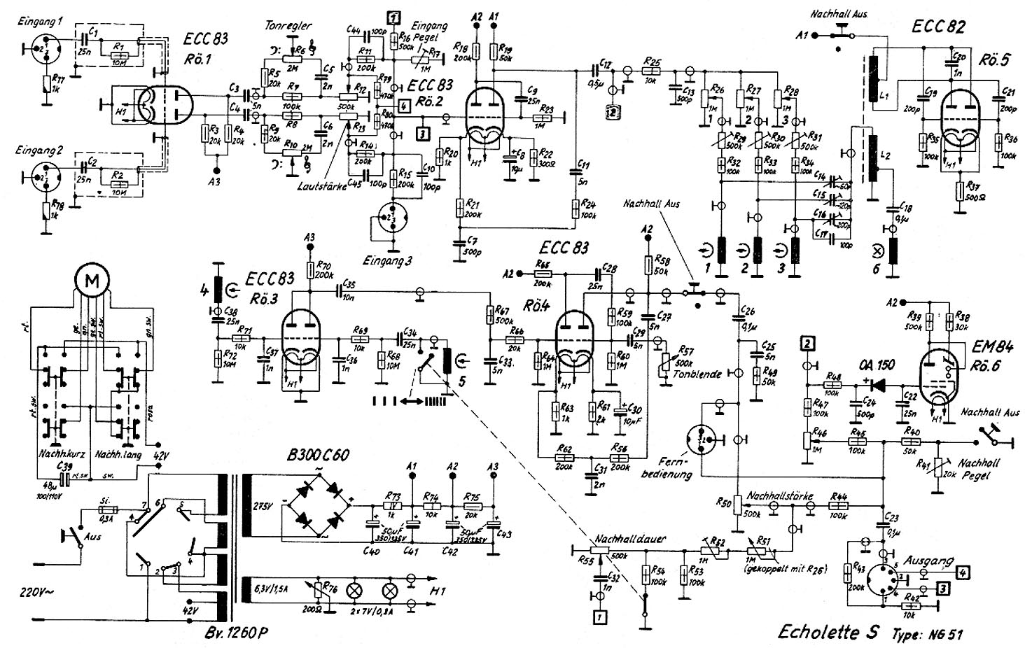

Ive attached the NG51 schematic and reading the tube is pin 1 anode on the left and pin 6 anode on the right.

Yesterday did some more reading and searching and came across the SM for the Echolette E51. Actually this is the same layout as for the NG51 but on the E51 schematic they conviently enough wrote down all the voltages for all tubes and psu!
Just what i needed.
Know i know for sure that my psu dc voltages are correct, that the voltages on the bias tube are correct etc.
I will be sending all of the heads of to JRF Magnetic Head Company in the USA to all be reconditioned.
After the heads come back the bias transformer will have the load that's expected...i think my bias disappears because the two broken heads become saturated after 5 minutes with a to high load...
Anyway this machine will live again....

Sorry,but to me the windings of the respective heads are broken. There's no use in relapping them, which is quite a mechanical process of polishing a head's contact surface. I don't know any shop, IRF included, that will do a head rewinding for you.
Please check the coupling capacitors C9, C28 and C35. Probably they're leaking. 20 mA of plate current in the bias oscillator tube, corrsponding to 10 volts across it's cathode resistor, seems to be ok.
