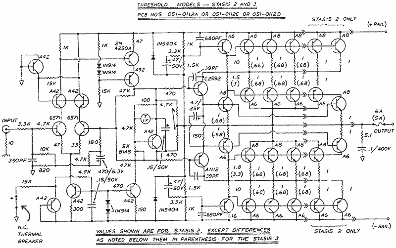

Looks like I'm up next.
While reading the voltage across an emitter resistor in one of my Stasis 2 amps in order to set the bias, the probe slipped and momentarily grounded the emiter leg against one the output-transistor mounting screws. In addition to the 47 ohm 1/4-watt resistor catching fire on the driver board, I suspect I took out one or more, if not all of the output devices on that channel.
Information from this thread will undoubtedly prove useful as I begin to proceed through troubleshooting and restoration procedures.
Thanks all, and I will let you guys know how it comes along. I have a copy of the schematic, and have been inside more that once, but if it looks like I'm going to get too buried, I start a new thread

Hi Forrest,
If even one output is shorted, replace all of them on that channel including drivers. Replace one stage back from your last damaged component. You should match the outputs.
Fresh thermal compound and new insulators go without saying. Try not to over tighten the transistors.
Do not ever use parts from one channel to try in the other. Some guys do this and it is very silly.

Chris, last night between handing out candy to trick-or-treaters, I managed to lift about ten emitter resistors to in order to test some of the output devices. After finding three that were shorted, I figured I would go with what you and others on this thread recommend and replace them all on that channel as well as the drivers.
Within the next few days, I hope to be making a parts list that will include new mica insulators, compound, small transistors, replacement tantalum caps and select resistors for the driver board, in addition to the output and driver devices, and new emitter resistors. I had recently replaced the small electrolytic with Blackgates, but I have a few extras if needed.
Speaking of emitter resistors, the 1-ohm 5% emitter resistors in this unit that I tested actually measured out between 4 and 6 ohms, so I would guess that those too are past their prime.
Now the big question is what output devices should I order? Presently the amp has "A6" (PNP) and "A8" (NPN) shown on the schematic. As mounted in the unit, most of the A6 Motorola devices are marked 8113 CLASSAA6, another A6 is marked 8205 and another is marked 8039. All of the A8 Motorola devices are marked 8113 STASIS NPN. Recommendations on replacements are a welcome.

barchetta said:Sorry I see I said input when I meant output.. just order them all if you can get the same transistors.
I think I'm going to need to replace the input devices as well since the resistor that fried was located in the first stage.

Hi Forrest,
I would buy components made by On Semi if I were you. Their devices have less of a spread than most other brands. Use something current, like MJ21196 (NPN) and MJ21195 (PNP). The compliments will also be closer together for gain.
To get all the devices from the same batch, you may only be guarantied of that if you buy a rail of 25 for each. Otherwise you may get a mix. So you still need to order extra. You may as well match them too. Consider that you are doing a better job (hopefully) than most repair shops and you are saving a substantial amount of money.
Replace the tantalums with new electrolytic types. You can bypass those with 1 uF film caps. Your amp will sound better for this change. Replace all ceramics with mica or polystyrene types. Again, the highs will be much cleaner. I'll bet you will do this to the other channel after hearing the difference.

On Semi it will be. I plan to order extra of everything including enough to re-do the "good" channel in the future. I'm still working on my list for Mouser, but so far, here is what I have for replacements for the outputs, the drivers, and emitter resistors:
Qty. Part # Description
25 MJ15024G ON Semiconductor Transistors Bipolar- Audio TO-3 16A, 250V, 250W NPN
25 MJ15025G ON Semiconductor Transistors Bipolar- Audio TO-3 16A, 250V, 250W PNP
06 MJE15030G ON Semiconductor Transistors Bipolar- Audio TO-220 8A, 150V, 50W NPN
06 MJE15031G ON Semiconductor Transistors Bipolar- Audio TO-220 8A, 150V, 50W PNP
50 CPF31R0000FKE14 Vishay/Dale 3W Flameproof Metal Film Resistors 3watts 1ohms 1%
06 CPF310R000FKE14 Vishay/Dale 3W Flameproof Metal Film Resistors 3watts 10ohms 1%
06 CPF31R5000DKB14 Vishay/Dale 3W Flameproof Metal Film Resistors 3watts 1.5ohms 0.5%
(the following resistor values we not available in Dale
05 283-1.8-RC Xicon 3W 5% Small Metal Oxide Resistors 3watts 1.8ohms 5%
05 283-1.5-RC Xicon 3W 5% Small Metal Oxide Resistors 3watts 1.5ohms 5%
60 4662 Keystone Hardware Mica INSULATOR TO-3
01 120-SA Wakefield Thermal Chemicals SILICON GREASE 4g. - RoHS: COMPLIANT
I'm still working on the remaining devices for the driver board
anatech said:Replace the tantalums with new electrolytic types. You can bypass those with 1 uF film caps. Your amp will sound better for this change. Replace all ceramics with mica or polystyrene types. Again, the highs will be much cleaner. I'll bet you will do this to the other channel after hearing the difference.
I'm looking at the small 0.15uF/35v (actual value in the circuit but the schematic shows 50v) and the 4.7uF/25v tantalum caps. At this point I not sure whether to just go back with those or use something else. I couldn't find an electrolytic replacement for 0.15/35v.

I would use MJ21195 and MJ21196. Newer & better. These parts have better matching.25 MJ15024G ON Semiconductor Transistors Bipolar- Audio TO-3 16A, 250V, 250W NPN
Anything that can be replaced with a film cap should be. So if you can find a film cap to replace an electrolytic or tantalum, do that instead.I couldn't find an electrolytic replacement for 0.15/35v.

06 CCF0733R0GKR36 Vishay/Dale 1/4WATT Metal Film Resistors 1/4WATT 33 OHMS 2% Rated to 1/2Watt
06 CCF0747R0GKR36 Vishay/Dale 1/4WATT Metal Film Resistors 1/4WATT 47 OHMS 2% Rated to 1/2Watt
(replaces short damaged resistors)
I'm ordering extras of everything.
Also, I'm still working on figuring out the caps situation. I need to find film caps that will fit the small space where the radial tantalums are now mounted. The leg spacing seems to be a bit too wide on all that I've found of the correct value so far. I'll keep looking . . .
Hi Forrest,
-Chris
I would rather repair it myself than allow the hacking to continue.Aren't all those old Brystons still under warranty?
Consider axial leaded devices stood on end. Also, look for 5mm lead spacing (Epcos available from Digikey and Newark).I need to find film caps that will fit the small space where the radial tantalums are now mounted.
-Chris
I would just like to say I havent touched this amplifer since I closed it up after its last bias.. in 2007 sometime... still sings.. I even sold my other 400a and kept this one instead as I knew it had all new components in it. Although, I havent fired it up since my last move a few months ago.. but it wasnt dropped.. should be fine.. thanks again all involved in helping me with this repair.. I learned a ton..
