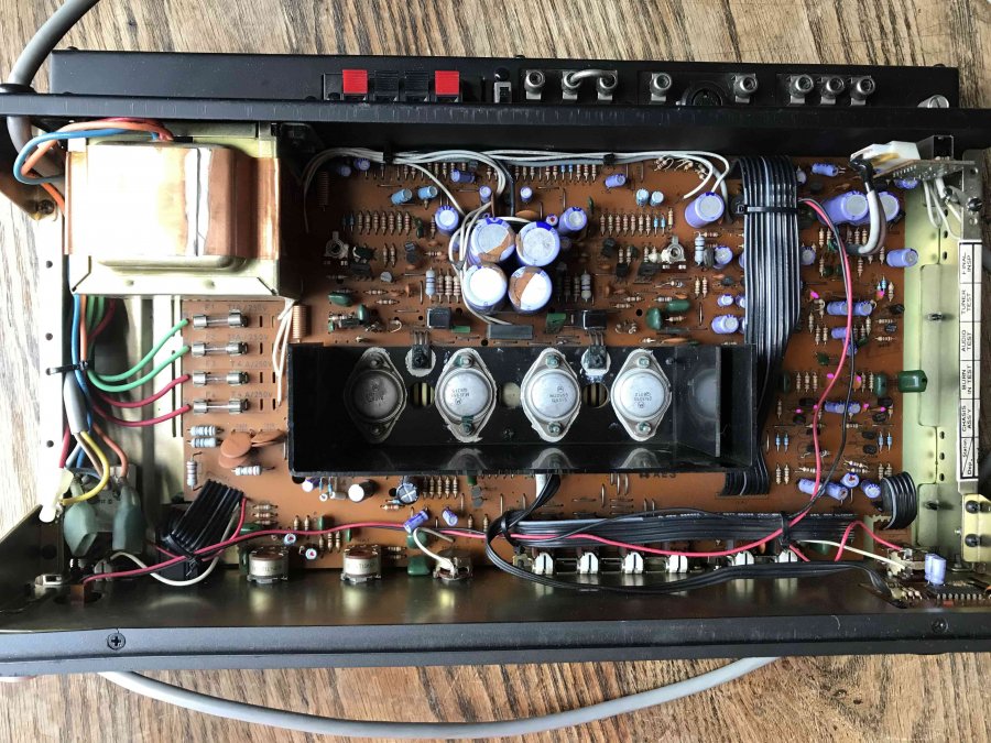

Back to the 400a:
So I have both channels fired up now.. unfortunately it looks like the right meter is broken.. if you recall there is a peek and average for each side.. well the average is flashing like its a really sensitive peek.. so it is very busy.. I guess I will switch the wires around and make sure its not the channel itself.. doubtful I should think.. I will leave this be for another thread.. actually; I thought I might try and tackle this myself.. I think I saw a schematic somewhere.. or maybe Mr. Pass has seen this before and will chime in with a quick analysis.
But; I was really curious how the channels might compare.. with different power transistors and all.. at the moment I cant hear the difference.. and the HF-85 has that cool "reverse" switch on it to reverse the channels.. and I used it quite a bit with nothing noticed from side to side. BTW.. I hear lots of complaints about the large input switch being an issue on this oldies.. mine is perfect.. knock on wood. Boy thats a BIG switch assembly.. must be like 12 switches all on one knob.
Anyway.. on topic.. both channels playing.. just curious.. just wanted to listen before I rebuilt the other side.
And the heat sinks feel equal 20 minutes in.. but an hour in will be the indicator.. I will wait until then; again just out of curiosity.. sounds wonderful even thru the sort of brutal JBL's of old. I forget what they called those tweeters.. but I dont like em'.. they have that shhhh shhh shhh shhh sound too em... I know lots love em'..

Update: its the meter thats malfunctioning.. I swapped the inputs and it stayed on the same side...
There is a schematic at http://www.passlabs.com/np/led disp.tif but I have no idea if the 400a makes use of that concept.
/Hugo
/Hugo
Netlist said:There is a schematic at http://www.passlabs.com/np/led disp.tif but I have no idea if the 400a makes use of that concept.
/Hugo
I knew I saw that somewhere.. thanks I was just looking for that.. gave up, came back here and whalla!
Yeah thats it.. but its the peak side.. my problem is on the average side.. I'm cosuming it now; maybe will offer some hint.. I guess I could start by testing all the caps and resistors then the transistors and then.. well; start replacing IC's.. But since the IC's seem to be drivers for the LED's I am guessing its not them.. something before them.. is my logic logical?
EDIT: On second look maybe it is both peak and avg.. the left and right inputs are confusing me.. I thought they were channel left and right but the meters are different.. so... okay.. I gotta Unglue mine and take a look.. I just glued it back on too.. doggone it. 🙂

Sounds like some caps are going open in the meter circuit. No shocker there.
-Chris
Thanks! I will start checking caps immediately.. awesome... maybe just replace em.. 🙂 THANKS!

"average is flashing like its a really sensitive peek."
Makes me wonder if the right channel blew up at some point and a couple of resistors at the input of the circuit got hot from the DC surge and changed (decreased) resistance.
Otherwise, agreed, the caps are a good bet...
Might be worth checking.

Anatech was correct.. It was a 4.7u cap on the meter board.. I just kept swapping parts until the problem moved to the other channel.. more parts to order :\
