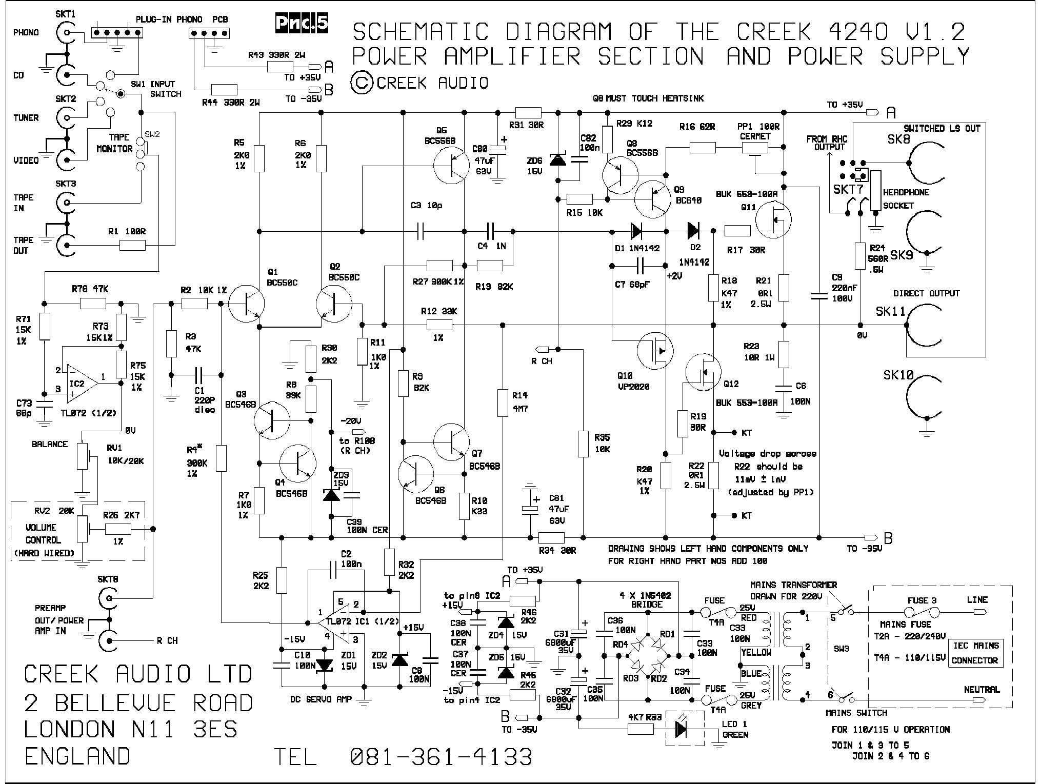

I just bought a Creek 4240 (v1.2 circuit board) on ebay, and it's power supply fuses are blown. I just ordered new ones, but strongly suspect I'll have to replace the output transistors, having gone through this exercise a few times in the past with Creek 4040 amps.
@zacster, any luck? What transistors did you order and from where? I'm waiting to hear back from Creek themselves, in case they sell a replacement kit.
BTW I found a high-res v1.2 schematic which I'm attaching...

Creek don't provide servicing parts or kits but the semis and components are mostly common types, still available cheap from major distributors like Digikey and Mouser. The logic-level BUK553 output mosfets are obsolete though, so the advice from the designer earlier in this thread, for this and several similar models, is to fit IRF540L which is also a logic level type, not the IRF540N which was also mentioned but is a standard type mosfet that requires a much higher offset to its gate drive voltage.

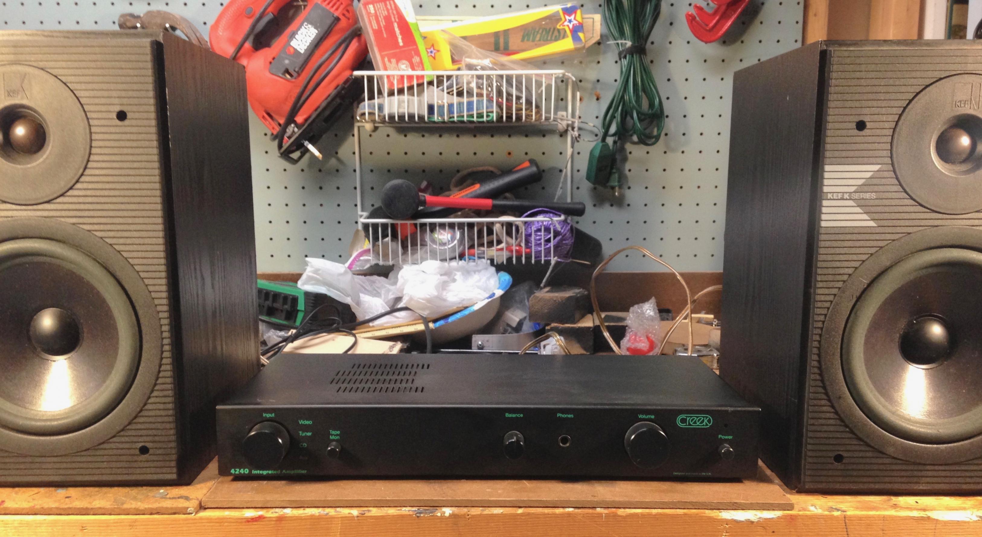

I'm surprised! I replaced the blown PS fuses that came with the amp (incorrectly slow-blow 5 amp) with the correct T3.15 fuses and the amp works perfectly -- even on my workbench and with low-end KEF K120 speakers I hear a nice amount of depth behind the speakers.

The amp using all the zener diodes are same 15v, you can check the schematic in #22 and you can buy zener diode P/N 1N4744A 15v 1w to replace.
keep blowing fuses maybe a short in the output transistors, please check this.

In the ver. 1.2 schematic, it is using a mosfet UP2020, so that ZVP3310 and UP2020 should be compatible.

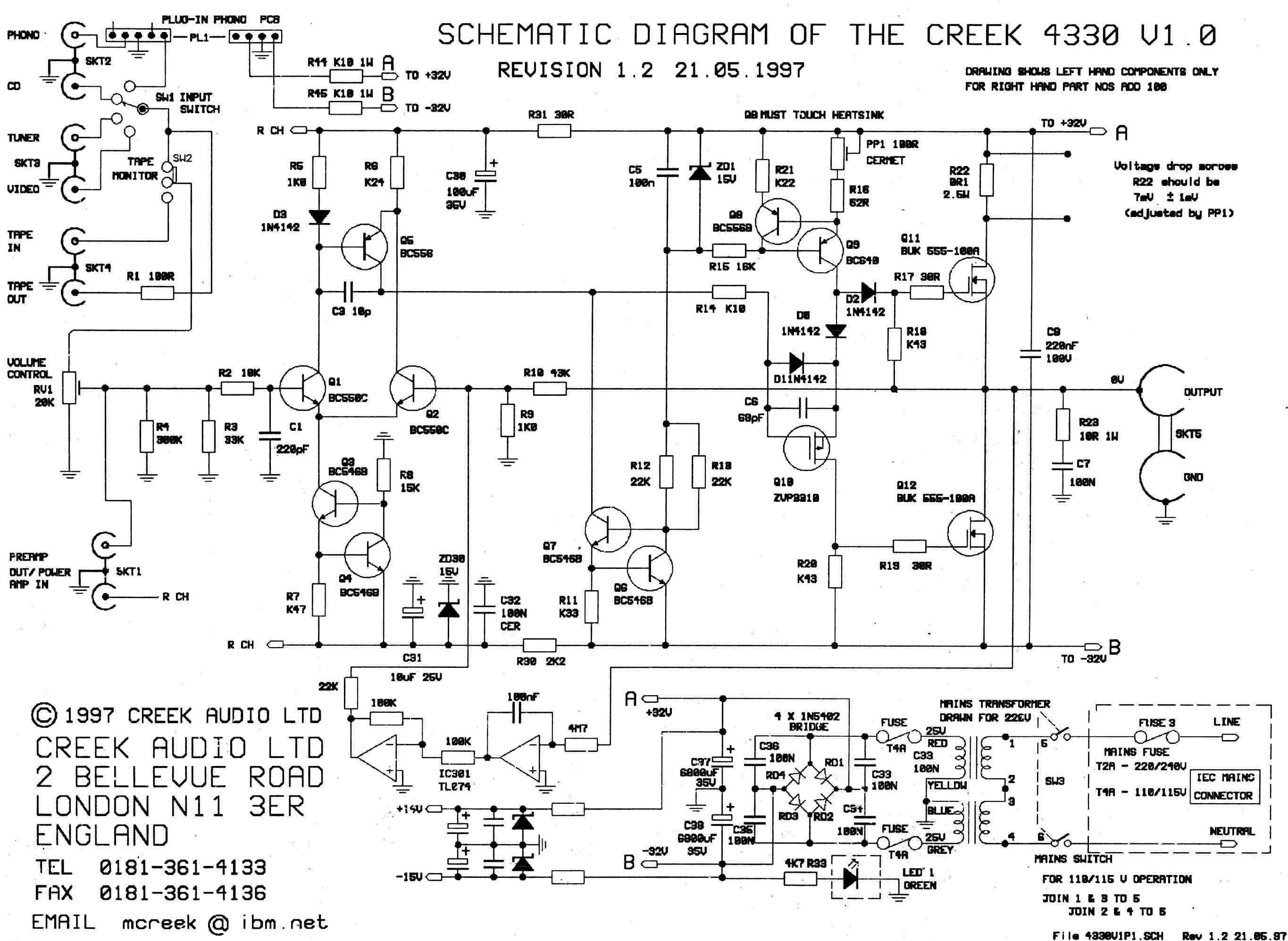

I checked ver. 1.2 and other model 4330 schematic, they are almost same circuit design, I think your amp model mosfet over current caused the problem.
Both schematics said that "Q8 must touch heatsink", when Q8 touched the heatsink, it's Vbe will reduce and decrease the mosfet idle current when heatsink temp raise.
In the model 4330 the idle current reduced to 70mA (7mv resistor voltage), model 4240 idle current is high at 110mA (11mv resistor voltage). I think the designer realize too high idle current will make the amp over current trouble.
Please double check and make sure "Q8 and Q108 must securely touch the heatsink" and reduce the "idling current with a 7mv resistor voltage (70mA)".

A bit of warning...on the diagram on the left, Q18 is marked as VP2020, not UP2020, but the point is that both marks are wrong...there are no VP2020 and UP2020 around, there is only VP2020L but using it is not adequate because it is a low threshold Vgs(th) p-ch M-fet. For Q18, the "normal" threshold Vgs (th) M-fet should be used, in contrast, for output stage low-Vgs (th) M-fets (so-called logic-level M-fets) MUST be used like Fairchild HUF76639P3, Fairchild/IR IRL640 or original Philips BUK555-100A(B), BUK555-200A(B).
So...the diagram on the left probably should have written Supertex VP2210, or the already mentioned Zetex ZVP3310 or Supertex VP2450 or even IRFF9110 (TO39 housing) and IRF9610 (TO220 housing) could be used, but one have to be very careful about pinout.🙂
