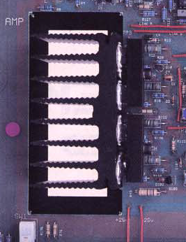

without wanting to sound too funny I'm not familiar with the amp, Id say the big ones mounted on the main heatsink(s)
I just did a search and found an image of the guts of the amp on creeks website Creek Audio's Old Products :
the ones mounted to this heatsink in the image below.. it is very hard to tell from the picture if they are chips or transistors with some sort of heat spreader on them.
edit: ok I looked at the other pdf in the zip file and it says it has mosfet driver and output transistors, so they aint chips

Looks rather similar to 4330 (see attachment). In case you will be replacing the output MOSFETs, note they must be "logic level", e.g. Vgs(th) should 1..2V, not 4V as non-logic-level MOSFETs (such as IRF610) have. The ones used by Creek may not be available, but IRL540 seem to work well in 4330. There is no real replacement for ZVP3310, but those are available.

A few comments:
There was a definite shorting "event" on this amp that probably caused the failure. The thermal compound is a little dry, but not too bad. I will replace it when I replace the FETs.
There are 6 devices mounted to the heat sink. They are divided into left and right channels. 2 for each channel are TO220 package BUK555-100B logic level power FETs. I tried measuring resistance from source to drain and got the following:

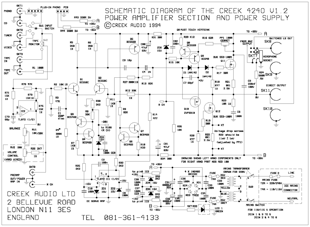

I know this thread is eight months old but I hope some folks are still subscribed. I am working on a 4240 (V1.2) and could use some help. I got a lot out of wutzacircuit's writeup but my problem could be slightly different. My background is in tube amps so I am still feeling my way with units like this.
The symptom with this one is that following a power surge (lightning strike) when turned on the amp immediately produces a steady hum, not affected by the volume control. It sounds like DC on the outputs, and sure enough there is 7 vdc on each speaker out, after running for around 3 sec. I quickly shut it off because the two small 30Ω resistors, R31 and R34 in this 1.0 schematic, begin to smoke. The fuses don't blow, but it is as if these resistors are trying to act like fuses.
I received the amp with the burnt resistors, replaced them and the new set immediately got smoked, so I presume the problem is either up- or downstream form there. Next I removed the fuses (which on this amp are located right after the PT secondary as in the 4330 schematic) and got good 50+ vac from the transformer.
From this description can anyone here suggest any additional tests I can do to pinpoint the problem? I imagine the output transistors will need replacement, but my concern is that, as JoelS points out, something else could be wrong. I do have a variac, so I could apply low voltage but I don't really know what to measure for.

R31/34 are simply isolation resistors for the input and VAS stage of the amplifier. If these are smoking then something in this section is drawing a lot of current. I'd use a bulb or variac to power up the amp, and then check the voltages at the points mentioned on the schematic.
Another suspect here is IC1, the servo opamp. This may well have died. It's worth checking, although R25 and R32 would also be getting hot. If it has died, check the supply voltages - it's possible ZD1 and/or ZD2 are dead.
As the input+VAS are mostly low cost TO-92 parts (Q1-Q7), it might simply be worth shotgun replacing them. Check ZD3 too as it is an important voltage reference for the current sink that feeds the input stage (Q1 and Q2).
The problem with lightning strikes is that they are so destructive, they may well have zapped everything.

Thanks jaycee; big help.
Luckily all those parts are available and cheap, so I can can go ahead and get them all. If I'm reading it right, Q1 - Q7 are for one channel, Q101 - 107 would be for the other channel.
The zeners are not as descriptive. Is 15V all I need to know to get ZD1 - 3?
I am a little unclear on how to check voltages when I have reduced the line voltage via variac. Does the DC voltage drop proportionately so that if I were running, say 25% of normal, my DC should be 8.75 instead of 35? Or am I just looking for any voltage where it should be, and make note of where there is none?

Any appropriate 15V zener diodes should work, yes. The main key will be the casing type. I'd suspect 1.3W zeners so something from the BZX85 series should work. If in doubt try to measure the length of the main body and the diameter.
You make a good point about the voltages. I think before doing voltage testing you'll need to start pulling parts and testing for dead shorts. I'd go for the zeners first, then the transistors. These will need to be pulled to be measured. Resistors should test in circuit ok.

Btw, Luke Creek came through with a schematic. It's the same version 1.0 as above, not the 1.2 that matches my board but I'm hopeful that it will be close enough for these repairs. I do appreciate his response, though; I had emailed the company before finding this very helpful thread.

Well, another 4240 is back in service! It sounds great, too. Thanks, everyone, especially jaycee for steering me in the right direction. I installed all new Q1 - 12 for each side plus IC1 & 2, ZD1-6. And of course new resistors to replace those that were burned out. I also changed out the filter caps, just for good measure.
I had tested it a few times throughout, and got no joy until doing Q1-8 on both channels, then it jumped. As yet I have not tested each individual Q to see if there was one culprit.
I do have a question, though, [FONT=Arial, Helvetica, sans-serif]about a pair of resistors: R27 and the corresponding R127 for the right channel, values for both are 300K. On this amp, both these resistors had been cut out after originally having been installed. They were just gone (save for the little stubs of their leads)! So, my question is were these resistors intentionally removed from the circuit to improve it? Or were they removed maliciously (possibly by the repair shop that quoted this repair but did not wind up getting the work)? The amp had also been in for service once in the 1990s.
As I mentioned, I am more familiar with tube circuits but took this project on for a friend so I am not well versed enough to know the function of R27 & R127. My WAG would be feedback circuit. Incidentally, on the V1.0 schem the value of these resistors is 270K. I had neither on hand but did use 220K, and as I said it sounds really good to my admittedly mid-fi ears.
I appreciate your thoughts here before I button it back up and send it home. Thanks,
