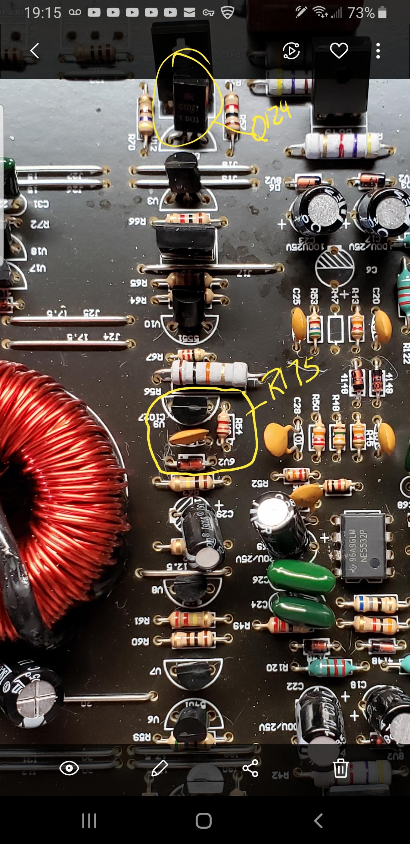

Find the equivalent of R175 on the type 2 diagram. What's the DC voltage across it?
The pulses are not a input frequency, no sir.

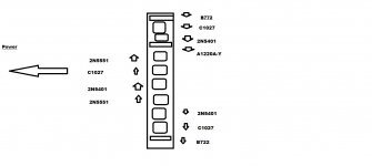

Having a tough time finding a 910 or ? ohm resistor connected to a zener, and them not parallel
There aren't many diodes.

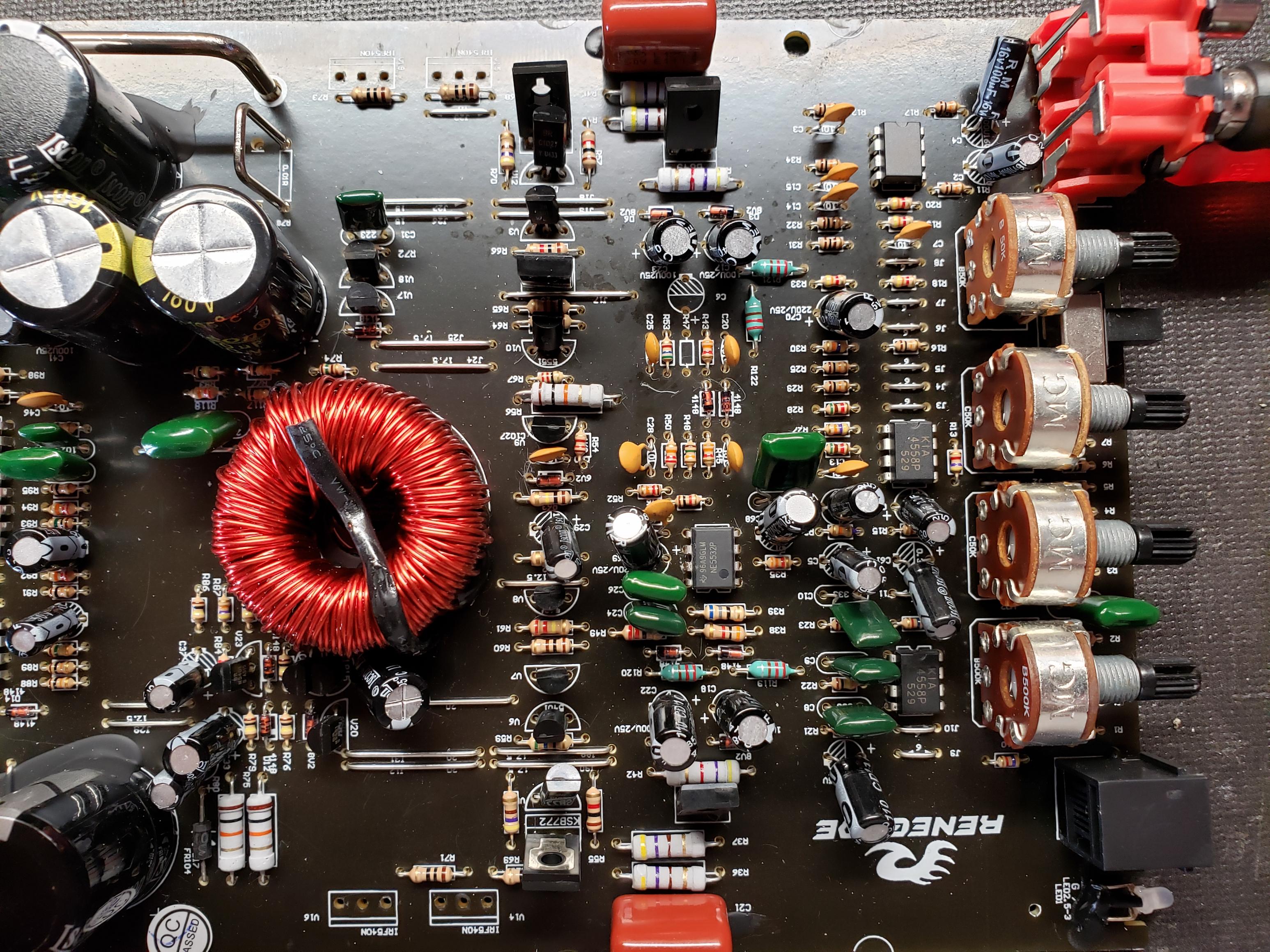

Post a couple of good quality photos of the drive area from various angles.

Are the solder connections on that or any other transistor in the drive circuit heat stressed?
