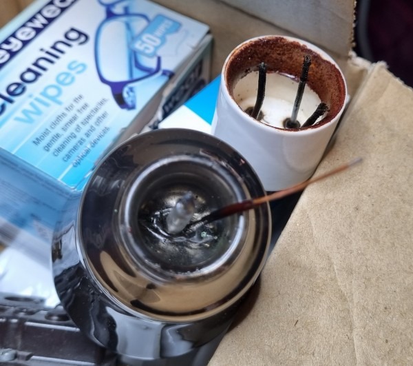

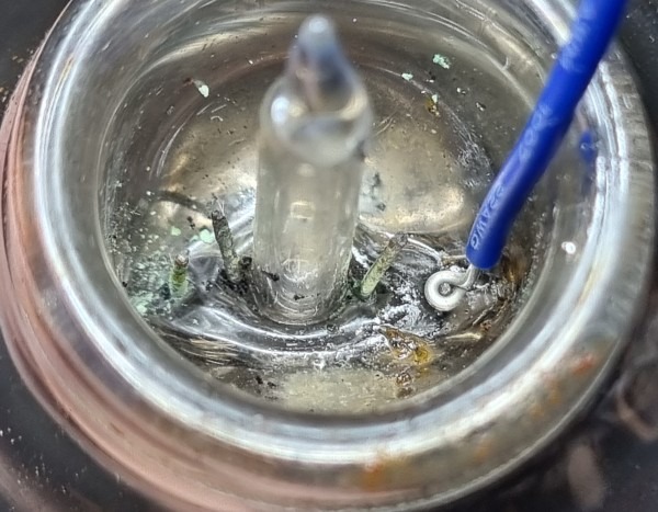

Just thought I'd post an update with my findings... Short summary is that all 4 wires inside had corroded to the point of breakage (even just attempting to resolder the pins on the base was enough to break the filament circuit), the anode wire broke right next to the glass (and confused me for a while), but managed to restore functionality 🙂

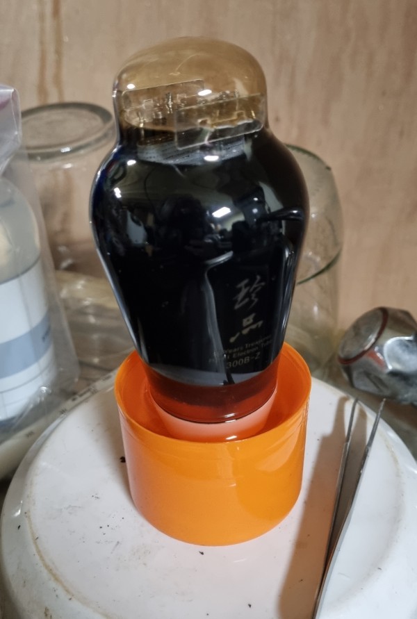

I left the valve in a small cap of the Proton 703 chemical for 24 hours (dissolves various silicone based materials but safe for circuit boards etc so was ok for the gold plated pins, copper etc).

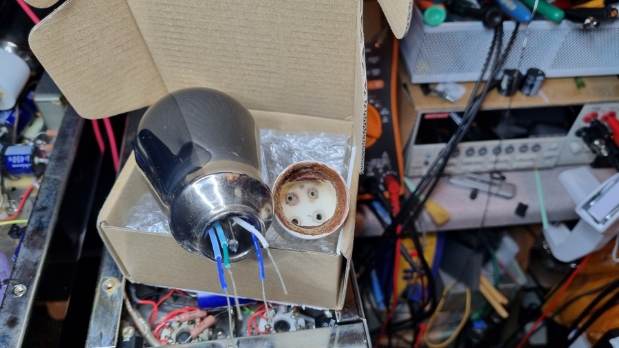

After this and a bit of cleanup with IPA/water mix (Proton 703 has a not unpleasant but very strong smell), a bit of light tappety tapping and gentle manipulation and the base came away practically falling off... wires'n'all 😵 😳🤐
The remains inside were quite heavily corroded, breaking almost all at the same point, but one of them was very close (<1mm or so) from the glass interface, so needed to get a bit creative to make a connection... Although this later turned out to not be the right connection!

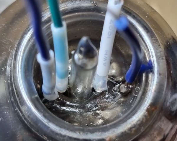

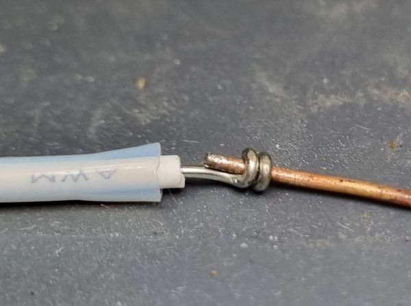

For the other three wires that had about 8mm exposed, a little loop was formed and some ptfe sleeving to help separate (as the loops diameter meant the wires were much closer together):
At this point I found (or so I thought) the filament connections (it wasn't possible to see where they went as the wires fell away, and glass is coated inside) as the outer left and right (the very short one above), as they measured continuity when I probed them. The inner two didn't seem connected to anything so thought grid and anode respectively (this was an error - should have cleaned the wires first!).
I used some citric acid, deoxit and gentle scrubbing with a micro pen diamond grinder to make them wettable to solder and make a good connection (easier said than done when working in a fairly deep cavity with a fragile vacuum evacuation tube in the way), and connected what I had thought was filament (but it was now measuring dead short) to the bench supply. On putting 1.5A through them the only thing that got warm were the leads themselves, so something was off.

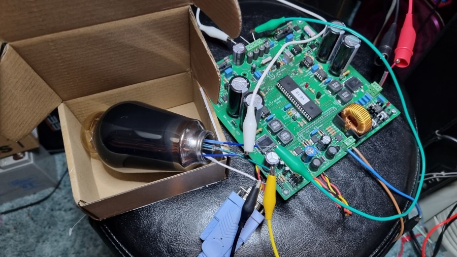

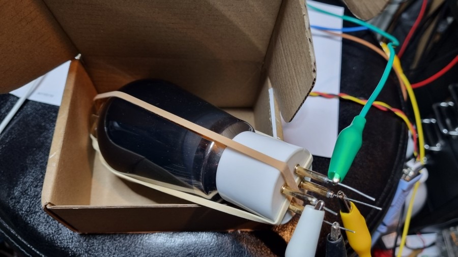

Connecting to bench supply and brought up to 5V and they glowed nicely. Phew.
It took a few attempts and gentle grinding at the remnants of that glimpse of metal at the very edge of the glass (there was only around 0.5mmx1.5mm available), including the glass itself (not sure how thick) in order to get enough of a cleaned surface to solder to and managed to get the anode wire set. I certainly did not want to disturb this again as it was electrically sound but mechanically very weak.

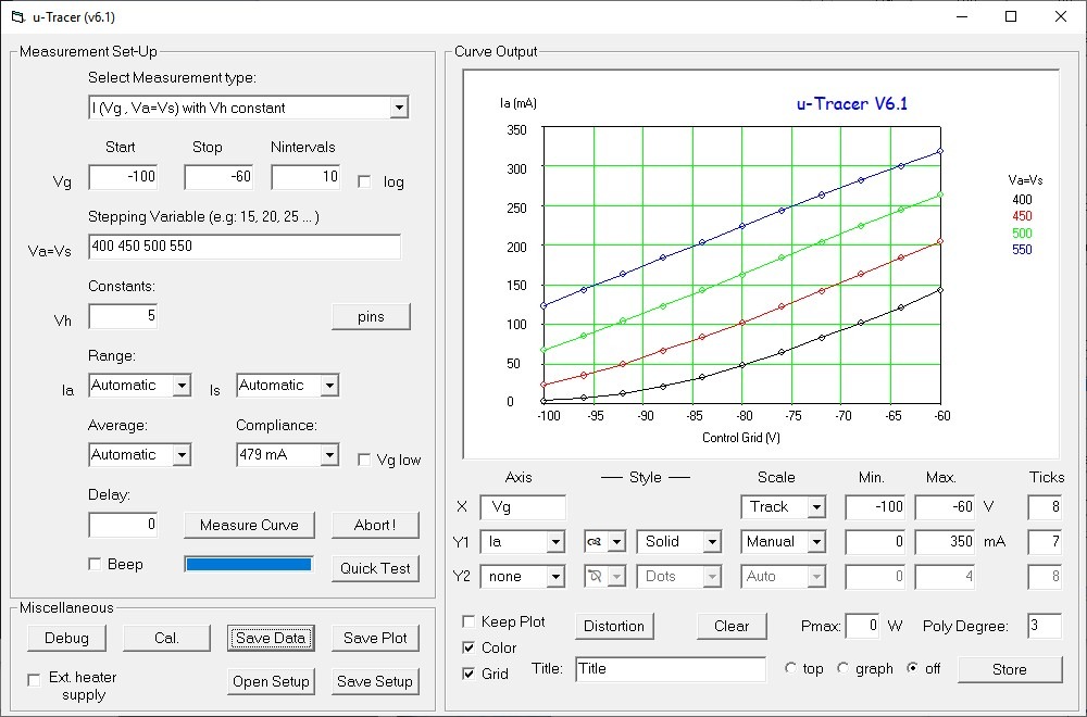

At this point I put on my uTracer and ran a few basic tests, it was alive 😀
Now to clean up the base a bit, and gently put back in place, I used some clear nail varnish diluted with acetone smeared around the existing glue in the base, gently replacing the base in the same position it was in, and dribbled a bit more acetone around, held with a couple of rubber bands . Hopefully this will secure it well enough, time will tell.
Re-ran the uTracer and got a fair result I think :

Just for further info if anyone is interested, below is photo of the anode wire that broke away at the glass (right side portion) - you can see there is a solder connection made (the other 3 wires broke away at this solder point).
Given the verdigris that can be seen I have a feeling that a rather corrosive flux must have been used and not cleaned off during manufacture leading to this issue, exacerbated by the heat involved in operation, drawing in humidity during cooling cycles.
