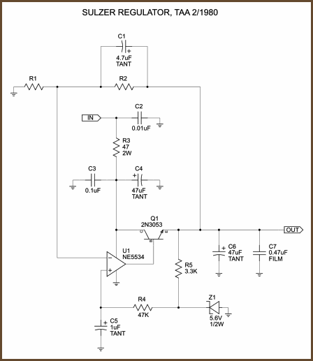

I plan to build a Sulzer low noise power supply next. See attachment

You also may find the link useful. It is for a sulzer regulated PSU for a clock. Look under Marantz SA8260 mods and then 2/3 down the page. Pics and schematic are on the left of the page.
http://www.winebase.com.au/audio/
Richard

In my clock the 12,000µF replaces the 1µF caps.
I have tried all kinds of regulators, including Schulzer and Jung. My feelings are the latter 2 are not suitable for a clock supply, in other words not better than the TL431 scheme I am using in version 7. But of course you can try yourself.
Elso
