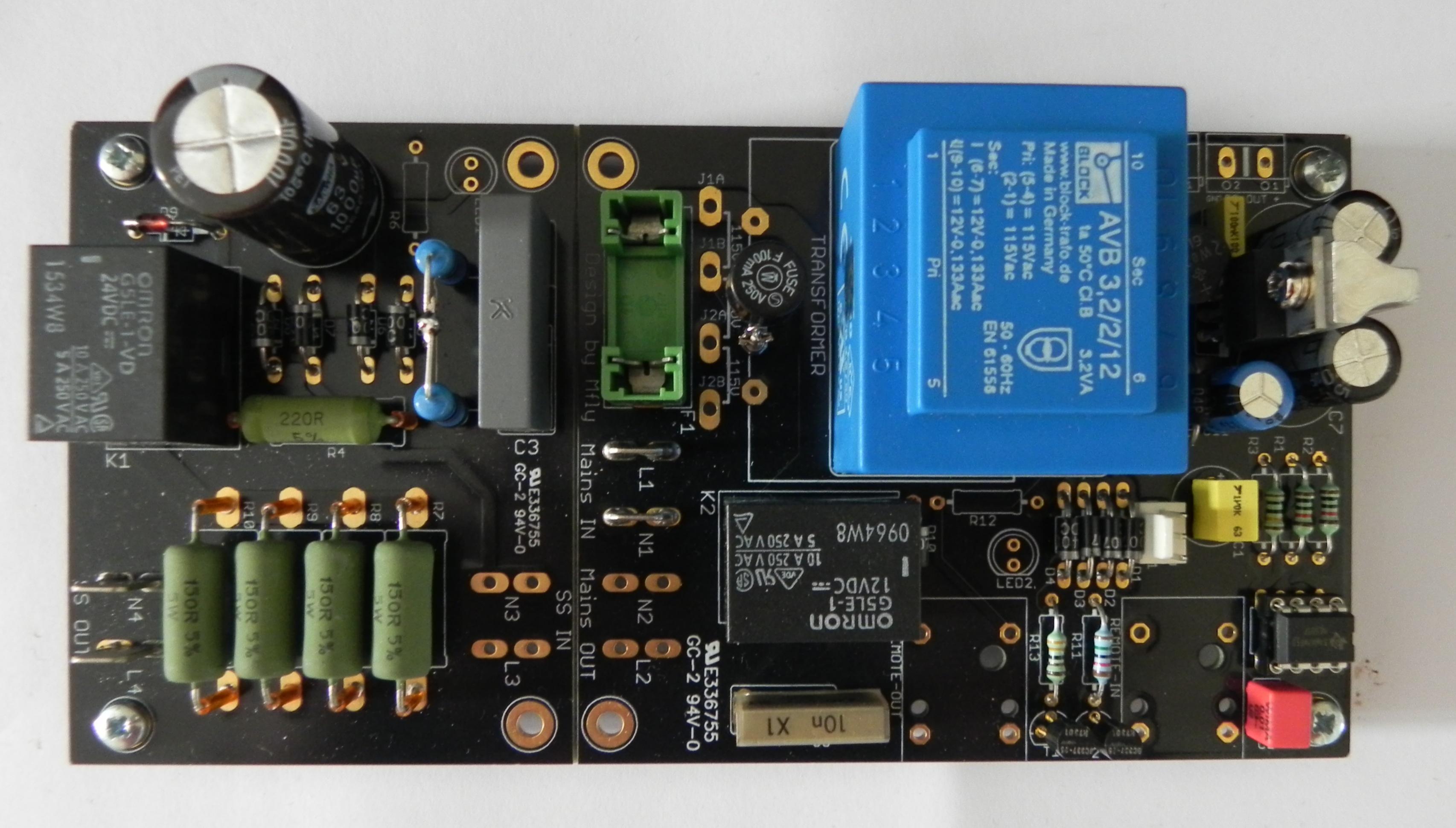

Package received yesterday, beauties!

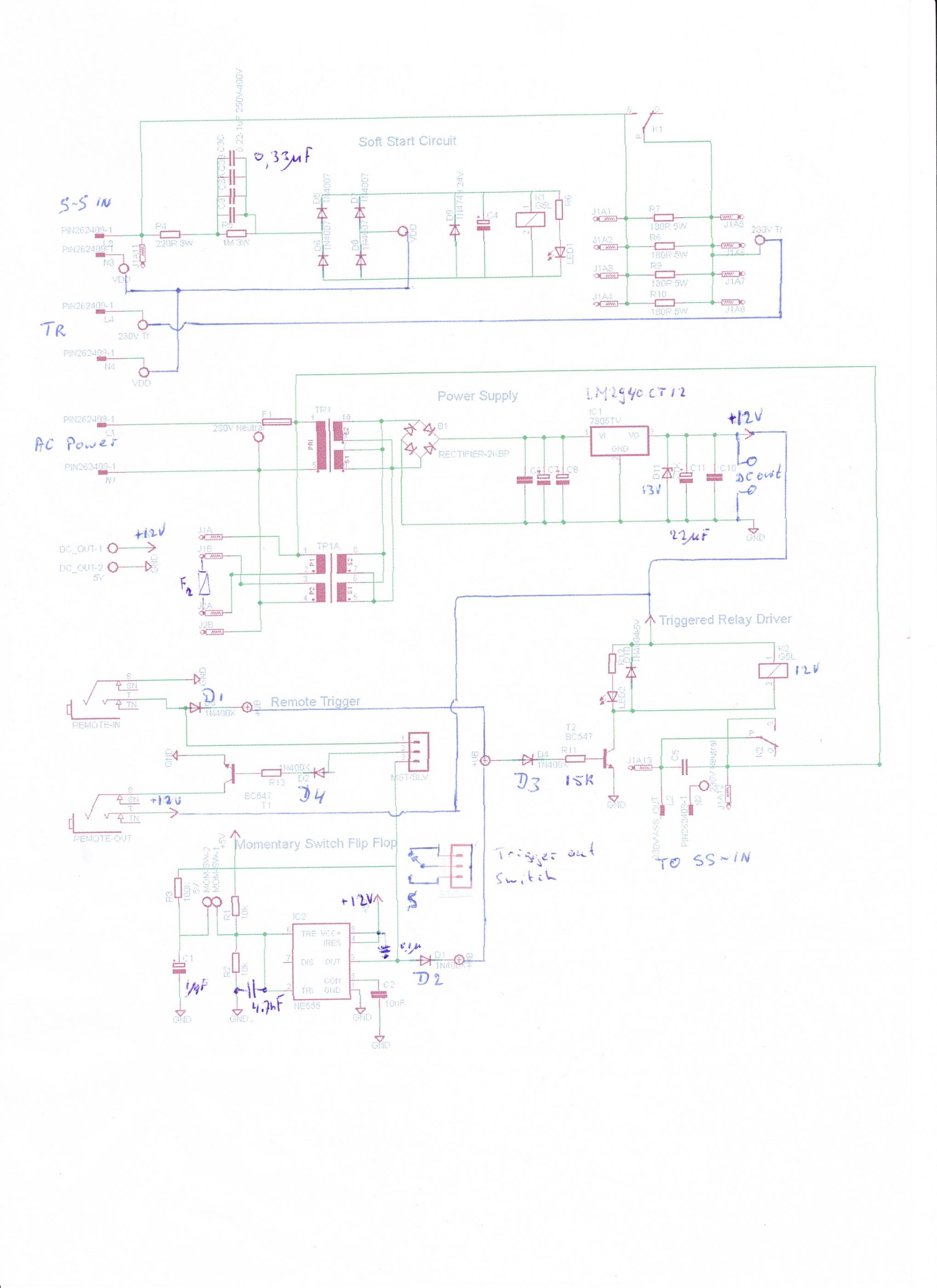

In the BOM C9 has to be C11 i found. .
Also in the schematic D1=D2, D2=D4, D3=D1, D4=D3 compared to the pcb.
Not important but can be handsome...

finished but not connected
Hi ghiglie, i made and tested 2 of them. I found that when i touched the switch contacts the circuit went on and off. I added a 0.1uF over the 555 V+ but didnot help. Then i added a 4.7nF capacitor parallel on R2. This fixed it. I use a low drop regulator and a 12V transformer as you can see in the picture. I also added a second fuse in series with the primary windings for securety. Regards, Loek

Thanks Loek for your schemas and pic! I'll save them for reference. Nice idea about the fuse - if I get to source that easily, I'll take out the bridge. What LDO reg are u using?
LM2940CT12 as in the schema. What do you mean with "take out the bridge"?
Ops, sorry, I noticed it after posting. Tnx! I'll ask you about other mods in PM.
I thought I had to bridge J1A and J2B, right?
