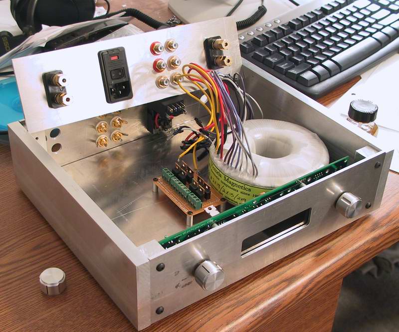

I got my new front and rear panels for my apox kit today. I rearranged the back to make better. I have decided to make a 4" x 5" pcb for the chassis, which will do the input selection, volume control via the pga2310, along with regulation for the +/- 15 and +5 power supplies. It will operate similar to the apox 3, but for input selection, I was thinking about using the analog devices SSM2404 quad CMOS switch for input switching.

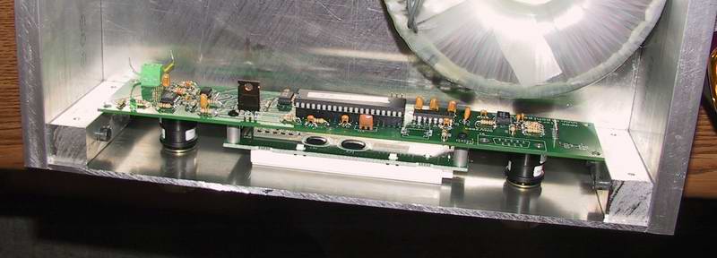

Here is a shot of the board mounted to the front panel. If you are confused as to why the encoders are mounted backwards, it is because Dale was kind enough to provide me with the older revision boards, which had the encoders wired the opposite way. This is my friend's chassis and board setup. I used the latest revision for mine, and spaced them another inch apart, using cables to connect the whole thing together. I made another chassis 14" wide, and will be using the encoders full width apart for it.

As to the audio quality of having a pga2310, microcontroller and gainclone in a small 12"x10"x3" box... I am going to make it work the best that I can in the limited space, but in the end, this project is for my girlfriend, and she isn't very picky.
The goal of this project is to look minimal and fully functional. She didn't want 3 chassis for one unit, as I first planned.

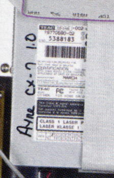

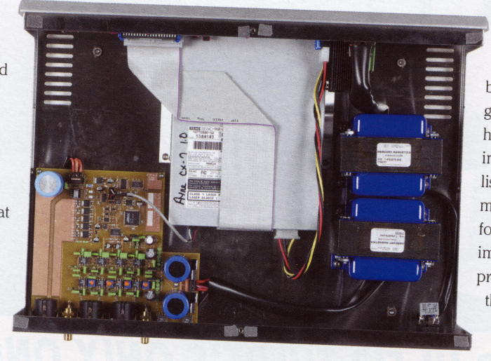

I don't know if it's the same drive, but Ayre is using Teac CD ROM drive in their 3,000 GBP player. I read review in hi fi + and it was very positive. Something definitely worth consideration and cheaper than CD-Pro😉
Vinnie R. said:Hi Dale and Craig,
I know this is also a little off topic, but I was wondering if
you guys would consider making an APOX interface with
a CD-ROM drive, such as this:
http://www.teac.com/DSPD/52XCDROM.htm

If it is good enough for Ayre, and others, Teac must be the one! I can't read the model of the drive in the photo, can anyone?

Here's a better pic of the drive. The Ayre model number is CX-7.

There's nothing really wrong with the SSM2404, but I'm curious about why not use the relays? Is it a simple economy issue?
