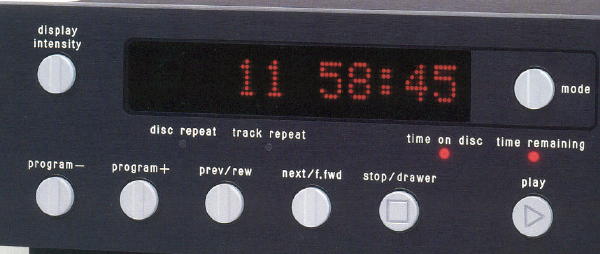

CDPRO2 specifications
Hi everyone,
Since Dale and I have gotten alot of requests for the CDPRO2 remote control with a BIG Display.
Please list some specifications that people would expect on a remote control board.
Do people want a graphic LCD module for cool special effects.
or would you rather have a character LCD module?
Whats the price range people would pay for something like this?
Those LCD modules are pretty expensive?
Would you want the DAC on the same board, or a seperate board?
Is anyone interested in an ethernet connection, so you can control your system from your computer?
-Craig
I would go for character LCD display, with not too many gimmicks as appropriate for high end product. So when in play mode, it should be possible to display just track and time, with a possibility of showing total time/ remaining time on disk/on track. It should be simple and straightforward information. But if somebody wants all the bells and wistles he might be able to program for that, if possible. But I wouldn't go for more than one line, unless in program mode.
DAC shouldn't be on a same board. One, because it's away from transport and output jacks; second, it may pickup interference from dispaly circuits; third, people might go for different options with DAC arrangement, but the display board stays the same.
If it not complicates things much and there is need for ethernet connection, why not, but prsonally, I don't see a need for that.

Peter,
The reason I thought about ethernet.
1.) You could type in track names and CD titles on your computer
and download to the board to display??
2.) Possible high speed download to play MP3 files from you P.C.
(Is MP3 a banned word around here)
3.) Control of your music from a P.C.
For the display. Would you want the same display as on the APOX-IR1?
I am wondering how much code space the control of the CDPRO2 will take up. I could make a very sophisticated type of control with a microcontroller like the Rabbit 3000.
-Craig
Craig,
Sorry to barge in, but you should take a look at the daisy laser site and look at the control sequences and codes. They are not too complex.
I think that Peter has stated that he would like a 1x16 or 1x20 type display. My only concerns are how to display things like repeat modes, track times, etc...
I really think they were looking for a very simple and cheap (but good looking) display/controller (with IR, and some buttons)
Dale
dipchip said:
Peter,
The above features are fine if they don't complicate the display board and increase the overall size. The display you used in IR1 is fine and I wouldn't go for bigger size (maybe even smaller if possible). My main concern here is the width of the board, and this is depandant on type of display being used.
I was thinking about integrating transport and mechanism into a free standing aluminum platform with a maximum thickness of 1 1/2" and footprint of approx. 8" x 10" (maximum, but prefferably less) So the board should be able to fit inside a housing that outside dimentions are 1.5" x 8". The following function buttons should also be required on the board: PLAY, STOP, PREV, NEXT, REFRESH and PAUSE (but not necessarily). The rest of the functions would be controlled from remote. Also provision for display intensity (and on/off) would be nice. Is it possible?
The platform then would be mounted on 3 spikes and the power supply would be in another enclosure. I believe this would be the most convenient and best sounding setup, especially for DIY, since everybody can built and house the supply in their own way. If there was demand, I would make arrangements for producing aluminum platform. This would be one, cool player.😉
