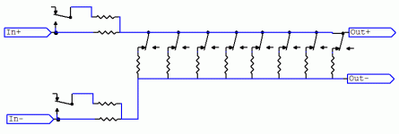

Dale,
A few thoughts, how about
a) Shorting inactive inputs to ground
b) Spacing the outputs from inputs
c) A symetric layout to reduce crosstalk
If you opt for remote control will manual input selection and volume control be available at the same time?

Hi Jam,
All very good ideas.
We have tried to make the layout with concerns for crosstalk.
Shorting inputs would add relays (I think). We are already using DPDT.
There is support to have a buffer in between the input and volume section. For an output buffer, one would just not use the PCB mounts for the outputs and route the outputs to the buffer than to the connections. Do you want a breadboard area?
The front panel interface will work with or without the remote. Infact, in the software, the front panel buttons "spoof" IR commands. I do believe that the rotary encoder will be the FP volume control of choice.

Dale,
I think shorting inactive inputs is important because of bleed-thru from other sources.
Another thought would be phase invert which could be acomplished with another two relays. ( could be an option)

Dale,
I think shorting unused inputs is easy to accomplish. Just reverse the direction of the switch (relay).

Hi Jam,
Call me dense 😕, but I don't understand.
We have n DPDT relays for n inputs (one channel of differential)
The contacts (wipers) are all connected together.
On the pole side, one pole is connected to the signal (+ or -),
The second pole is left open. (like DPST)
We cannot connect anything to the other side. Am I missing something?
Can you draw me a diagram?

Dale,
Connect the wipers to the + and - of the XLR's. On the other two contacts of the relay of the + side, one is connected to ground and the other to the signal bus which goes to the volume control.
Repeat this for the - side as well.

Jam,
Doesn't this actually short the input? Can most sources handle a short? How about a high impedence resistor to ground?

Dale,
Yes it shorts the input, but most equipment like cd players have muting circuits that short their outputs.
Most modern sources don't mind their outputs being shorted I can't think of any that would have a problem.
The idea is to prevent any noise or unwanted signals getting into the preamp. A resistor would work to the degree of attenuating the noise but not eliminating it. ( Maybe an optinon for a resistor or a piece of wire?)

Ok
I guess that I thought there was something else you had in mind. I would have no problem switching the relays around (for the ladder version) and adding a "resistor" to ground. One could leave out, add a shorting wire, or any resistor.
For the P1 version, we would change if there is another reason to modify the prototype board.
Thanks for the suggestion and sorry for the mis-understanding (actually I just didn't realize that one could short the outputs)

APOX-1 volume control
Hi everyone, I'm Craig, Dale's partner in this Remote Volume control extravaganza. We've been compiling all of your suggestions and I put the stepped ladder relay board on hold to incorporate all of your good ideas. (The new layout is almost done so please be patient.)
The new features are as follows:
There are now 8 differential input selections. (I know this is overkill, but some people insisted, and you don't have to load the extra relays if they are not needed) But you'd also be kicking yourself, if you decided to add another piece of equipment to your system, and didn't have enough inputs.
There are 8 XLR connectors directly on the board for the
first 4 differential inputs. The other 8 connectors are implemented
as 5.08mm connectors that people could hardwire to an upper row of additional connectors.
I also added another set of output connectors (L and R) internal to the board, so once again, people can hard wire an upper level if needed.
After some painful modification, I have turned around the relays on the input select lines. The second pole now has a resistor to GND to either short the inputs to ground(using a jumper) or load them down (with a resistor) or let it float(your choice).
Dale is pretty far along on the software, and we have most of the parts for the first prototype in.
I'm getting excited for the first prototype build. It should look pretty awesome with the Blue LCD display.
I must get back to the board layout now.

May I strongly suggest
This is great!
However, I would suggest that the relay setup is changed from shorting each line to ground to shorting each line to each other. I have attached a schematic to indicate what I mean.
Also, have you considered using delay or other option to ensure that the lower bit relays do not "chatter"? My suggestion is to have .5 to 1 second or thereabouts delay on the lowest 4 or so bits, perhaps half that on the next 2

This is great!
Also, have you considered putting diodes on the boards to accommodate relays that do not have these built-in (to sink the inductive energy at shitchoff)?
Also, may I suggest that the relays are set up in passive shorthing mode so that if power is lost, volume is set to zero by action of attenuation.
Also, may I suggest that you add 1-2 serial relays to set up potential for better sound at all levels. As it is, most volume controls sound worse the lower the volume setting. This can be fixed by allowing for a change of series load resistance.
Petter
