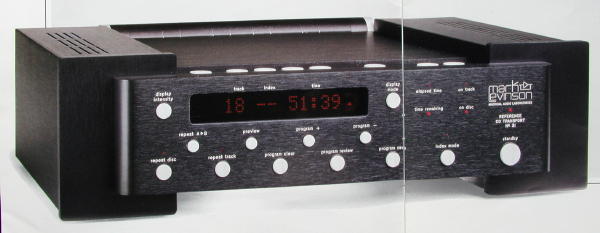

Re: New Ideas Please!
If this is possible, there would be definitely a demand for a nice control board for CD-Pro 2. The board that comes with a transport is basic, with only few controls and the dimentions are not really convenient. Dispaly also isn't that great.
Something like ML for instance.
dipchip said:
Does anyone on this forum have a need for any particular board?
I'd like to get a bunch of ideas, and figure out the next step.
