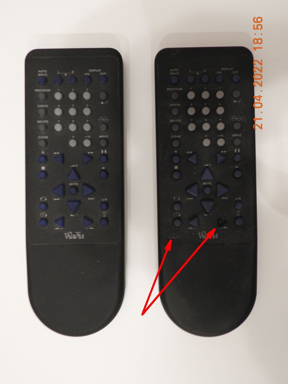

I have only worked on a hundred or so of them but these Wadia metal remotes have me scratching my head as far as opening them.
The only thing I can think of, is to peel the sticker with button names and symbols, hoping for access to some hidden screws and the board underneath.
One on the left barely works and needs cleaning. The one on the right works fine, but has been attacked by a dog (see bite marks)
Anyone has experience with opening of these?

The issue is often that the batteries holder are damaged (plastic at the ends off) even after transport.
Also contact issues after time, to turn some batteries and than ok again.
Have one with dual LED... but needs a LED with 5meters support, so I am still looking for a valuable replacement part / brand
Press the top plastic with fingers, you might find a gap in what is supporting it.....
Peel off gently, get to gap and metal screws should be there.
Some super costly remotes were machined from solid, with the top cover sticker covering the top metal sheet, and a metal battery cover, those had a screw, as snap fit is difficult to do in aluminum.

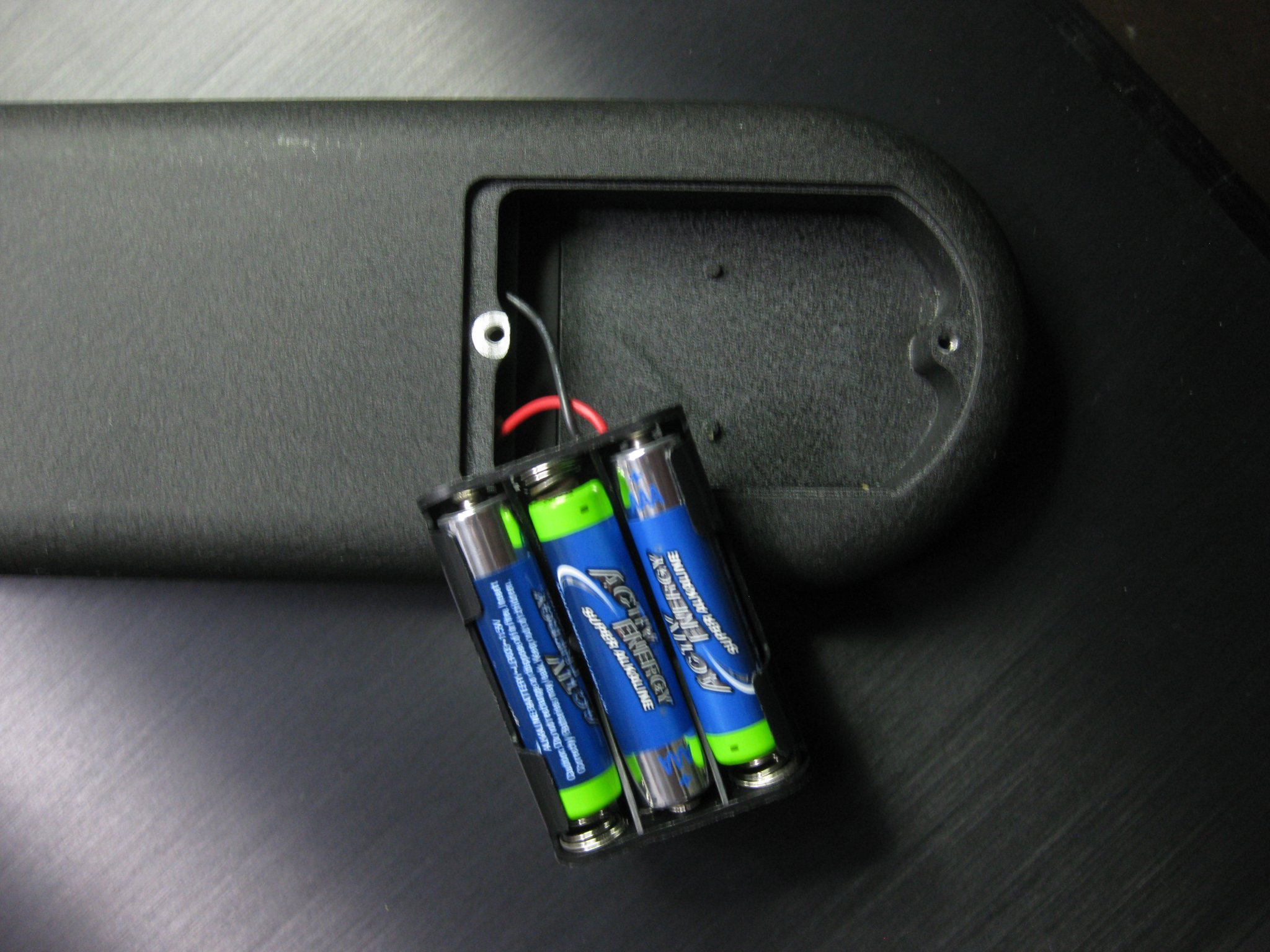

I have a 860 CD player, where the ALU remote control box has to be opened and containing 6 batteries, 3 on each side.
The older 27DAC remote control box is equal and has 2 LED's.
Replaced with dark blue LED, but they are to short beaming... 5m is required with given/required diameter.
