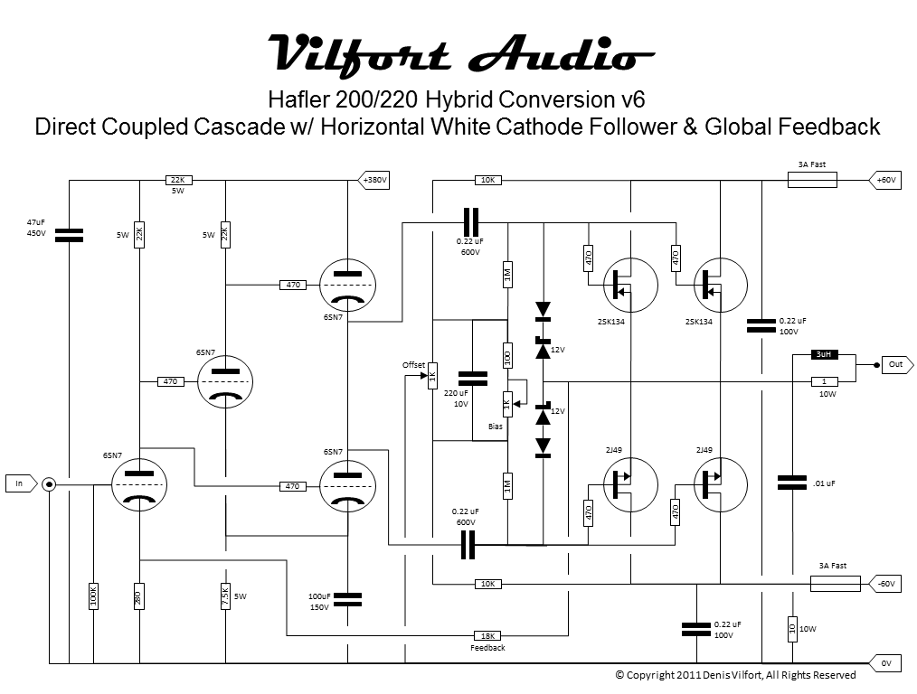

I have been refining the circuit a bit and changed values of some of the resistors. Broskie published a great article on the white cathode follower here: The Tube CAD Journal, August 1999 pg 1 In it (see page 4) he concludes that the plate load resistor of the top tube in the white cathode follower circuit should be Ra = rp/mu.
That seemed easy enough for the 6SN7 http://www.hifitubes.nl/weblog/wp-content/tung-sol-6sn7.pdf : 7,700/20 = 385 ohm. So a 390 ohm resistor would do nicely. To balance the circuit ala Aikido, I went for 390 ohm on the cathode of the bottom triode as well.
I have attached the updated schematic. Works like a charm and sounds very good too. Lots of detail. I now hear layers of instruments I newer heard before... With a DH500 you would have lots of power too.

The value of Ra for white cathode follower depends on what load is the white cathode follower driving. At Tube CAD Journal you can find this formula for Ra: "Ra = (rp + 2RL)/mu"

Actually I think this circuit would sound alot better when operated in class A. I have my doubts about performance of class AB open-loop stage with just two parallel mosfets.
Improved Tube/MOSFET circuit
This post was a little older. The evolution of this amp eventually led to using a bit of (oh no!) global feedback. As you can see from the schematic, this is now a modified white cathode follower running in class A. The power bandwitdh goes to 200Khz with a single pair of MOSFETS and to 60KHz with 3 pair.

While Broskie did "prove" the Ra = rp/mu, he seems to have ignored it in some of his subsequent circuits, something I found a bit odd. No question, the guy is a genius, and I'm sure we're all grateful for his shared insights.
I wonder about a few options, the choices you made and what sonic differences you may have heard if you played with different voltage gain circuits. Specifically, the 6SL7 in current source loaded form, did you try any other tubes here? The gain is very high and so is Cg-p, so I wondered about HF rolloff. I thought perhaps another tube, even with a cascode depletion MOSFET CCS might serve well. In the White Follower, while the 6SN7 is a very fine sounding tube, I wondered why you chose it over something like a higher gm, higher current tube such as a 6H30 or ECC99. Either of those would seem to provide more drive to overcome the input capacitance of the MOSFETs. That's something very much on my mind with 3 pair to drive.
In the output stage, I noticed no additional capacitance to equalize the n-channel and p-channel devices. SS is not my forte, so please forgive my ignorance, if such equalization is not needed in your circuit.

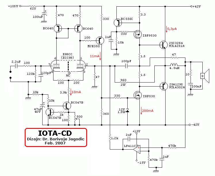

I was referring to circuit in post #72. To make the output run in class A mode, you need to raise the idle bias to cca 1A - 1.5A. Obviously, this will generate lots of heat and demands better PSU for lower ripple.
If you are interested in hybrid circuit I recommend you this one.
http://www.diyaudio.com/forums/solid-state/195351-80w-hybrid-audio-amplifier.html
http://bas.elitesecurity.org/IOTA-CD.html

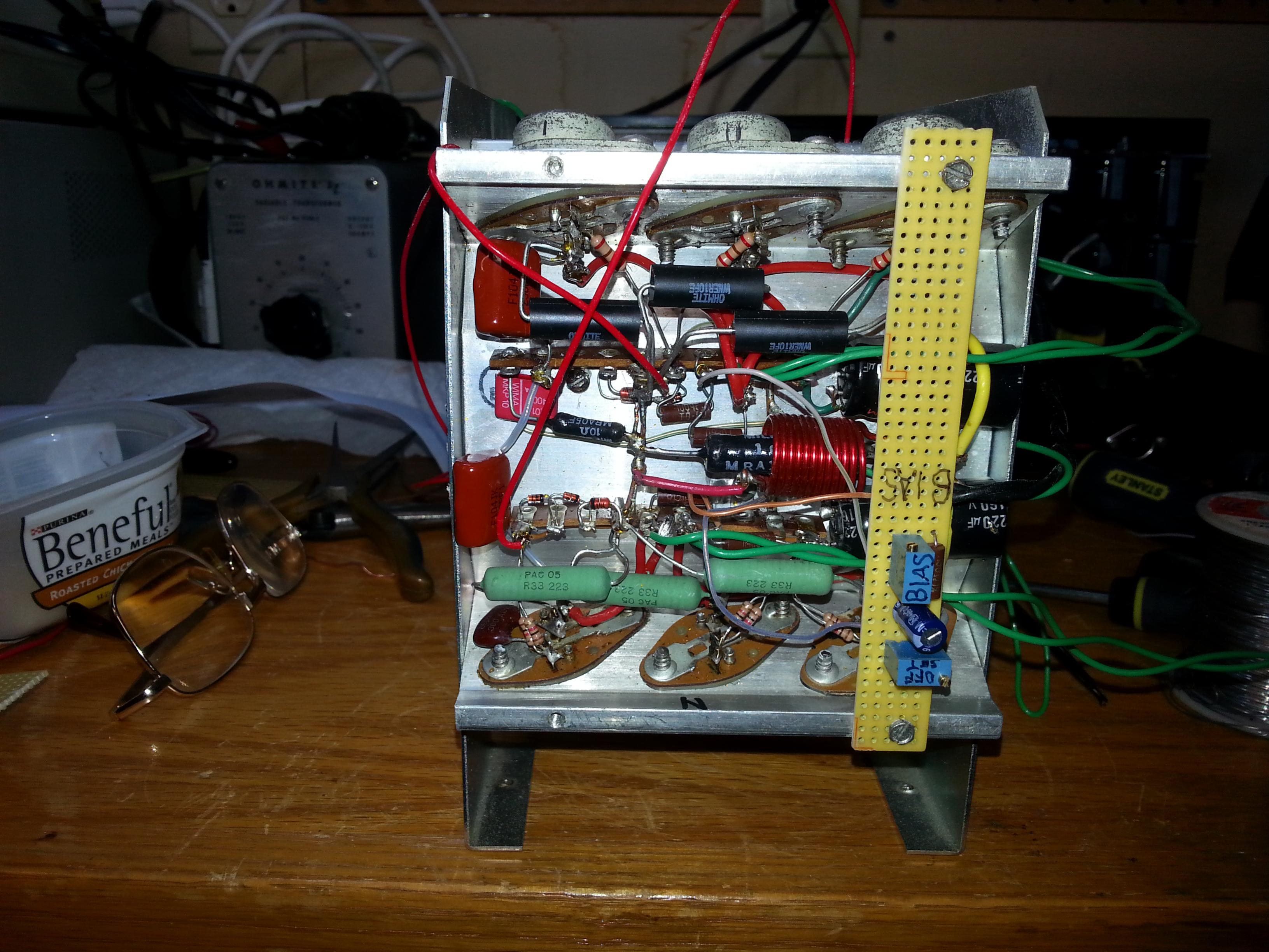

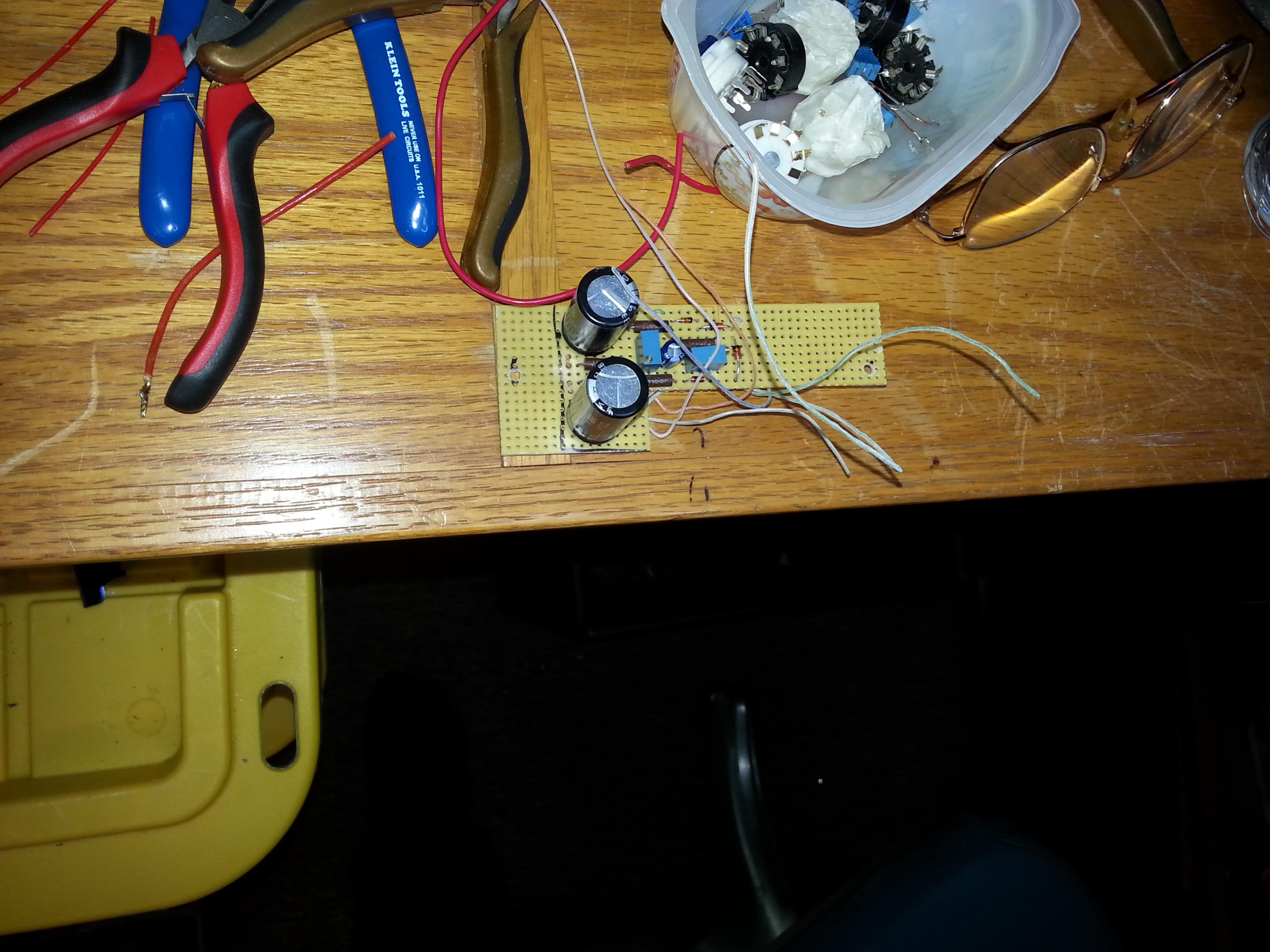

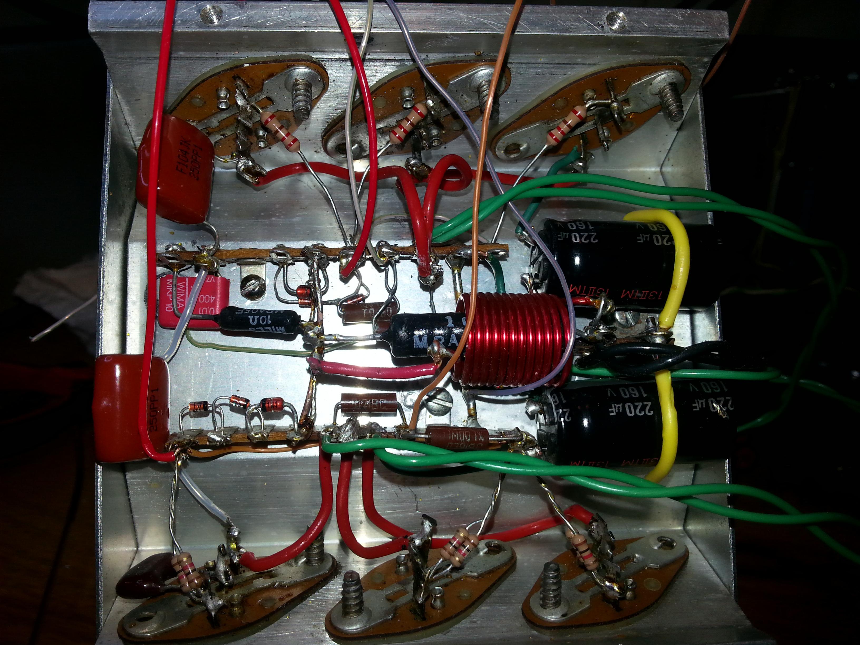

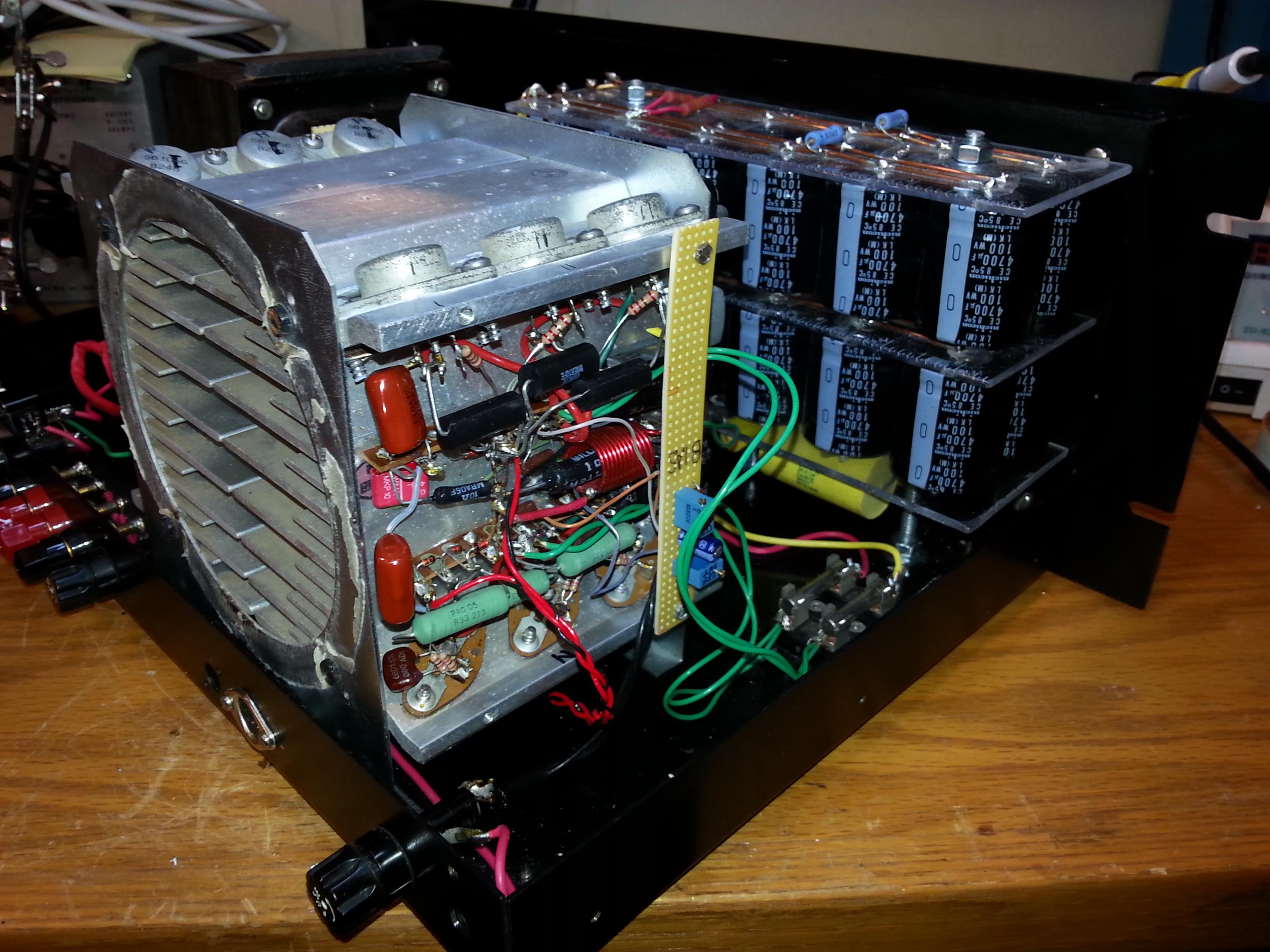

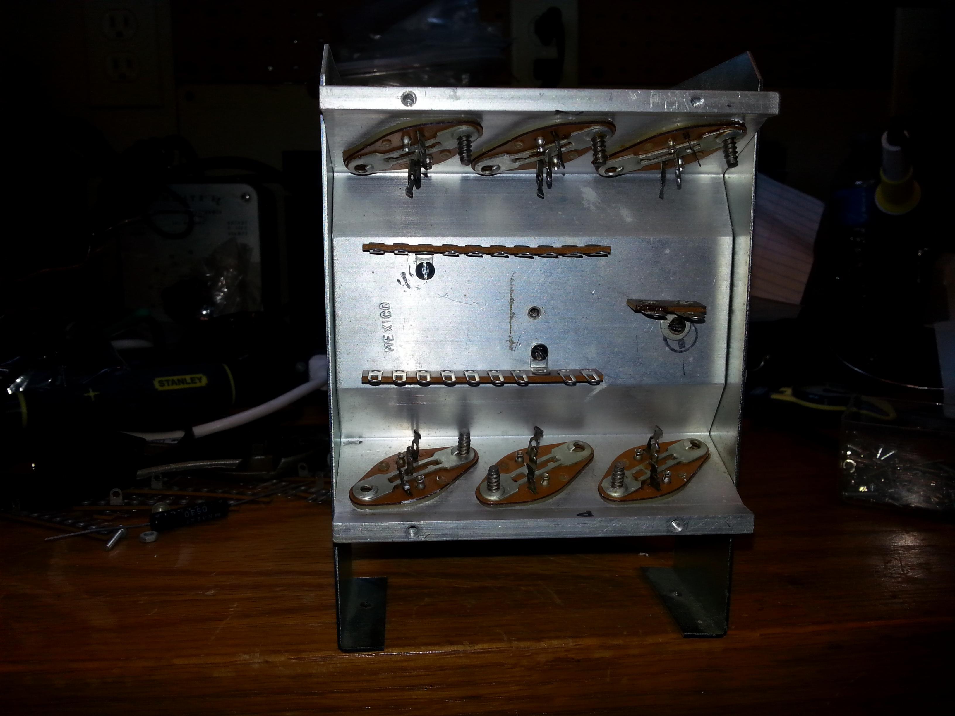

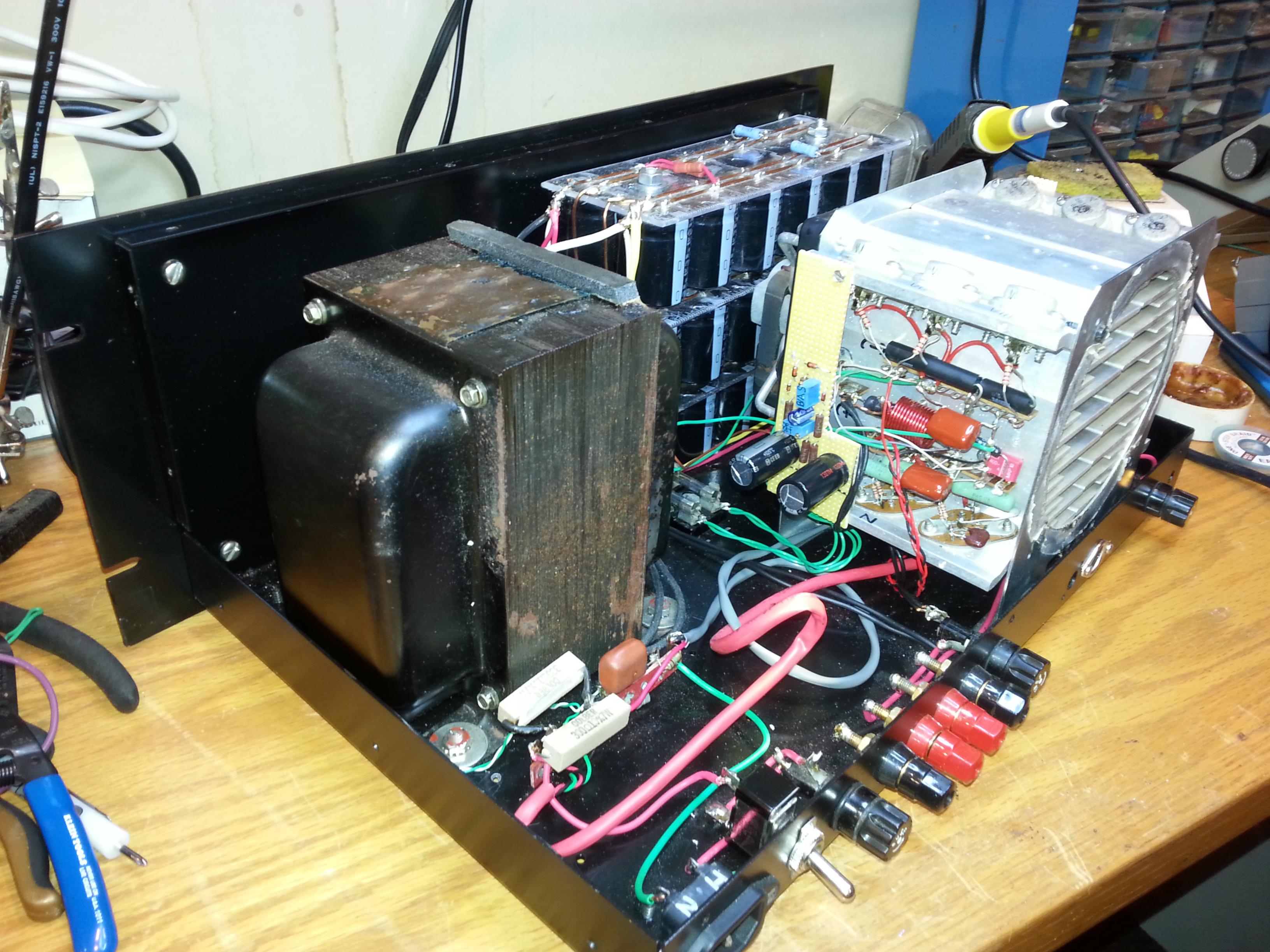

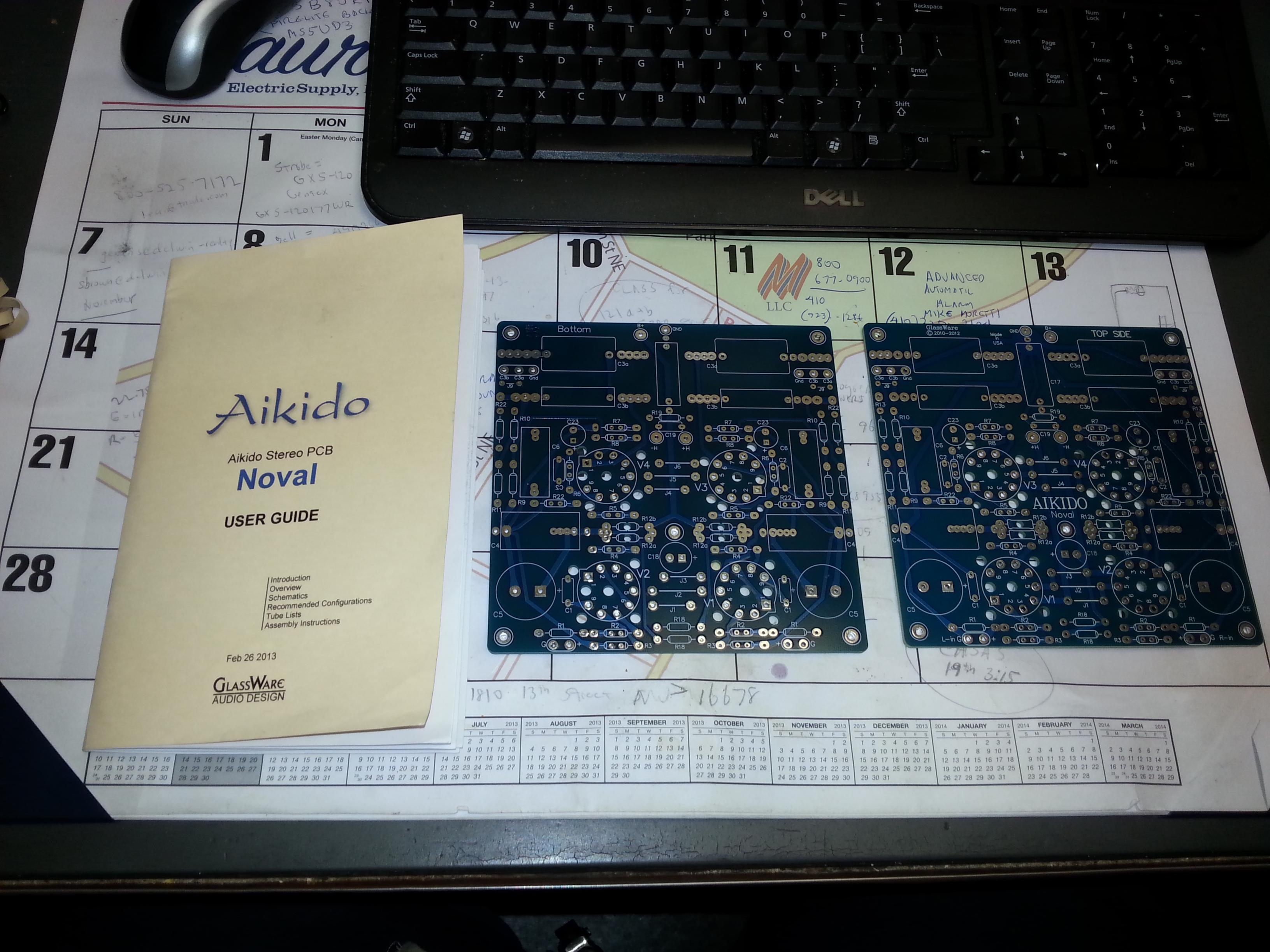

Wow, it's been a long time. Life changes forced me to pay attention to other things, but yes, I did get this off of the ground.
The design ended up being a multi-chassis solution. Two DH500's equipped with DIN connectors for inputs, Two Aikido chassis and one Aikido power supply chassis.
The Aikido chassis are made, one almost complete. Haven't yet started the power supply chassis stuffing, although the chassis is built (wood frames with plastic tops.
One DH500 is complete. It is an output stage and power supply only now.
Pictures and schematic attached. I hope it works!
I'll post more of this come spring, when I hope to get back to it.
Stuart

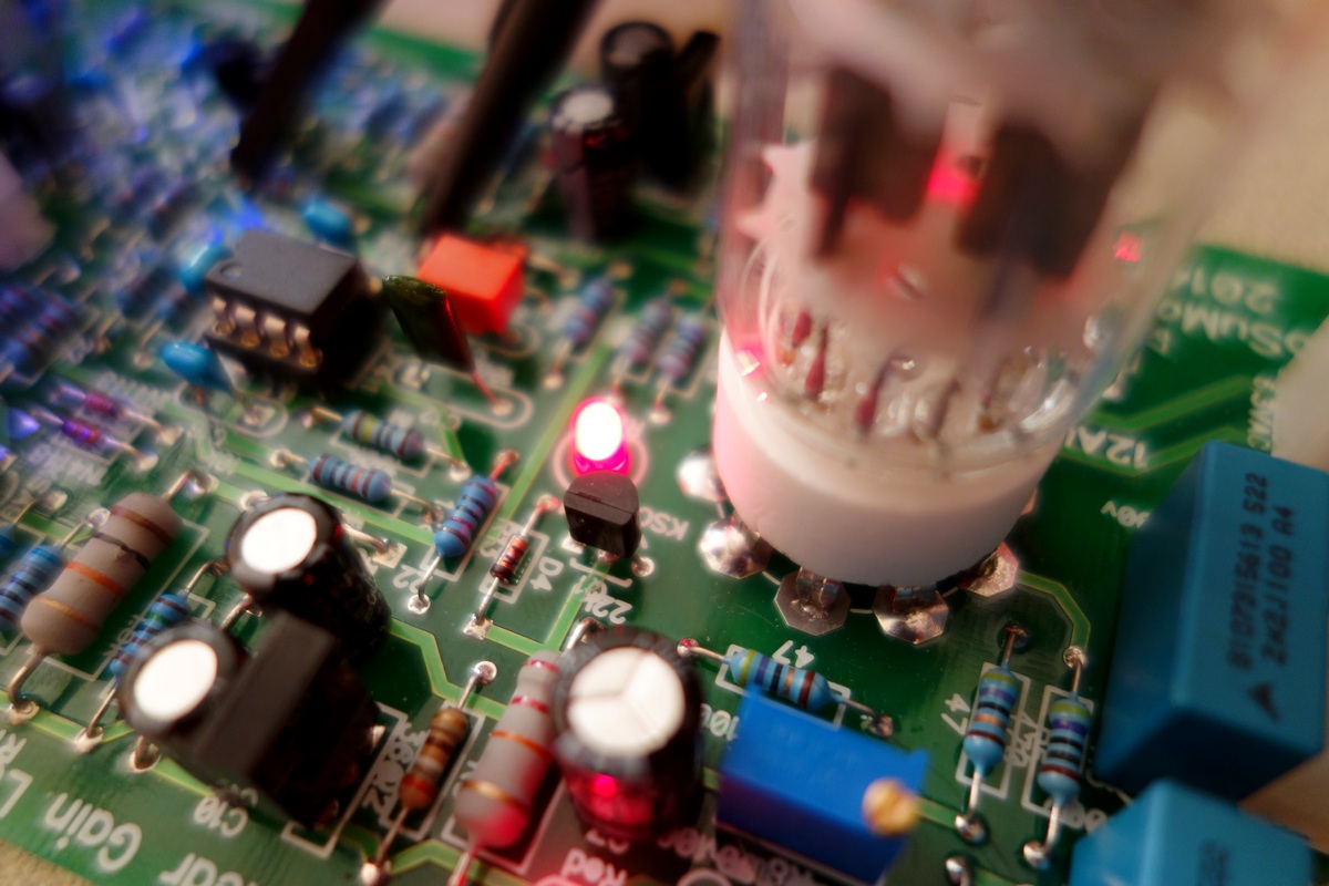

If somebody is interested, see this post for the final schematics / measurements:
TubSuMo as built
Gerbers, PCBs are available. There is even one set fully assembled / tested IPS + OPS boards for sale (2 channels set) 😉
Great sounding amp! Let me know if you will have questions.
TubSuMo as built
