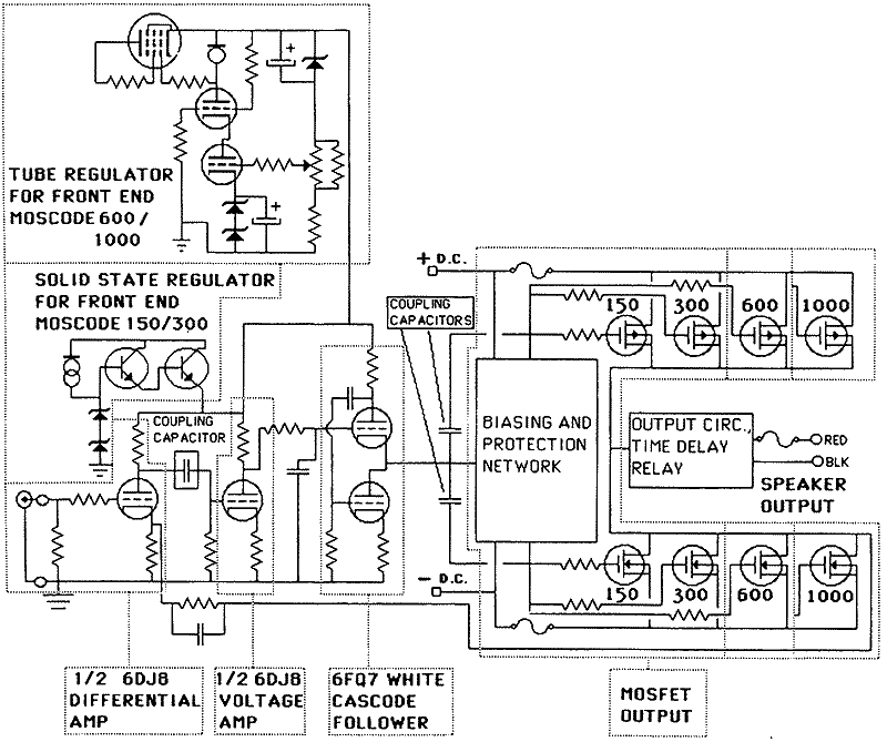

kayes said:Bythe way I am looking for Moscode schematics - does anybody have them?
This is the schematic overview from harvey Rosenberg's "Understanding Tube electronics" (a 100+ page advert for his New York Audio Labs products).
Something like this or a Zen with a tube buffer would be interesting.
