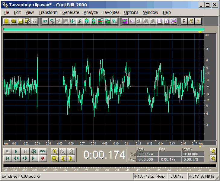

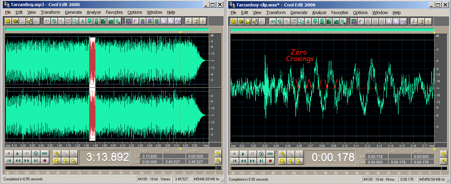

Zero cross, not zero level. Even at max Chili the waveform is crossing zero many-many times a second. Changing gain at these points may be less obtrusive than changing on peaks. (Especially a mute which becomes a max-size CLICK.)How do you detect a zero crossing if listening to a complex audio source? I ...have Chili peppers playing and they don't pause for breath.
Here is Tarzan Boy, a remarkably stupid and frantic ditty from the last century. The full 3+ minutes is non-stop. I clipped out 1/6th of a second for study, so we can see the waveform. We see zero-crossings at least every 5 milliSeconds.
Here I cut gain to zero, first on peaks, then on zero crossings. There is less disturbance if we can wait for a zero-cross.

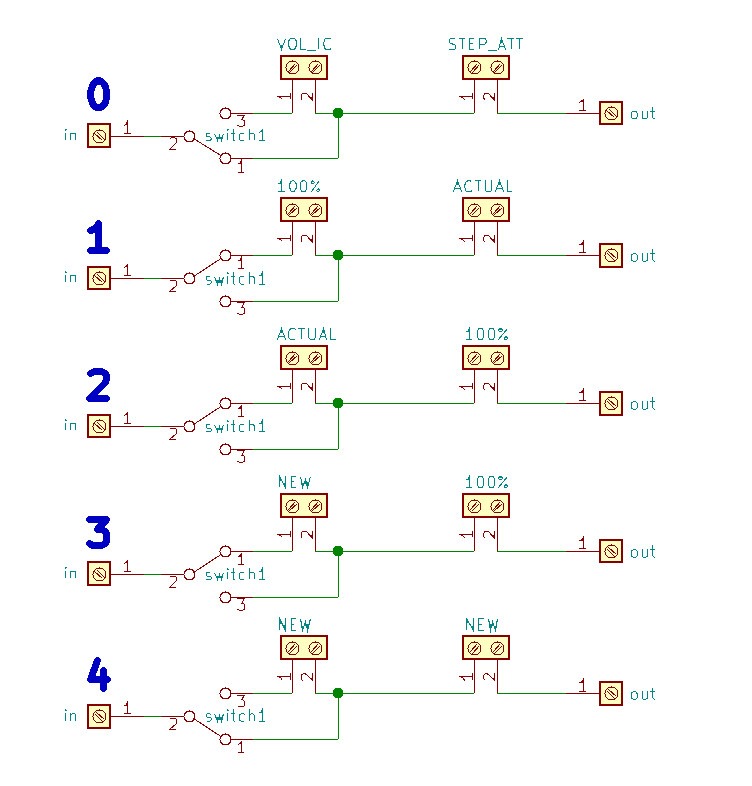

OK, if the zero crossing thing isn't a critical requirement, how about the idea of bypassing a volume IC as shown in attached diagram? Step 0 to 4 shows the sequence when volume is changed. "100%" means full volume without attenuation, "NEW" means the new volume after user has stopped changing volume. Would that be a stupid idea?
Nice idea. Okay, the clicks when adjusting the volume have been eliminated. But is switch1 a relay? Then you have to manage the switchover again.
Ok, so how about using 2 relays in parallel and switch them from the MCU in a timing sequence so that the signal gets handed over without a gap...? Or even use a MOSFET to bypass the volume IC?

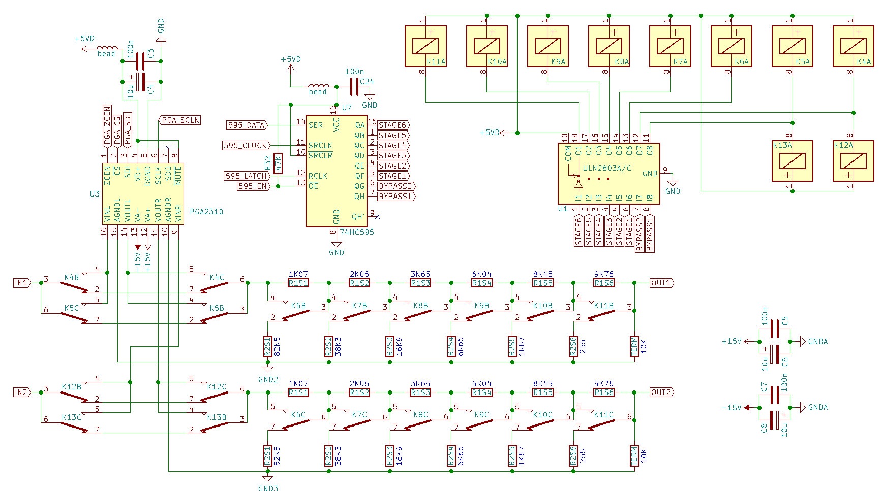

OK, I ordered PCBs with the attached schematic, let's see if that works well. I used 6 stages of relay attenuation, for volume outside the range I could always use the chip attenuator, but I think 6 stages should suffice. I am not sure if I need the bypass relays in parallel, but since they do not hurt, so why not I thought. Sorry for being OT, maybe I will start a new thread if the project goes well...
I ran into the same problem of pops in the audio with a relay based attentuator and found the problem was acute when switching 7 relays off and 1 (MSB) on, going from 01111111 to 10000000. I was doing the switching with discrete digital logic circuits so the relays were changing in microseconds. I ended up using an Arduino processor to control the relays so I could introduce a 2 to 3 millisecond delay switching each relay sequentially, LSB to MSB turning the volume up and MSB to LSB turning the volume down. I least that is how I remember it, been a while. You can find my thread for the volume control in this forum. https://www.diyaudio.com/community/...input-mute-remote.326029/page-28#post-7272132
Switch all those positions going to zero without delay and all positions to one after 4 to 5 msec delay.
So fom 0111111 to 1000000 goes first to 0000000 and after 4 msec to 1000000.

You must first measure the relay delay with an oscilloscope. This goes from about 1ms to 10ms, depending on the relay quality, temperature, coil voltage, etc. The software must take this into account.
