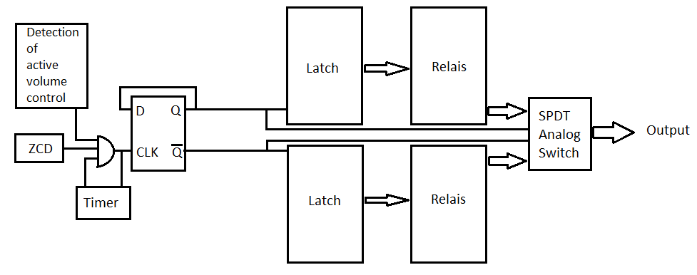

OK, if the zero crossing thing isn't a critical requirement, how about the idea of bypassing a volume IC as shown in attached diagram? Step 0 to 4 shows the sequence when volume is changed. "100%" means full volume without attenuation, "NEW" means the new volume after user has stopped changing volume. Would that be a stupid idea?

OK, I ordered PCBs with the attached schematic, let's see if that works well. I used 6 stages of relay attenuation, for volume outside the range I could always use the chip attenuator, but I think 6 stages should suffice. I am not sure if I need the bypass relays in parallel, but since they do not hurt, so why not I thought. Sorry for being OT, maybe I will start a new thread if the project goes well...

I ran into the same problem of pops in the audio with a relay based attentuator and found the problem was acute when switching 7 relays off and 1 (MSB) on, going from 01111111 to 10000000. I was doing the switching with discrete digital logic circuits so the relays were changing in microseconds. I ended up using an Arduino processor to control the relays so I could introduce a 2 to 3 millisecond delay switching each relay sequentially, LSB to MSB turning the volume up and MSB to LSB turning the volume down. I least that is how I remember it, been a while. You can find my thread for the volume control in this forum. https://www.diyaudio.com/community/...input-mute-remote.326029/page-28#post-7272132
