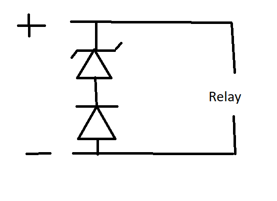

Can you please chk my rough diagram for correct orientation and mention values for Zener , say for 5V , 12V, 24V relays assuming 1N4007 flyback diode.

So from what I understood, for a 12V relay , Vz should be greater than 12V but less than the most sensitive part of the circuit
Noob type Question- Can multiple 1N4007 in parallel will help to collapse the voltage and / or current rapidly?
Please can you provide any rough diagram showing Zener orientation, I don't want to see holy smokeIf you connect the zener diode between the collector and emitter of Q3 in post#23, you can eliminate the 1N4001 diode. Fewer parts ---> smaller board, lower cost.
No, increasing the Vf will help to collapse the voltage and/or current quickly.Noob type Question- Can multiple 1N4007 in parallel will help to collapse the voltage and / or current rapidly?
A simple way to increase the Vf is add a zener diode in series to the diode.

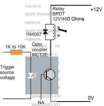

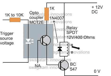

Which option is better? source https://www.homemade-circuits.com/how-to-drive-relay-through-opto-coupler/
The article mentions increased power dissipation in the 1st option
Can uln2803 relay driver IC avoid all these issues. My application is a DIY relay based input source selection and volume control. Didn't find any note mentioning faster relay turn off time in the datasheets

Best kept simple.
The open / close time of a relay is in milliseconds.
Just use an arc suppressor device if you feel it is needed.
