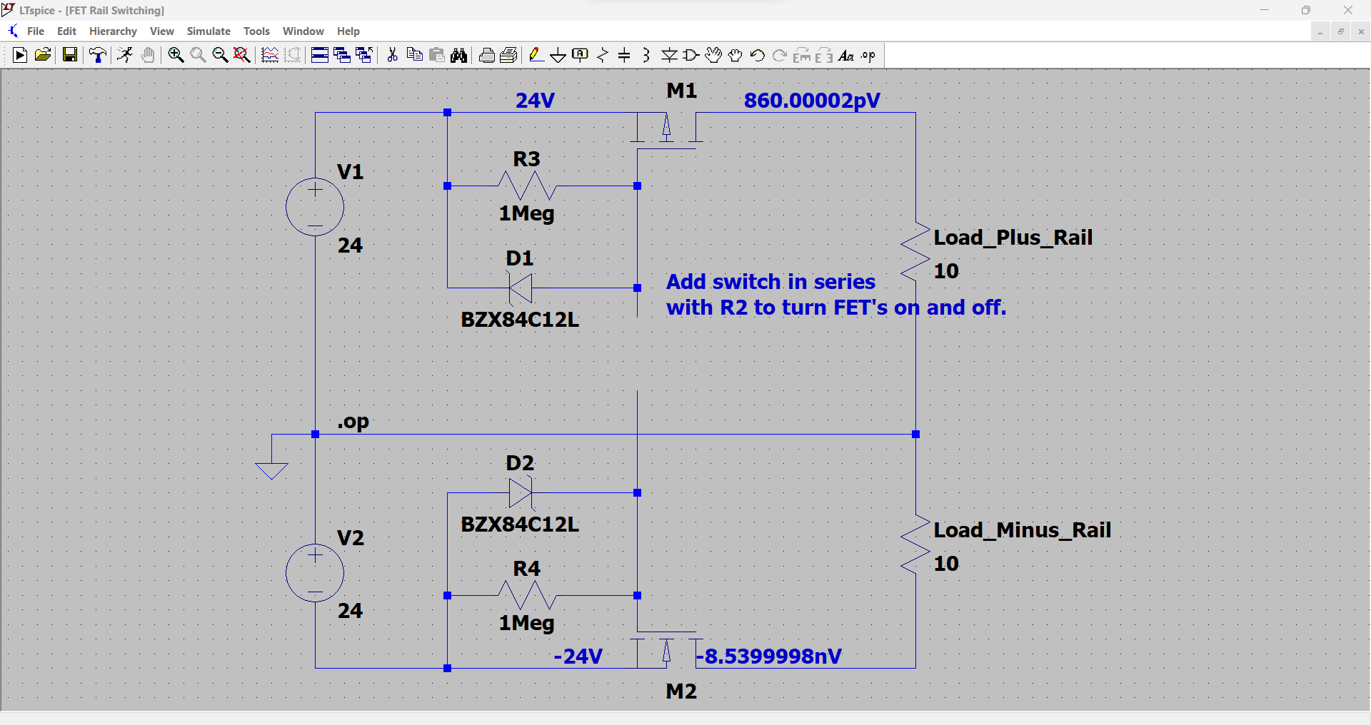

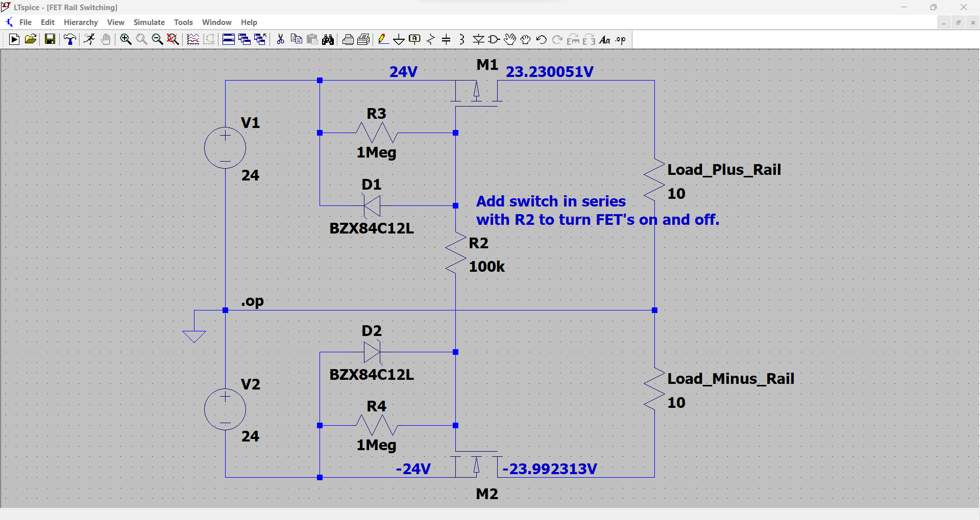

This is something I had from ages ago that shows the idea and how simple it can be. It is not meant as a definitive circuit, just a way to show how it is done. There are FET's available now with really low on resistance which is ideal for rail switching.
The upper FET is an IRF9640 which isn't one of the lowest resistance FET's around but the lower FET was an IRF2907 which is much better (and there are better than this around). Load current here is about 2.3 amps.
Switch on:
And switch off:

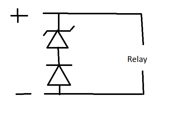

I also have a zener in series with relay coil flyback diode.What is the Amps rating of the relay and the load?

It makes relay release quicker and so less arcing.

Can you please chk my rough diagram for correct orientation and mention values for Zener , say for 5V , 12V, 24V relays assuming 1N4007 flyback diode.I also have a zener in series with relay coil flyback diode.
