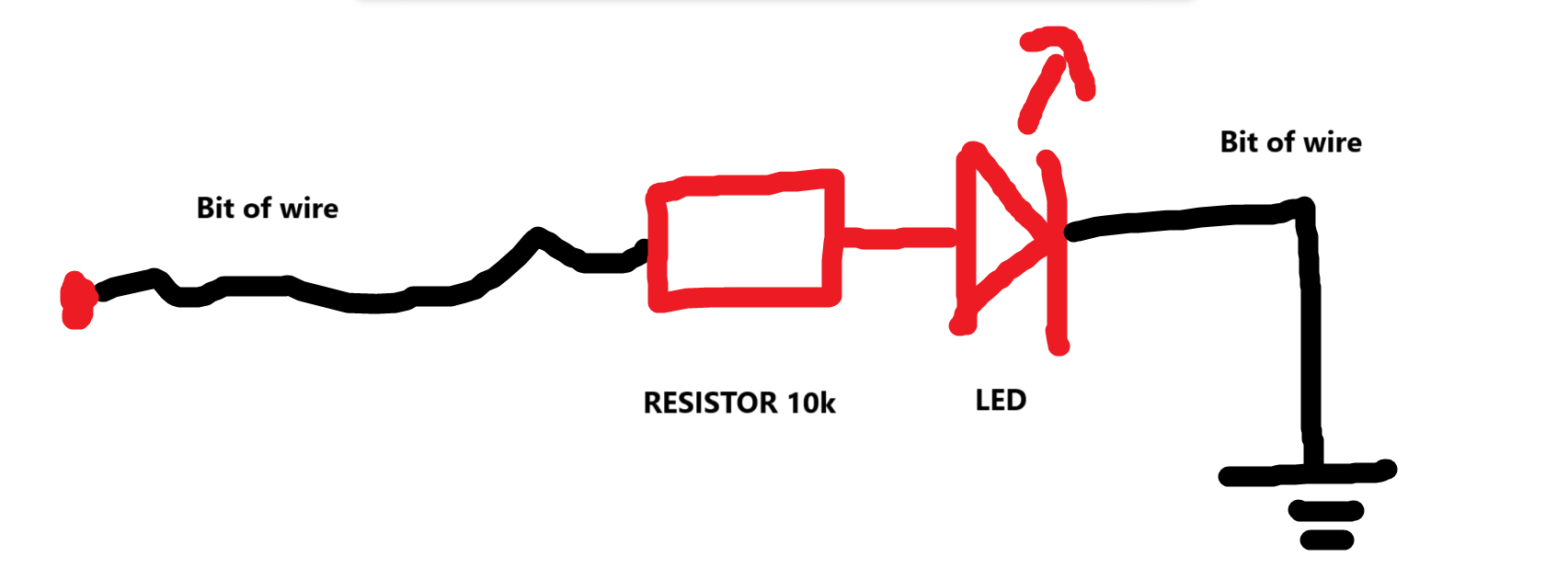

What does a "probe" looks like and what would i show when used on pin 5 and 6?
Super sophisticated is what it looks like. When the wire at the left sees 5 volts the LED glows. The LED is instant response so you can see short duration pulses.

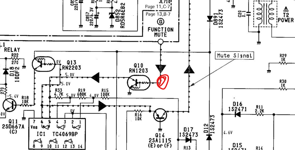

Pin 1 is shown at 4 volts which is a High. Pin 2 and pin 3 should be Low. Pin 4 should be High. Those levels should be a constant and only change if the voltage on C19 drops. So these pins are worth checking.
Also look at pins 8, 9 10 and 11. There looks to be an error in the voltages here on the diagram. Zero volts on pin 2 (that looks correct) is then shown as being 5 volts on pin 11, the same point. So pin 11 should be zero. Pin 10 and 9 should be High and pin 8 Low.
The takeaway point from that is pin 8 should be the same as pin 11 at all times. Connecting gates in series like this is common practice to 'use up' spare gates in a package.
This could be a worthwhile test
If you remove R33 and then connect a resistor (any value from 1k to 100k will do) from pin 5 (or the collector of Q10) to pin 14 we 100% remove all the mains detection stuff and that should help eliminate that area of the circuit. The resistor is just used as a collector load or 'pull up' resistor to take pin 5 high yet allow Q10 to remain in control.

I think i have a LED and a resitor somewere and will give it a try.

Those show no problems at this point. Each input and output is in a valid state. That means 1 in gives 0 out and vice versa.Ok, here are the pins on IC1

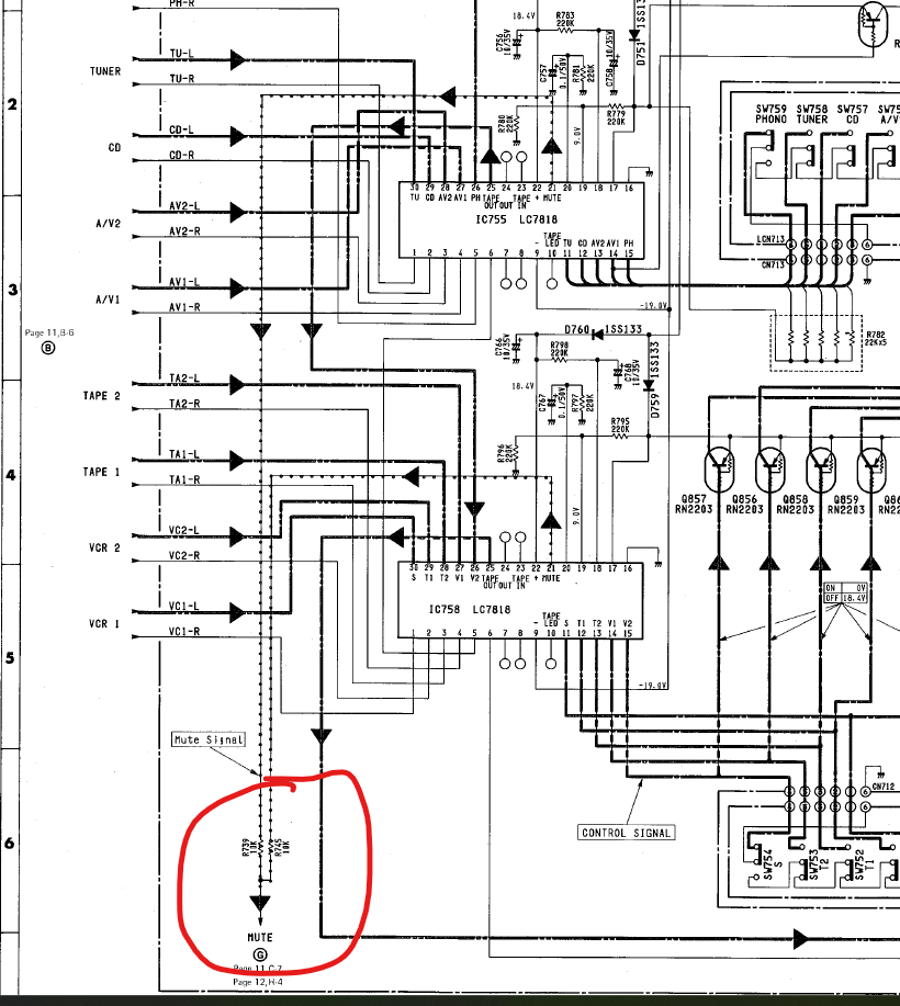

Where is this 9 second delay being generated? The only place that makes sense is from the LC7818 chips but you would see that voltage on Q10 base change.
The input to Q10 is the only way that the relay driver levels can be flipped. We have measured the other input which is the AC detect voltage which is pin 1 of IC1 and we are disregarding that having tested that area of the circuit.
You have to find 'what changes' in terms of voltage inputs to IC1 to prove to yourself how the relay is driven. Q10 has to be key to all this as this is what turns the relay driver on or off.
Do you see the voltage on pin 21 of each LC7818 generate this 9 second delay, You will have to measure on both IC's in turn and monitor continuously during this period and see if the voltage flips level in time to this 9 second delay.When i power on, the voltage at Q10 base is 0, then after 9 seconds the relay opens base of Q10 is 0, then switch power off and relay closes, still 0 volts at the base of Q10.

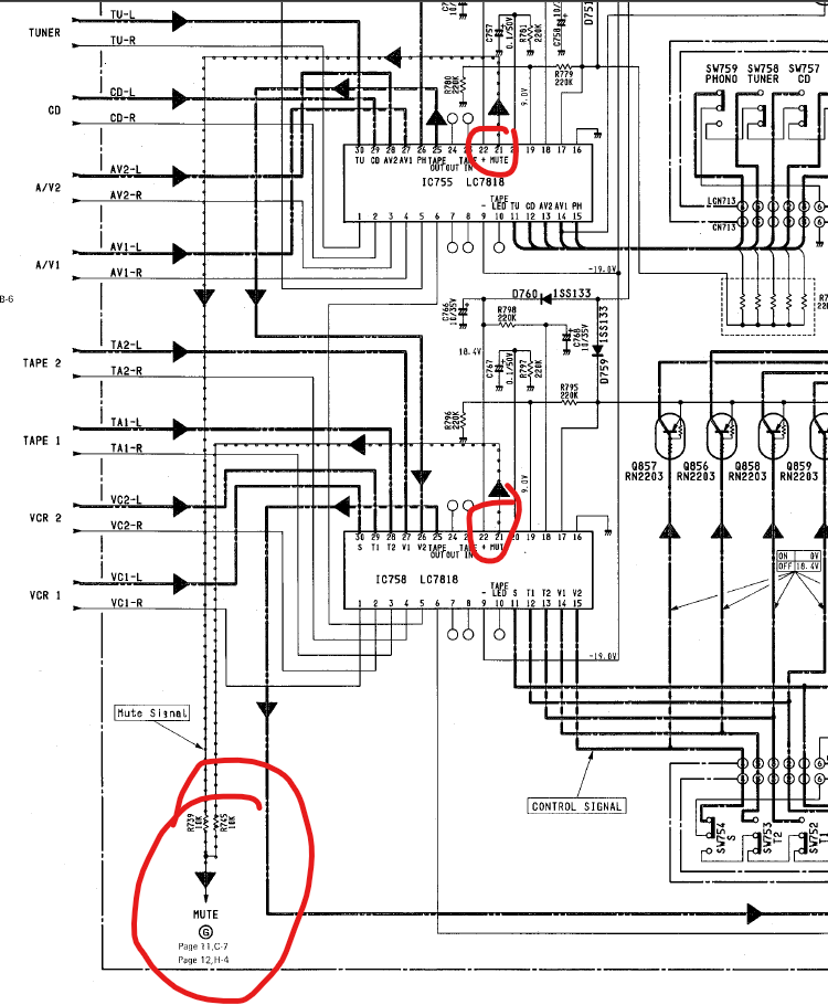

I measured a bit this morning and found pin 21 on IC755 is 4.6V directly at power up. Changing program was 4.7V with clicking RL1.
Pin 21 on IC758 is 0.1V directly at power up. Changing program was 0.2V with clicking RL1.
I also measured the base of the Q10 and at a more sensitive measuring range on my Fluke, I saw 1.2V that came right at power up.
When changing programs I saw 2.3V at the base of Q10. I don't know, but the delay of RL1 on startup doesn't seem to depend on any of the above, instead it seems to be something after Q10?

Pin 21 is labelled 'mute' and the two chips have their mute lines resistively mixed together by two resistors.

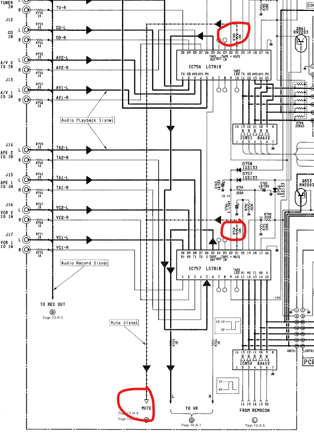

The manual seems to show a few different versions of the same things.
This is the same but slightly different. The chip numbers change as well.
There is nothing after Q10.... what happens on pin 5 of IC1 is the only control signal for the relay.
That sounds very plausible. It is 2.3 volts because of the action of those two resistors that mix the two mute signals together and the action of the resistive input of the so called 'self biasing' Q10 which has built in resistors.When changing programs I saw 2.3V at the base of Q10.

This is why I think LED's would help. They show changes the meter might miss or misinterpret.Ok, i just got back to the IC1 did measure pin 5 with the Fluke set to lower range.
