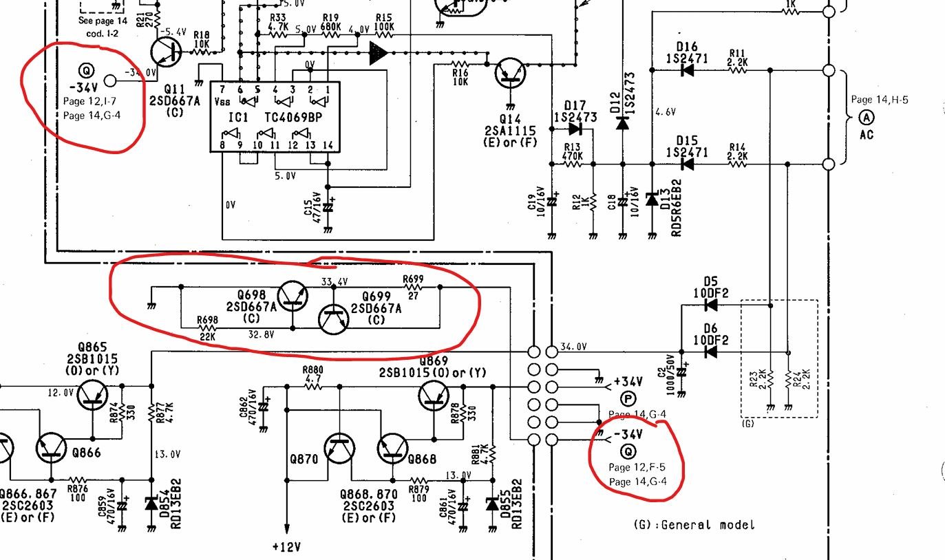

Last time the amp was power on i noticed that the Q698 was so hot it was barely touchable and the PCB under it was slightly darkened what does it do?
Should i replace this and the R698?

I'll have another look tomorrow but that part of the circuit doesn't compute... collector of Q698 shown as grounded and emitter marked at ??? 34 4 volts. Can not be positive because that reverse bias an NPN transistor. Its shown as going -34 that you have circled. That is OK polarity wise.
The circuit is a text book current source/sink with current limit set by R699. When the voltage exceeds around 0.6 volt transistor Q699 turns on and limits the current at that set value. So 0.6/27 gives a current value of 22ma approx. 34 volts across the transistor would dissipate 0.022*34 which is 0.7 watt. If there is no heatsink fitted then it will run pretty hot. That would be normal.
If there is around 0.6 volts across that 27 ohm it is all working correctly.
What does it do... well the only thing it can do as it is drawn is to provide a constant current loading to the -34 volt rail.
The marked voltages are all wrong around the transistors. They must all be negative in value.

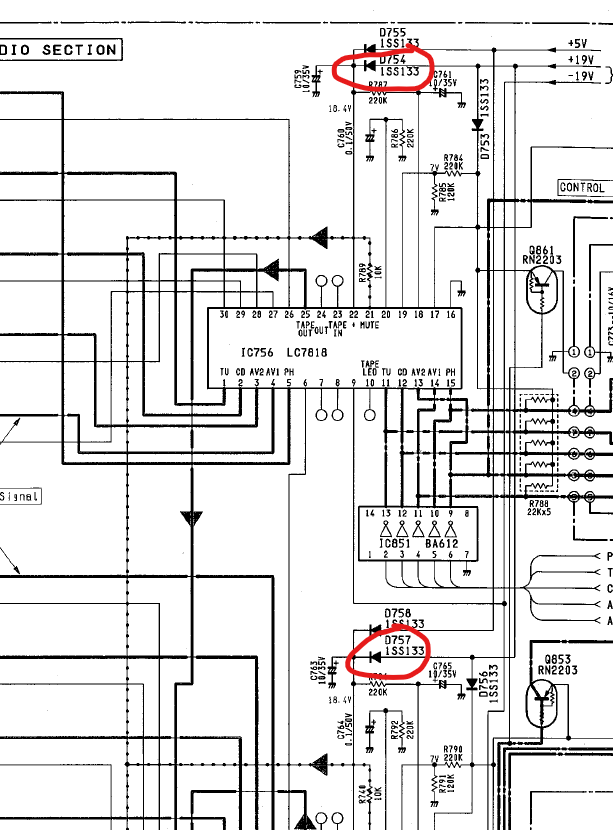

I think a first step might be to isolate the LC7818 chips from the 19 volt rail and then see if that rail comes up to 19 volts. Do the chips feel warm when powered up and you have this 15 volts instead of 19 volts? Is one warm and the other not perhaps?
Each chip can be isolated by lifting these diodes.

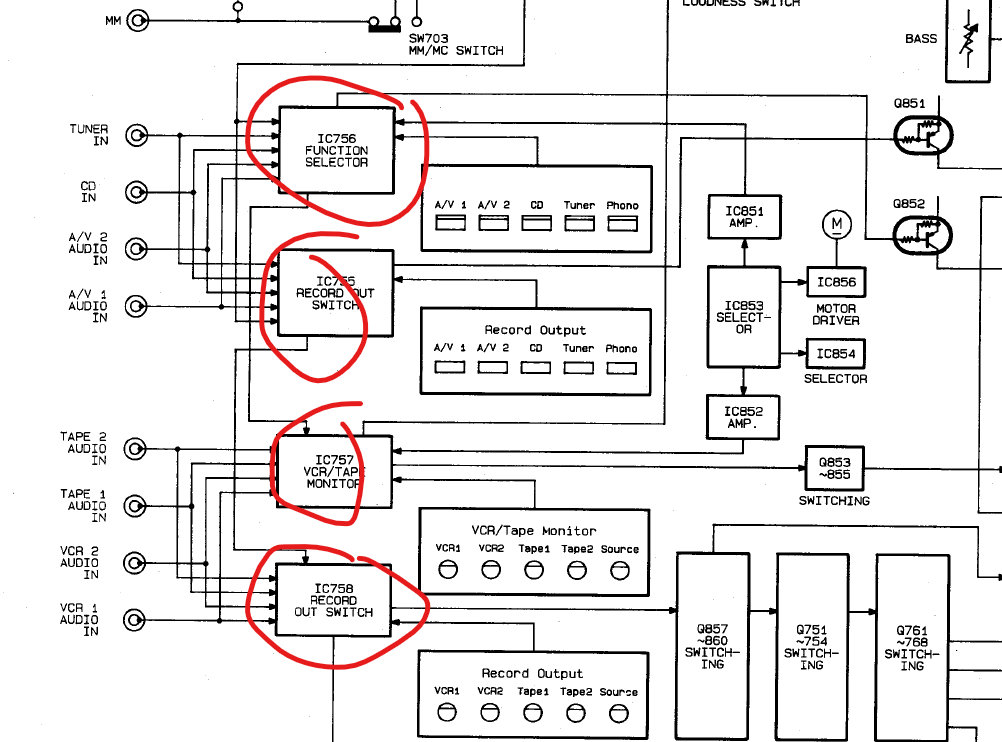

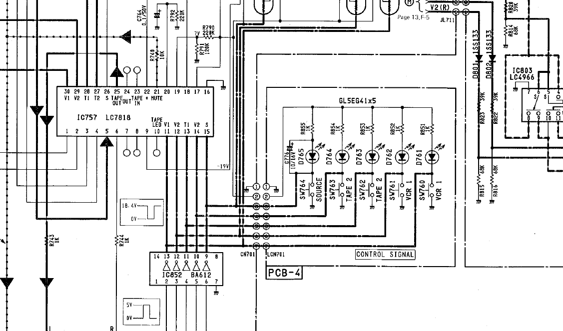

In other words, the sources AV1, AV2, CD, Tuner and Phono is not separated well as they should be. What may be the cause of this?
It is certainly possible the chip could be at fault.

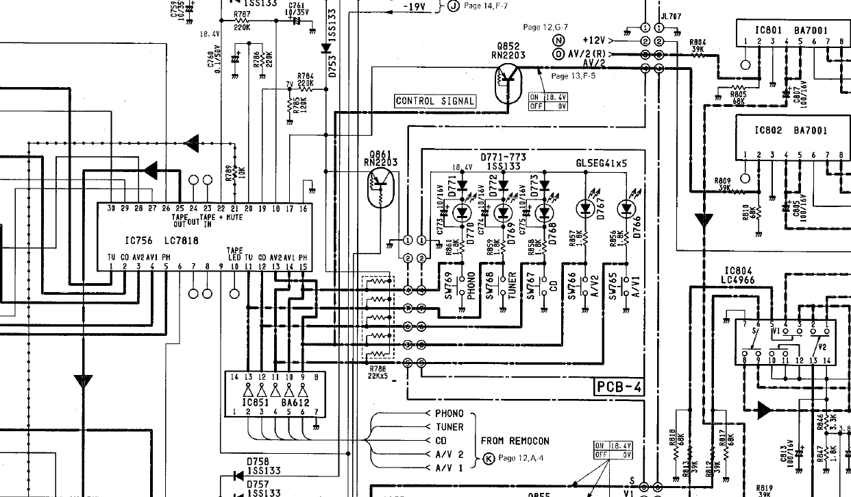

Do the LED indicators for source selection look normal. Just one on at one time? If so then we can assume the logic to the chip that decides which input is selected is OK.
The same logic levels drive all the LED's. So are all these normal (just one LED on at a time)
Ok. Yes the indicators for source selection look normal, one on at one time. Everything seems to work as it should except this "crosstalk".Do the LED indicators for source selection look normal. Just one on at one time? If so then we can assume the logic to the chip that decides which input is selected is OK.
The crosstalk is worse on AV1 and AV2, then on CD, Tuner and Phono. I have the cover off again and intend to check the 5 R788 and the diodes D771-773 to see if there is a problem there.

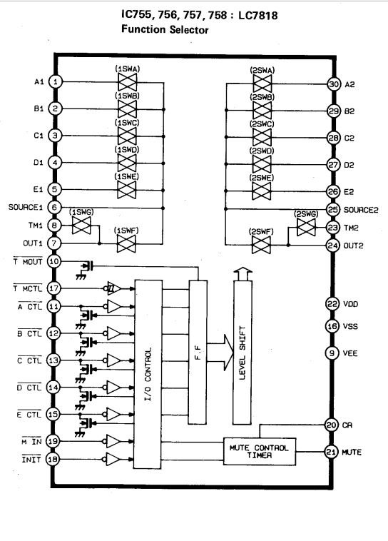

It does sounds like the chip is the most likely. Also remember the manual shows there are four of these LC7818 chips in there 🙁
I don't know what to suggest really. Ultimately you have to check them by substitution with a know good one. I wonder if you could remove all four and then replace one at a time begininning with the main input selector. Ideally a socket could be fitted and you could test all the other three then in that position.

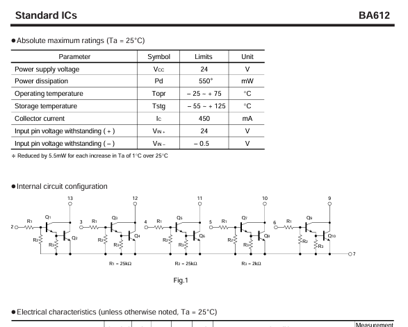

I really can't see those being at fault. They are just 'pull up' resistors, needed because the BA612 is an 'open collector' output which simply means without a load resistor the pin is effectively floating.
To get a true reading you must unsolder one end of the resistor you suspect and re-measure. You can not test them in circuit... and they won't be faulty, honest 🙂

I have ordered 2 new LC7818 and 2 32 pin sockets which i´ll cut down to 30 pins.
It will be a challange to remove the old LC7818, any tips? Hot air gun or cut the pins?
Use solder braid. It should come out in two minutes and look as good as new. You need a hot iron with a decent fairly large tip. Practice on something scrap first. It is an acquired skill like most things but you should be able to desolder each pin in around 2 seconds per pin once you get the knack.
