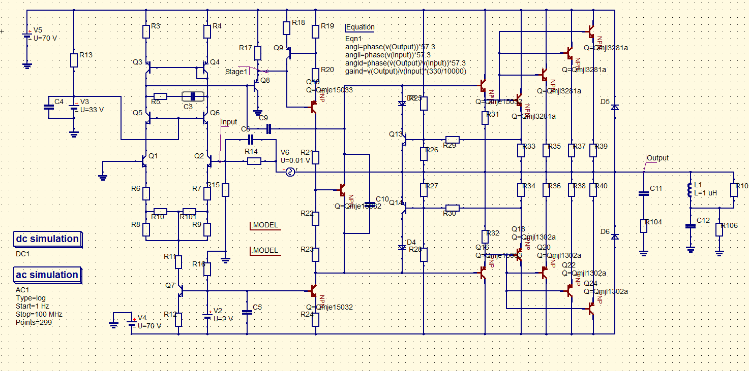

The following the C300 amplifier schematic that I am using. I modified it by adding faster VAS and output transistors (3281/1302 with fT=30 MHz), and I'm trying to rebalance the feedback to prevent oscillation. I am using faster transistors to try to decrease the distortion by increasing the loop bandwidth.
The original design has two pole compensation, one with the standard Miller compensation (C9) and the section with R5/C3 in the LTP. Originally, the circuit used slow output transistors (fT=4 MHz) and slow VAS transistors (MJE340/350). I wanted to try to get away with a single pole compensation so I changed C9 to 150 pF. I modeled the open loop bandwidth and the phase margin (according to simulation) is on the order of 80 degrees, with unity gain occuring about 200 kHz.
I could try to add the second pole of compensation, for example R5=620 ohm, and C3=100 pF, but this seems to me to be papering over the problem. If the phase margin is decreasing below zero, I would like to know why. If it isn't because of this, I am trying to figure out what other mechanisms for oscillation there could be.

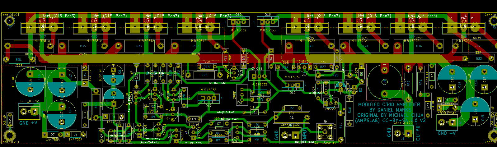

The layout is also included. Most of the top layer (except where the power transistors are) is a solid ground plane with holes through it for the plated-through holes. The output is kept away from the input by being on the opposite side of the board (input at bottom, output at top), and the output is taken off to the side. I would think parasitic capacitance and inductance between traces would be relatively low.

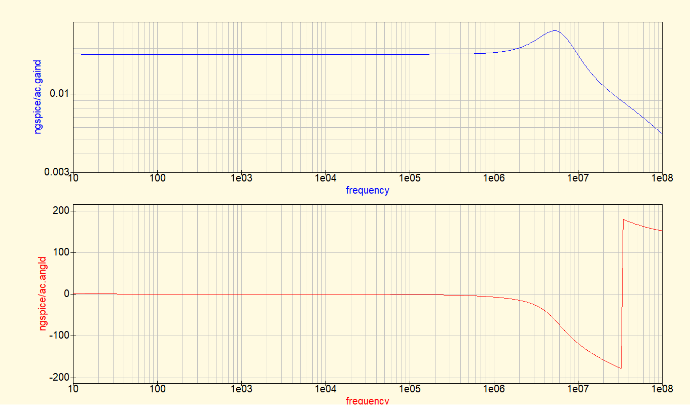

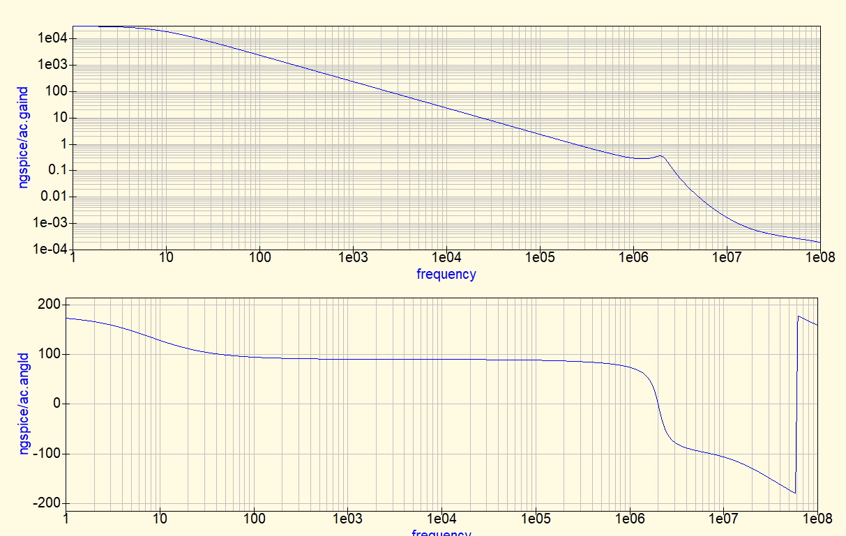

Here are the results of my study of open loop gain in the amplifier. I also did a transient response which identified no oscillation which I can show as well.

There are two ideal bias voltage sources in the schematic, V2 and V3. These must be something else in reality. Is the voltage across whatever is used in real life constant during the oscillations?

You inject the input signal on the inverting input Q2 with or without input resistor? And there is this grounding resistor R15 as if the input on Q2 is the feedback node of an non inverting amp with input on Q1.

The open loop peak at 1.1MHz is a good candidate at Ao=0.4. What is creating this pole?
What are the values of R5-C3 and C9? C9 interacts with Ccb of Q10 (no frequency fixing Rc-load here).
I am only injecting the signal at Q2 to estimate the open loop gain. I am following what is being done in this presentation:
Output L_1
In this presentation on slide 3, it shows how to modify the circuit to estimate the open loop gain, while I have tried to follow. I tested the method with the circuit in the presentation and got the same results so I assumed it worked. In the real circuit, the input is grounded and injected at Q1.
Currently, I leave C3=0 pF because I am trying to avoid using a second pole of compensation. The original design calls for C3=220 pF. C9 is currently 150 pF, where the original design called for 33 pF, but I increased it because the simulations showed the increased open-loop bandwidth required a larger Miller capacitor. Unfortunately, MJE15033 has no spec for Ccb or output capacitance. Perhaps MJE15032/MJE15033 is a poor choice for VAS because it has too much capacitance? It was one of the goals of my design to come up with a simplified design. I was replacing the MJE340/350 in this role.
I also changed BC546C/BC556C for 2N5551/2N5401. Could this be a problem? I felt uncomfortable using transistors not rated for the full supply voltage.

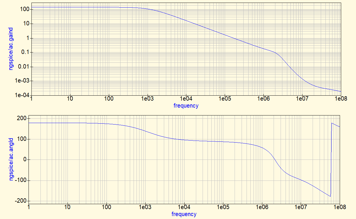

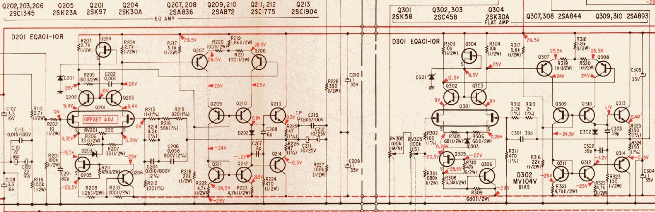

In your post #15 the peak at 1.1Mhz has almost disappeared, so that's what will surpress unwanted oscillations. Compare this commercial circuits from the Sony Esprit series (eighties). Left is the phone pre with active riaa but with a RC in the front stage, right a flat amp with a feedback cap only. Both stages has an enormous open loop gain (>80dB).
