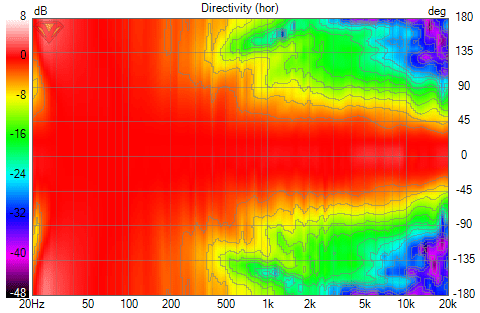

Wavelength is the key, baffle width second, depth and shape of the box is far less important. There are many other factors as well, eg. driver diameter, interferences and resonances.

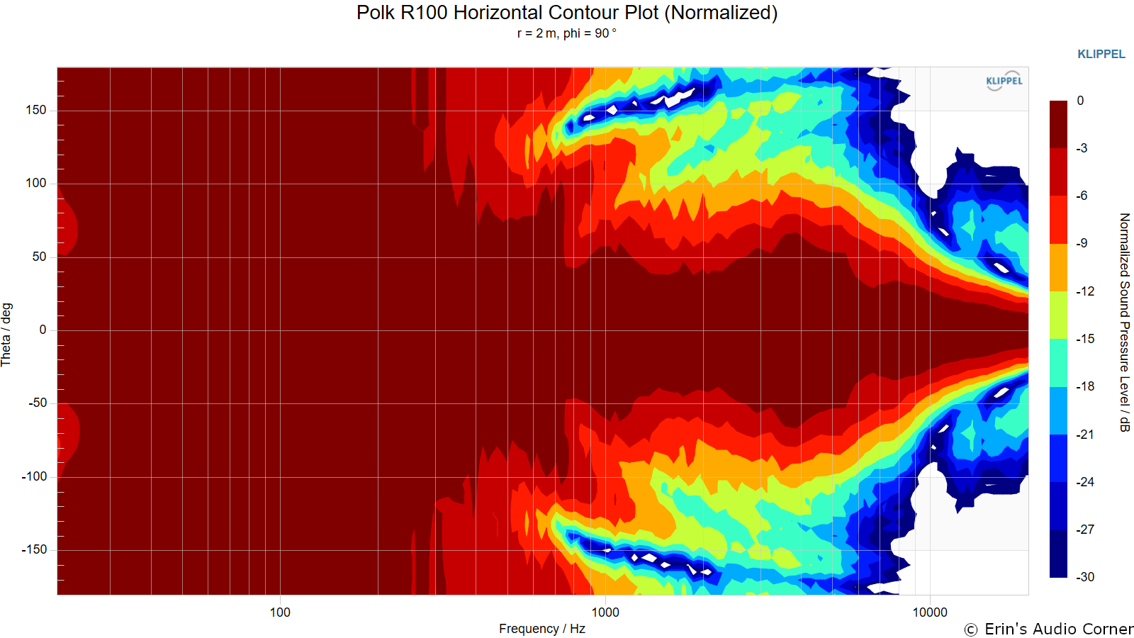

Check these measured results as spectrograms. Remember to check if graph is normalized or not.
https://www.erinsaudiocorner.com/loudspeakers/https://www.audiosciencereview.com/forum/index.php?reviews/

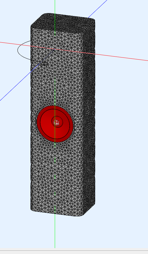

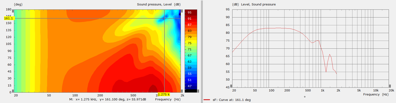

These simulation results should help to answer the question. There is a 300mm wide cabinet that is 250mm deep with a simulation of a Satori WO24 woofer.So the question is, assuming conditions that would exclude complicating factors, such as measurements taken far field in an anechoic chamber, what would be the difference of the two SPL readings (taken directly in front and behind the speaker) at the baffle step frequency? I'm looking for a specific number, such as 10 dB, 12 dB, 8 dB or whatever is correct. The ideal theoretical conditions might include Olson's spherical speaker box if that would make it easier to arrive at a solution.

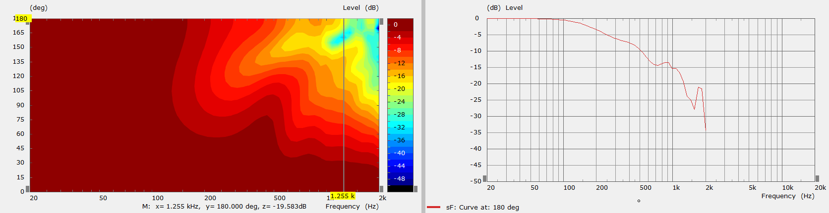

This is the 180 degree response and normalized polar, the area of greatest null is around 160 degrees off axis.

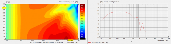

This is the normalized plot at 160 degrees.
This is the plot without normalization at 160 degrees.
The greatest rejection is close to the wavelength of the baffle width which is 1146 Hz.
There are two steps in the directivity related to baffle size and box size. The first step is when the baffle is no longer constraining radiation and the second related to the width and depth of the cabinet combined. This image shows it clearly.Coming up with the answer I think would include an explanation of how the dB difference figure is arrived at, so to that extent I am asking what produces the baffle step.
