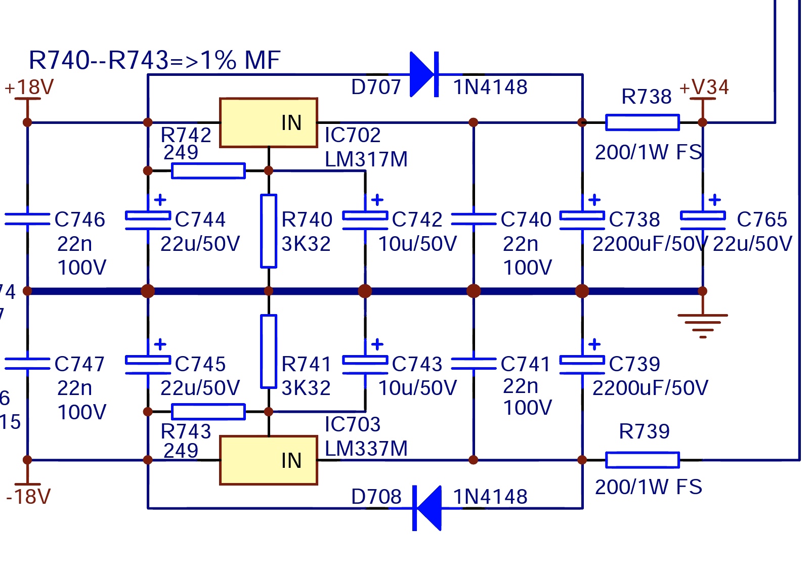

Today replaced a pair of 317/337 (Fairchild and stm) from 2009 to brand new ON and couldn’t detect any difference, atleast not worse but before i had +18.02v / -18.22v and now +17.92 / -18.22v so slighty worse. Just for fun test. I didn’t check anything else. Noticed the new On to-220 pacakge is a bit thinner, i mean the metalpart is basically half as thick.
This is the schematic
