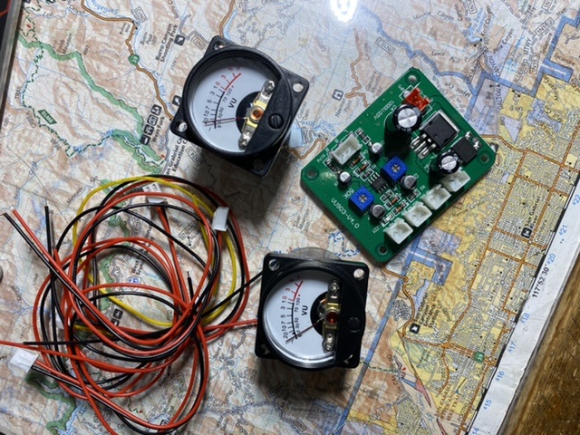

Finally, I got a small VU meter driver board with a couple of meters, just so I could add something nice to the front panel when I build the enclosure. I’d like to have the levels increase when I turn the volume knob, so I was thinking of running a small capacitor between the preamp outputs and the driver board input. This should allow for the AC signal to pass through to the driver board without the power tube anode voltage crossing over. I attached a picture of the driver board and the meters. This should be okay, right? What capacitance value would work? I’m thinking like 0.22uF or smaller.

Do you not want to connect the VU board input to the speaker terminals?
That’s a great idea. I’ll go ahead and upload a copy of the schematic with all of the voltages annotated. I was planning on connecting the VU driver board before the output stage as I read somewhere that it might mess with output transformers as extra load. I’m also running one channel for testing as my tube on the channel was having some issues. New tubes should be delivered this Saturday.
Unfortunately I don’t have a schematic of the driver board. Listened to a vinyl on the tube for a good 40 minutes or so with a couple of thermocouples (one attached to the resistors that were blowing, the other aimed at my power tube) and it performed flawlessly. Temp on the tube equalized at around 270°F and the resistors didn’t get over 115°F. I’ll put a 1K resistor in series to the output side of the transformer and run the VU’s tomorrow.
