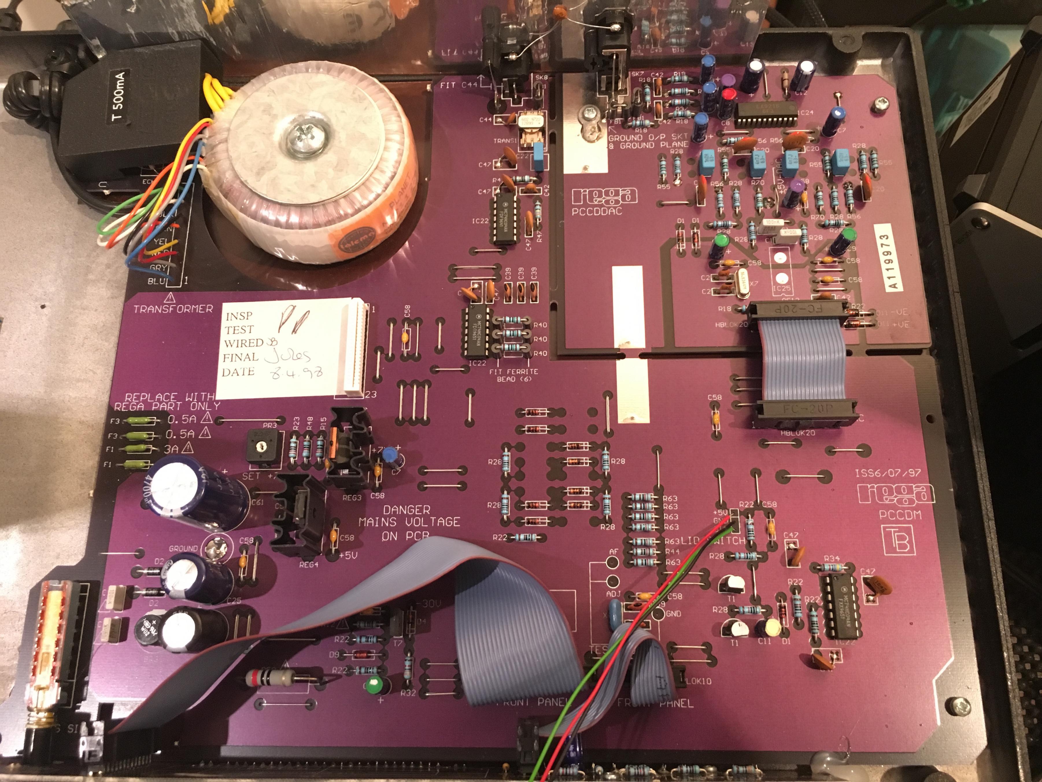

Can I use the original rega planet as a dac? It's a nostalgia thing, have many better dac's & options.

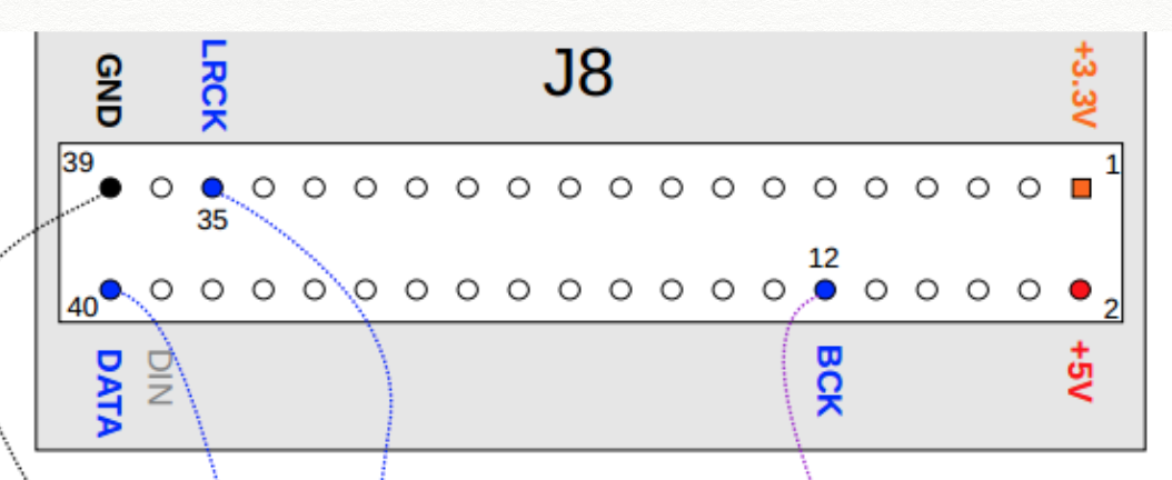

I'd like to take a piZERO, and wire it's i2s straight in somewhere. If a MCLK is needed I'll use a hifiberry D+Pro's i2s out.

**** -- maybe someone can spot something... could be a fun project, or if it a definite no-go please let me know. Also I can take some pics of the underside (dac chip) no pics anywhere online I've found of that.

PCM1710 dac datasheet
LA9215 datasheet

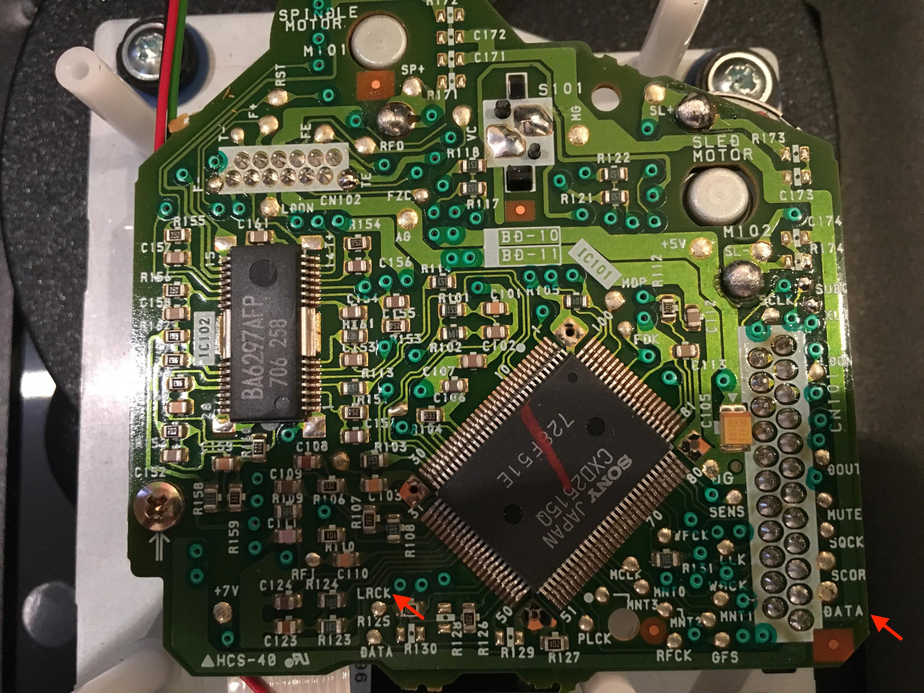

and a pic of the sony transport... started pointing arrows for possible i2s-->
pi --> the pins I found on the PCM1710:
mck
bclk -> bclin
fclk -> lrcin
data -> data, din
gnd -> gnd
--> but maybe these are right on the sony transport board, or pins on the short ribbon cable going to the dac section.
since it will probably only accept 16/44, i'll just set picoreplayer (or other) to resample everything to 16/44
