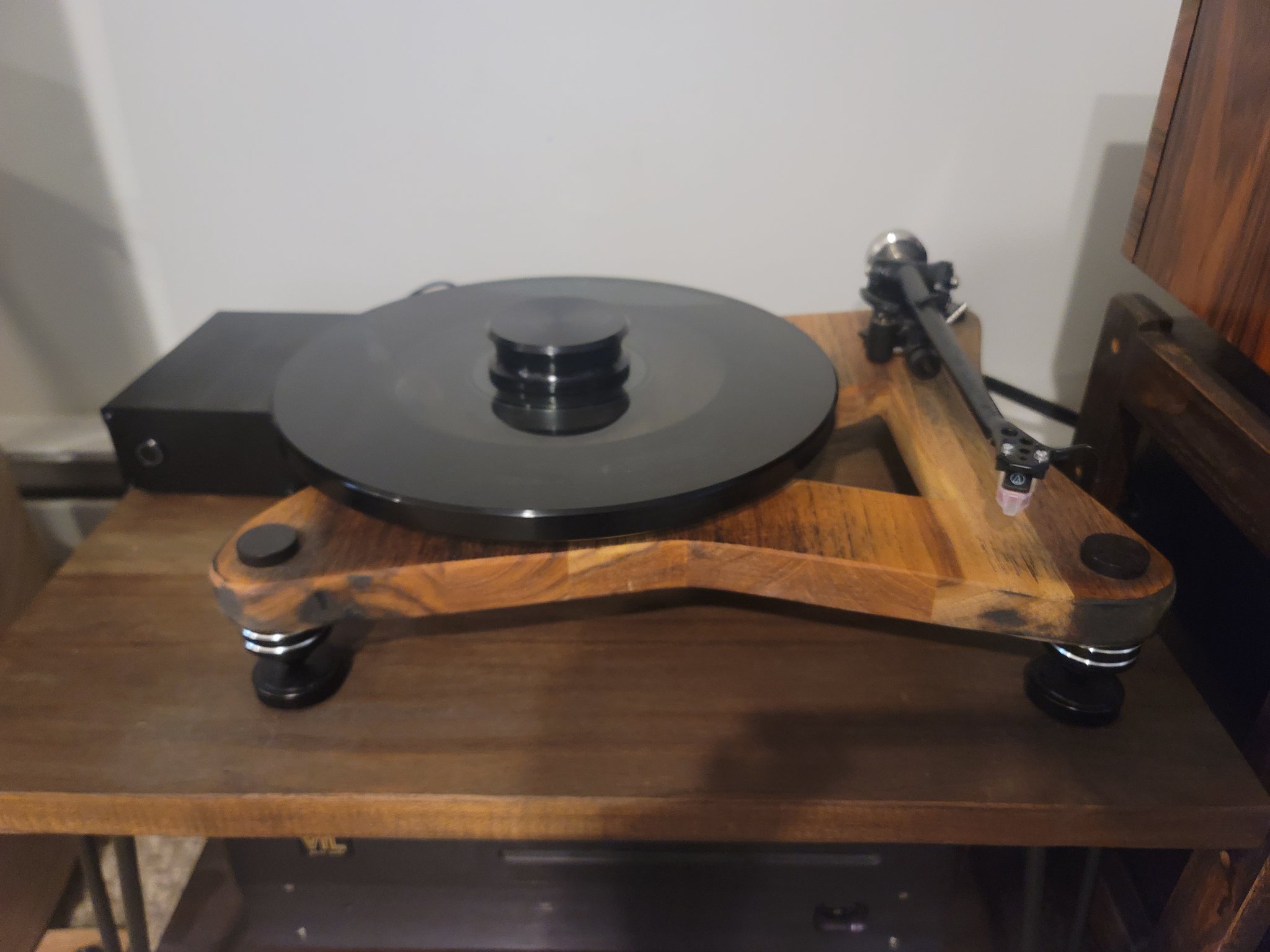

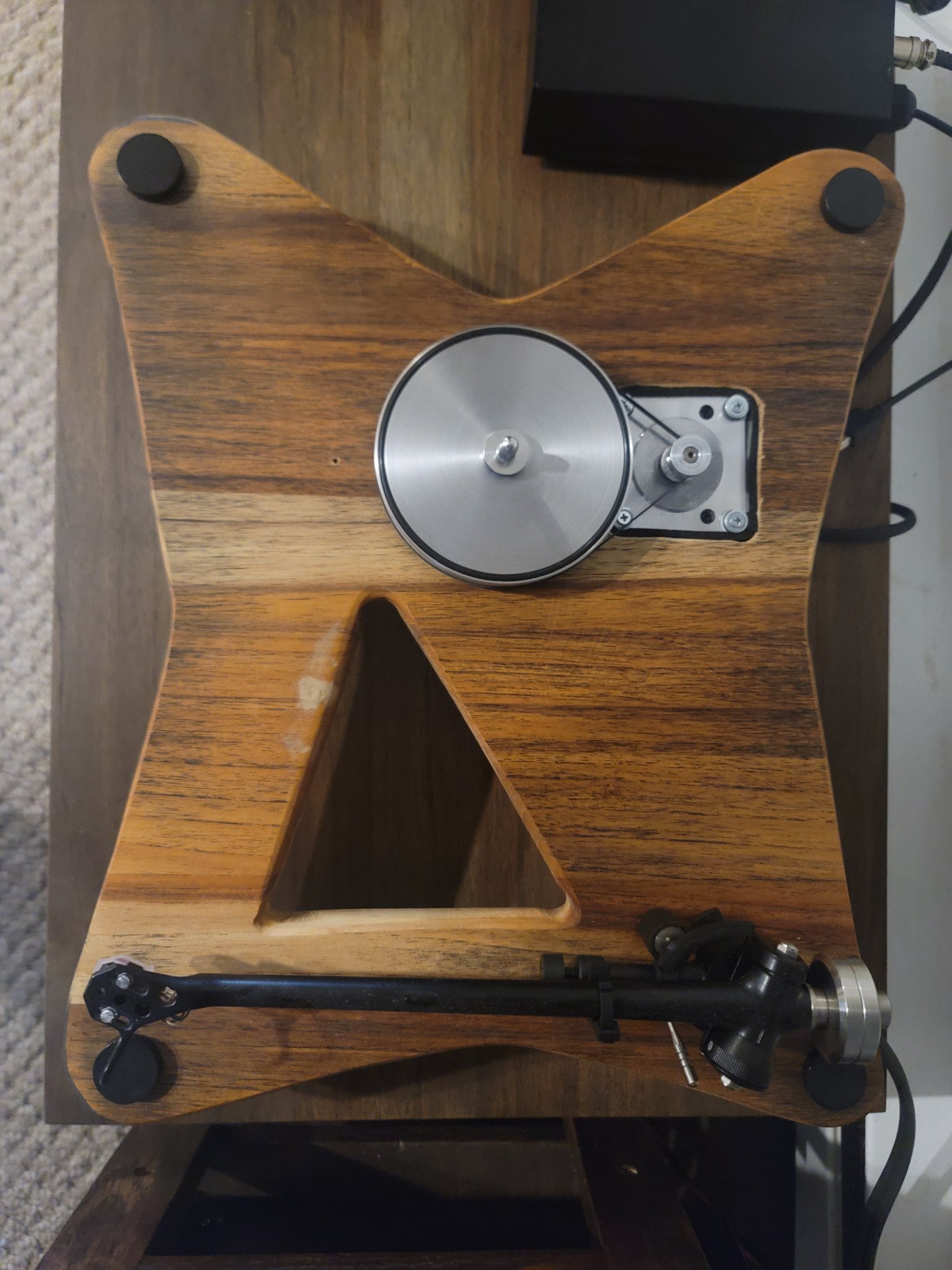

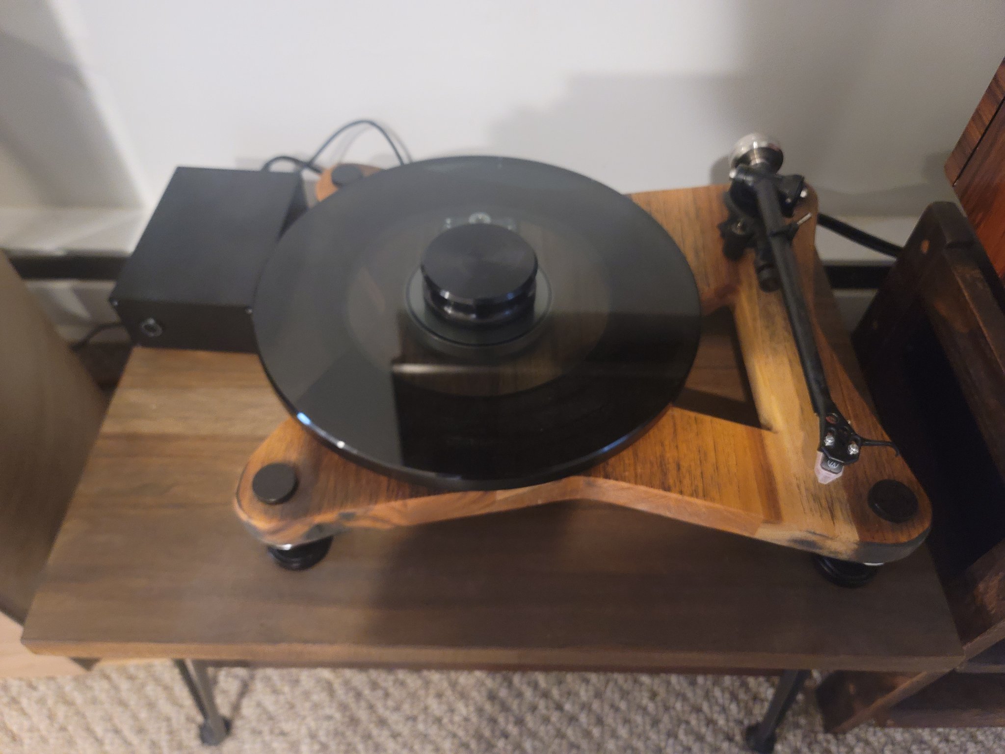

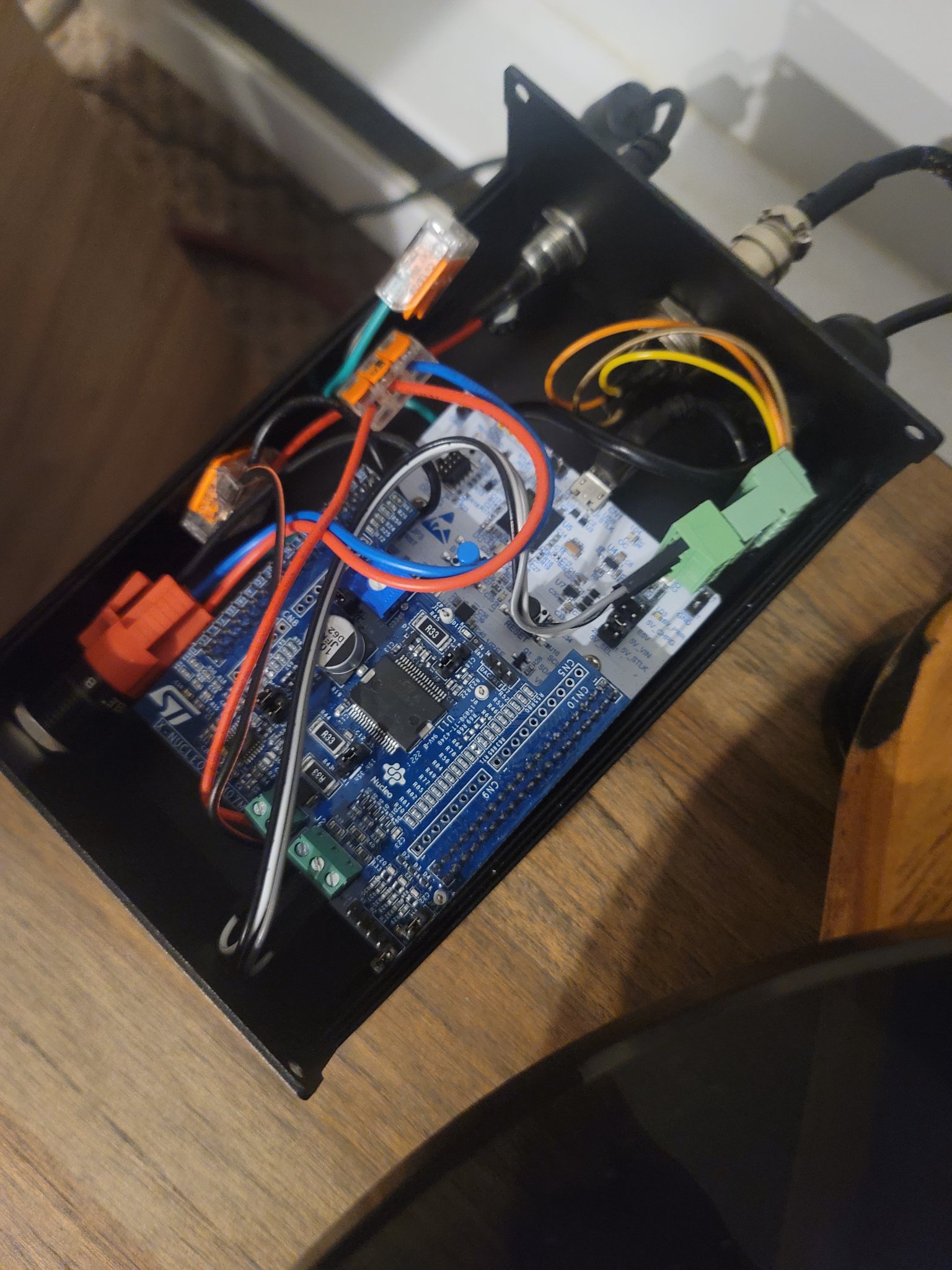

Sorry for hogging the thread, but I see from other posts you have tried a few different motors for your turntable projects. What is your preferred solution/motor? Do you have a direct link?I built my own table from a Rega 303 arm, Rega 6 glass platter. TangoSpinner subplatter. Motor is a 3-phase BLDC 12V NEMA23 style motor from Anaheim Automation. And motor power supply is a 3-phase sine wave generator base on a ST Micro microcontroller and motor driver daughterboard. View attachment 1432564View attachment 1432565View attachment 1432566View attachment 1432567
I use a Anaheim Automation motor right now, mounted under the platter and driving the subplatter via a flat belt.

Yes. Zero noise and undetectable vibration (as far as I can tell), and very stable RPM in open loop. I am working on using the Hall Sensors or an external encoder to get better results in closed loop.Using SimpleFOC? Stable rpm and low noise?
