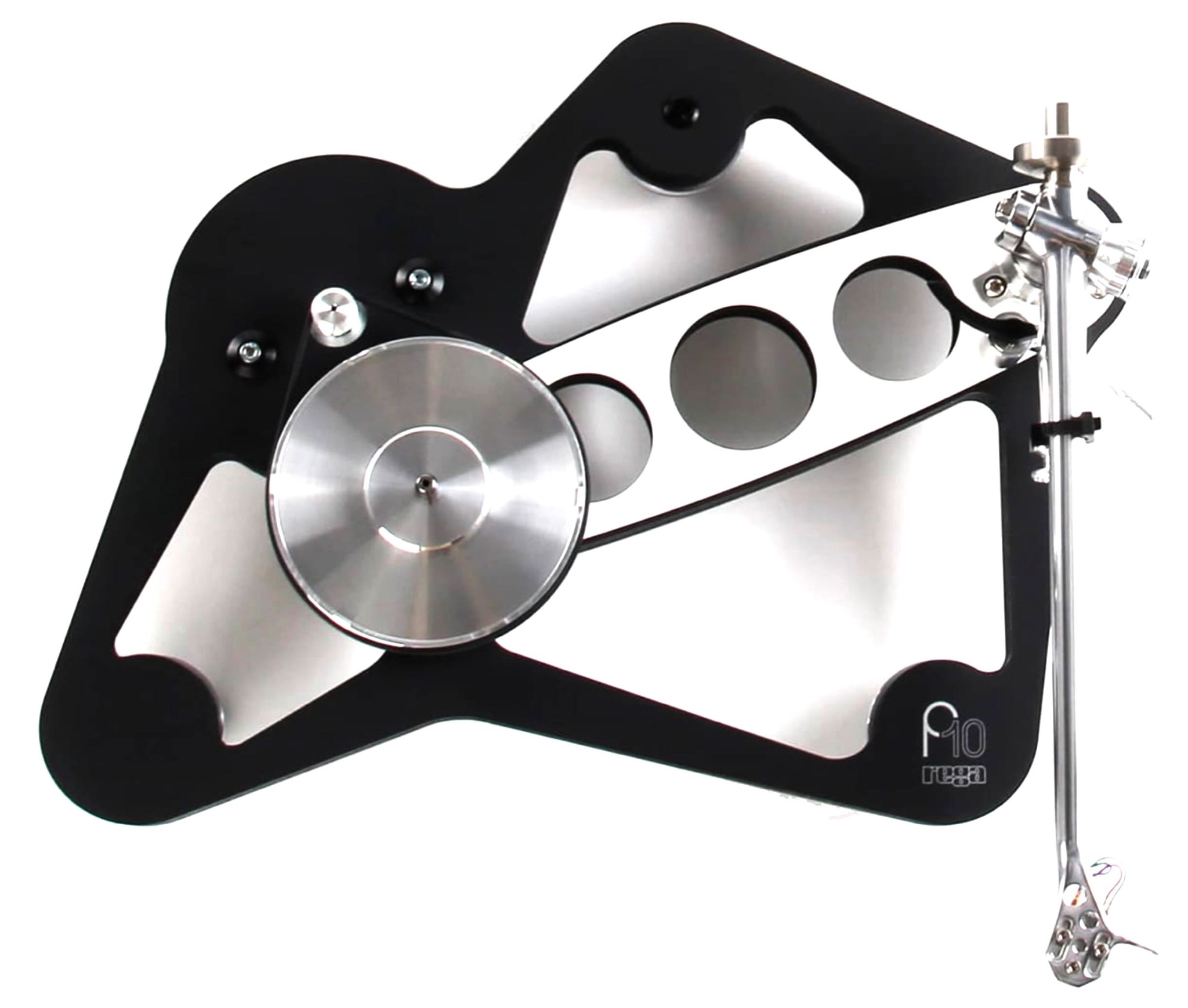

Hi everyone, I have recently bought an old banged up Rega P2 and was hoping to try a new build.
I thought it might be good to try a P8 (P10) clone, with the new shape base and a rewired / silver RB250 arm.
I have details of how to remove the black paint from the arm and a template to drill holes in the arm and rewire. What I don't have is a detailed size / cutting shape for the base.
Is there anyone who could help me with this please?

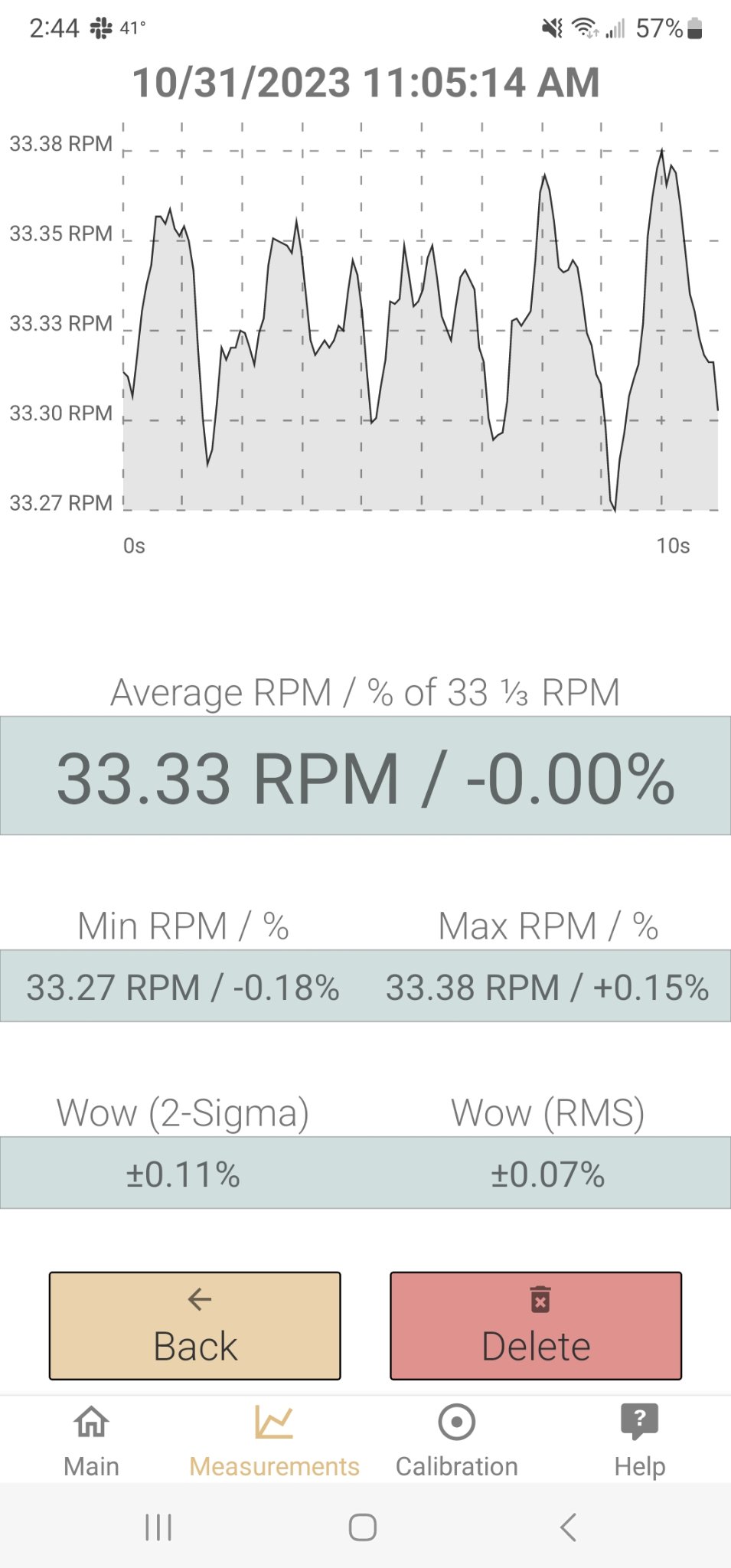

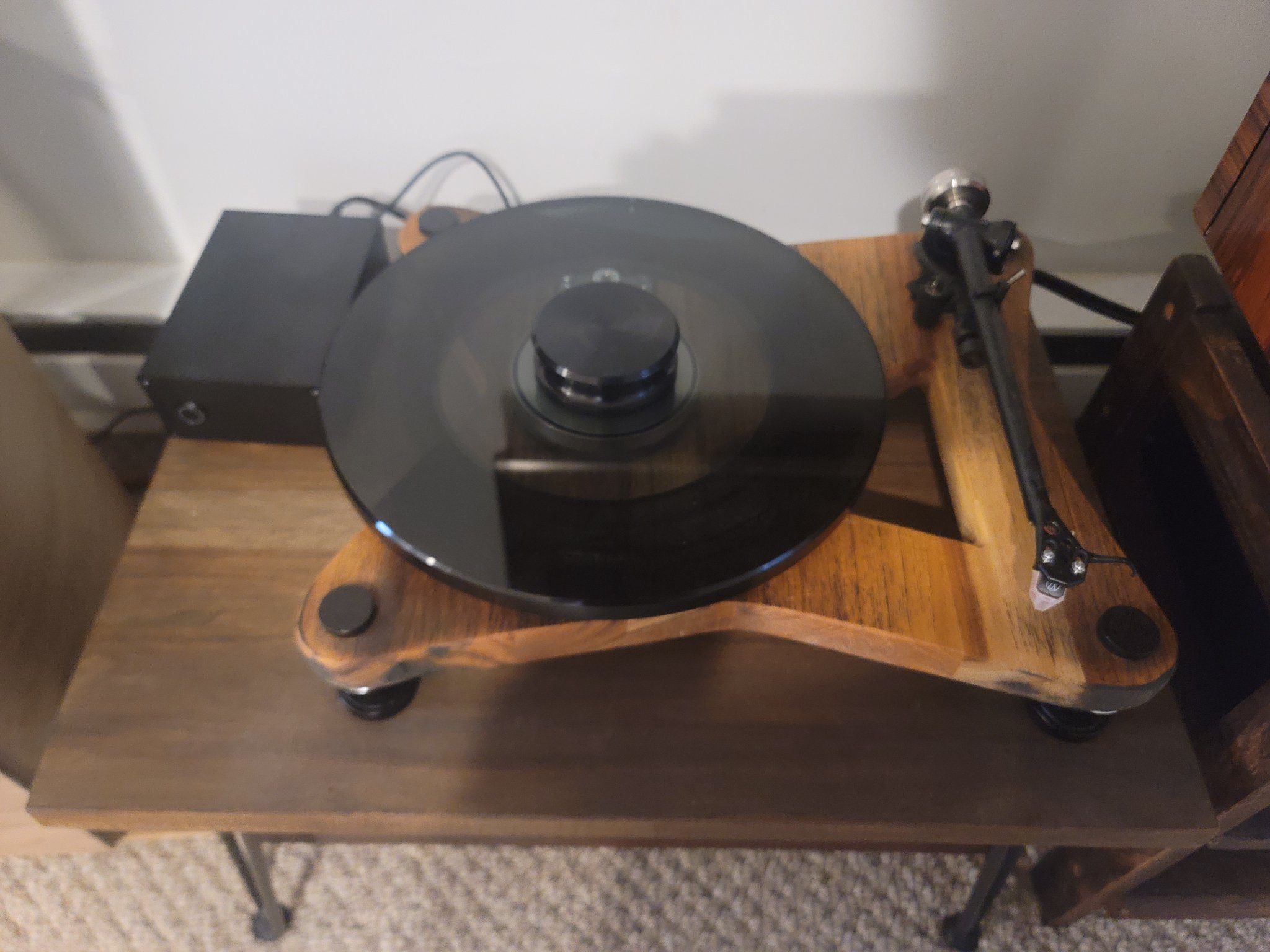

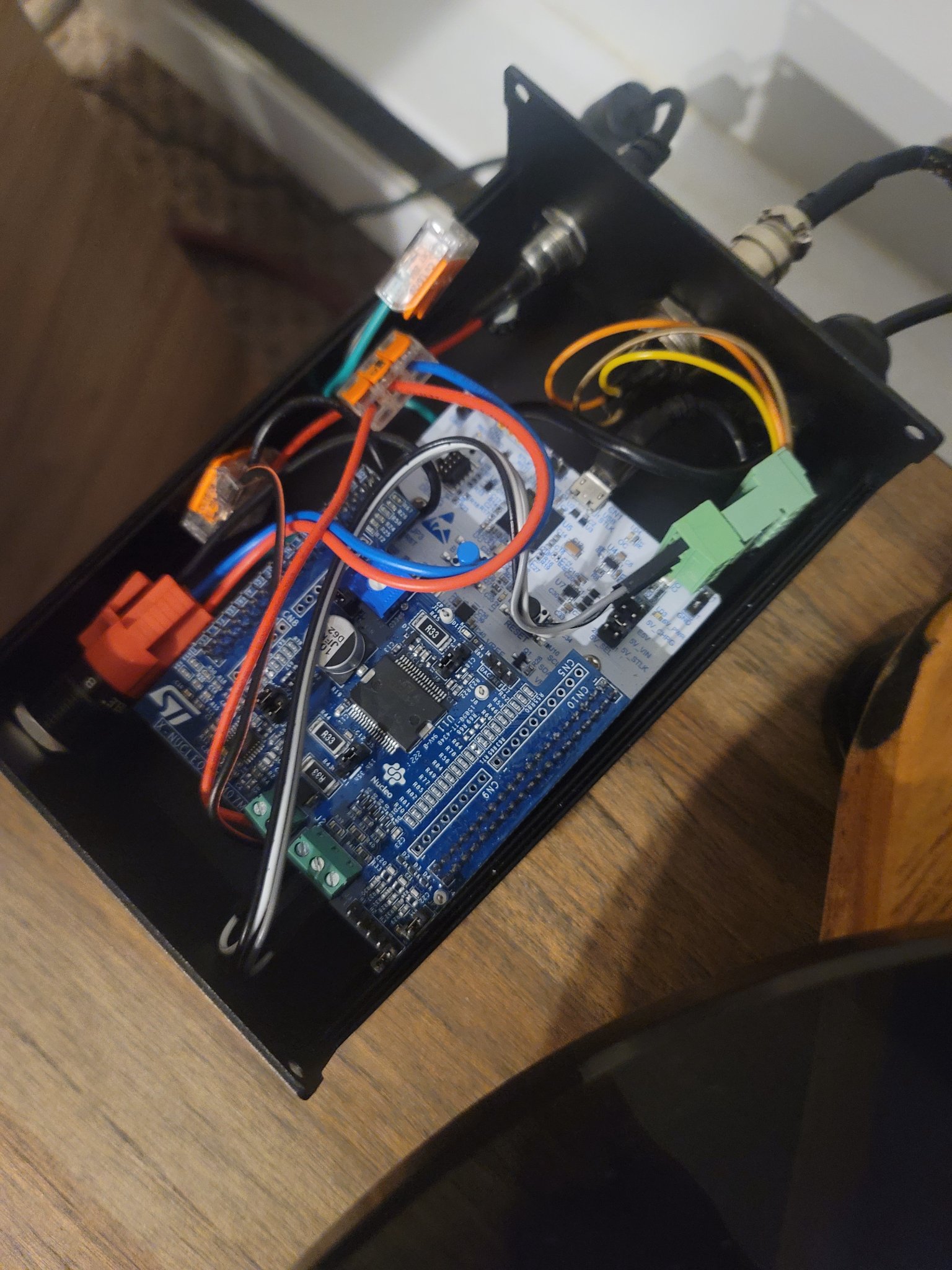

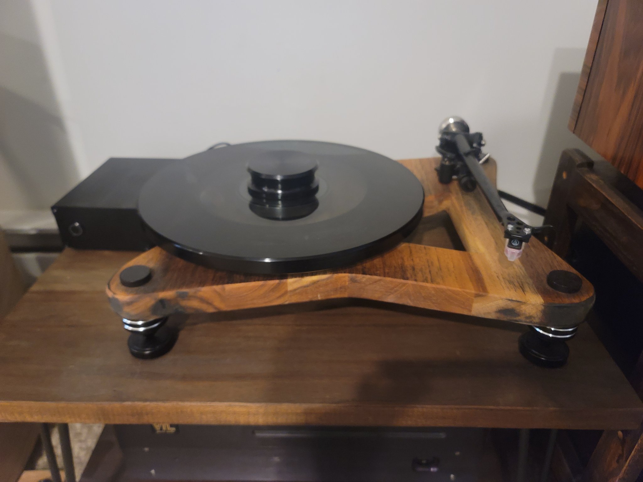

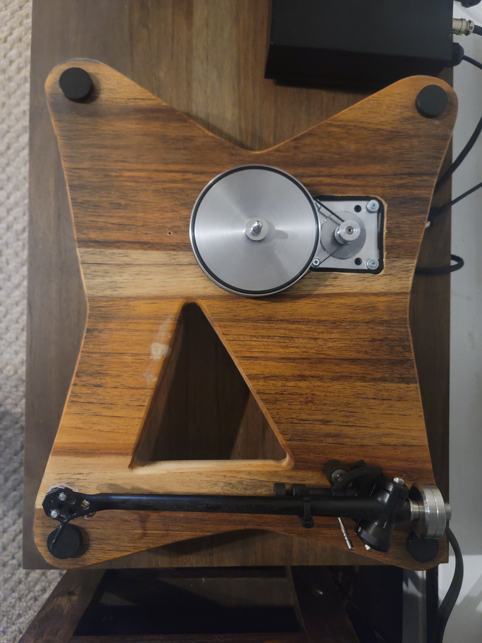

I built my own table from a Rega 303 arm, Rega 6 glass platter. TangoSpinner subplatter. Motor is a 3-phase BLDC 12V NEMA23 style motor from Anaheim Automation. And motor power supply is a 3-phase sine wave generator base on a ST Micro microcontroller and motor driver daughterboard.
Yes. I started with round belts, but did not like them. They had too much rid up and down the subplatter, especially the silicone ones.Looks like you're using a flat belt
I got vastly better performance out of flat belts. Because I have my own motor controller, I can easily adjust the speed for whatever pulley/belt combo gave me the best performance. Flat bets have better grip on the subplatter.
I am also planning to build an outboard motor setup. I have a couple additional BLDC motors, including a 24pole gimbal motor with an encoder, so I can try closed loop speed control. That would use a flat belt looped around the platter itself, much like the VPI tables.

the hole size and location for the arm pillar
208 mm IIRC, ¾” hole(?)

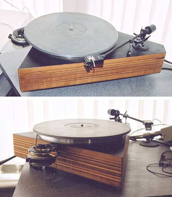

I really like the Rega, i have a modded Rega 2 with a Linn Back arm. If i won the lottery i would get one of the hi-end Rega.
The philosophy into keep the connection between bearing and tonearm shoud be really rigid, and the base shoud be really low mass for minimum energynstorage. Be creative.
This Connisuer BD1 project might provide some inspiration.

Standard Rega arm mounting has always been 222mm. Pretty handy as a Grace 707 is pretty much the same. The template I linked to says clearance for 23mm for the arm pillar.208 mm IIRC, ¾” hole(?)

Yep. Drill a hole for the subplatter (size depends on the subplatter bearing, mine was 17mm ). Measure 222mm away, and drill another hole, 24mm, for the arm. Thats it.Standard Rega arm mounting has always been 222mm.
Thanks for this Jeff, but I was looking for the dimensions of the overall shape of the P8 (P10) baseAssuming you mean the hole size and location for the arm pillar, I found an old template file: https://web.archive.org/web/20100524135329/http://www.audiomods.co.uk/mountingTemplate.pdf
jeff
Geordie
Highly unlikely you'll find a drawing. Maybe borrow one and reverse engineer it.I was looking for the dimensions of the overall shape of the P8 (P10) base
jeff
