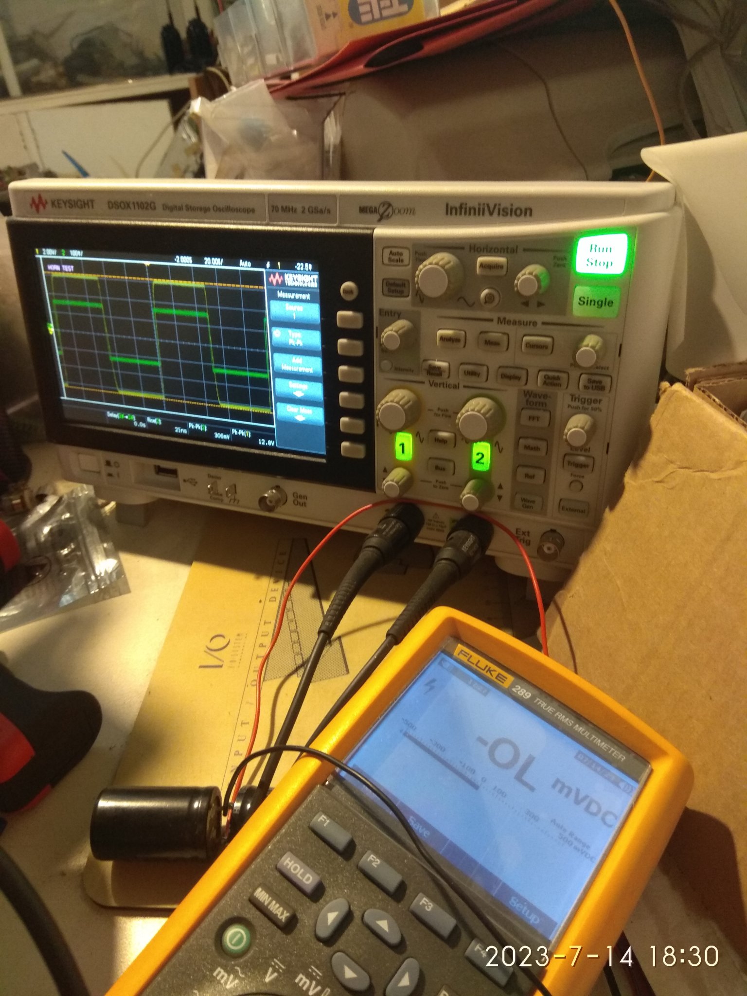

I've investigated a bit further: when increasing volume, the multimeter in manual 300mV range shows a quickly rising voltage until it overloads. In the manual 3V range however, the multimeter shows a constant 0.007V. Wondering if there is an explanation for the different readings in 300mV and 3V ranges and if this could point to a potential fault.
I still believe this DVM phenomenon is a culprit. Use the 3V range or higher for your offset measurements or use a filter in front of meter to suppress AC overload of meter.
Hi krais23,
I remain convinced that 7mVDC reading you observed using the 3V range on your meter is probably accurate and that the 300mV range can't be trusted because of AC overload. I can't imagine any other explanation for the change in meter behavior with change of range.

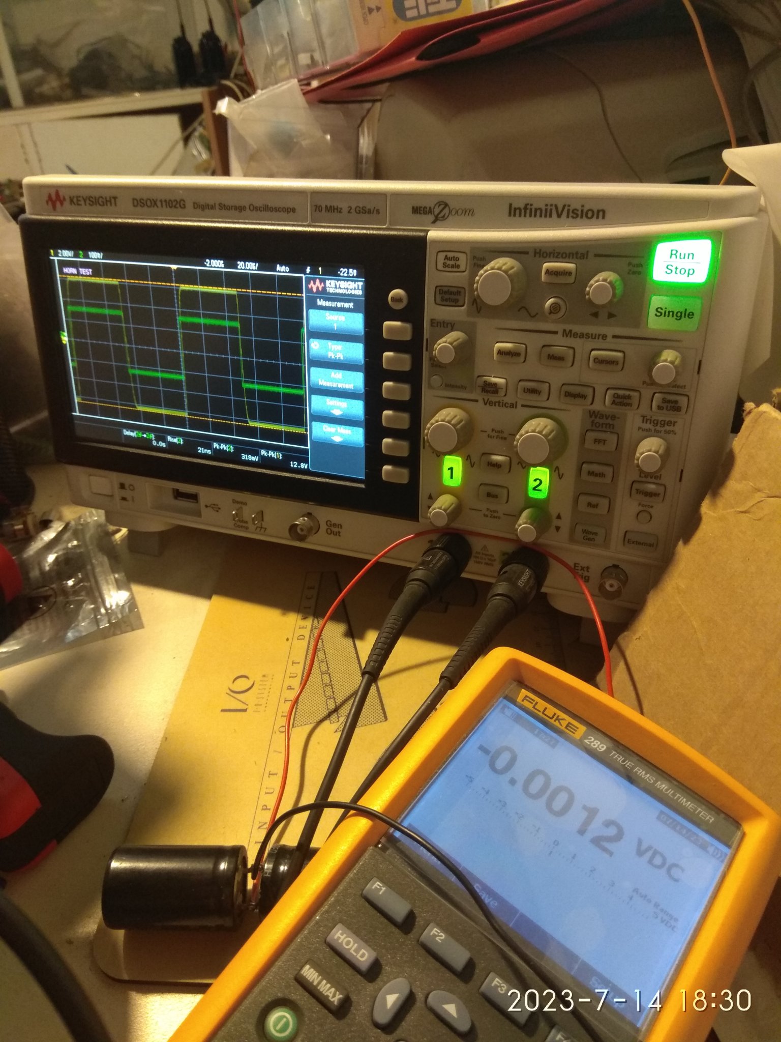

Have a look here.
Both photos with same signal attached at the input but different D.C scals in DMM.
I the first photo DMM overloaded at mV scale.
In the second one at 50v scale offset is 1.2 mV.

The power supply ripple is probably within normal range.
The concerning thing is that the DC offet rises with volume which suggests that DC is passing through the volume control and input caps. Does the offset rise without any signal when you turn the volume up and down?
If it's affecting both channels, then maybe there's some kind of short or leakage between the two channels? Is there any dried glue on the PCB that could have become conductive?
Another thing worth doing is either taking the amp to another location without possible RF interference and see if that changes anything. Or put some severe input filtering in place to block any RF coming in and then re-measure.
Could also try increasing the frequency compensation to see if that changes things. Maybe these amps have too much bandwidth.
