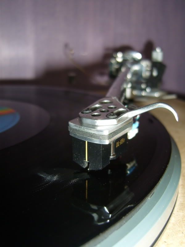

I use a DL103R on a Rega 250 arm, that is until I built an Audiomods arm. You need to add some weight to help with the low compliance of the cartridge. Thus -
Re-body the Denon with an aluminium or wooden body and you've got a giant killing front end! My new body is in the post as a type.

If you mean the replacement body the only mod is to the cartridge. There is some good details here on the Lenco web site.
Having started with a Rega RB250 arm and the Denon 103R, the Audiomods arm was a significant move up sound wise. It certainly extracts the best out of the cartridge (and is probably capable of using a high-end cartridge). My main concern over the Denon is that its dynamics are not in the same league as say a Lyra cartridge but this is an unfair comparison as the Denon is 1/3 the price! Word on the street is that the metal body should overcome this. The manufacture Zu supply a similar product with the cartridge already fitted.
If you are interested, the turntable I have made is here. There is more comments there on components than I have time to repeat here! One final point, the Denon is the first cartridge I have had to set up (I used a linear track TT with a plug and play cartridge before). I would say that the Denon is a good cartridge to start with as it is forgiving with the finer points of setting up. This view point may be due to my limited knowledge but if the sound I'm getting is anything to go by, I don't think so!
