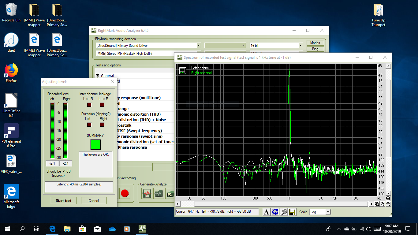

Sweep the frequency response to see how large the error is. But _IMHO_ this is a great garage amp, not a primary listening-room amp.

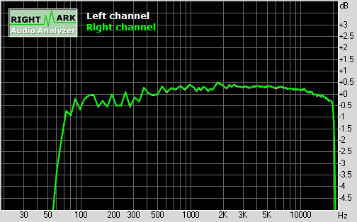

Or perform a loopback test using RMAA via the headphone out (careful with volume, you don't want to be toasting your soundcard input!). In the results, pay special attention to both frequency response and channel separation. (Could be a bad ground connection somewhere, too.)
Since my knowledge in electronics is very basic and I don't own any pro equipment i took a chance at this idea. I just did the loop back test via the tape monitor.
As I see from the result it rolls off quickly below 1khz. On the other hand the THD is at 0,0041, not bad for 42 year "garage amp" :cheerful:
Will replacing the ceramic capacitors around the tone controls help here?
Here is the result with the tone controls in the middle position and no loudness used:
Congratulations, you just failed the null test.
The tape loop usually contains no more than a few switch contacts and passives. It is as such unsuited to test the frequency response of the amplifier. It should also give near-perfect test results for the same reason.
Your playback/recording setup clearly still has some issues. Make sure that any and all processing on the playback and record side is disabled (effects, noise reduction, whatever), that the sample rates are set up correctly and identically everywhere, and that you are not mixing What You Hear with line-in or somesuch.
I have seen such "wiggles" in FR when some sort of effects was still enabled.

I would not trust his measurement setup as far as I can throw it at this point.
I am aware that the measurementsI took might not be precise, aldough I took all the filters and sound effects before taking them.
There must be something still amiss. Frequency response must look super smooth, not like a ragged mess, and it would be quite unlikely to drop off like a rock below 100 Hz. What do you use for a sound device? Could you perhaps make screenshots of the playback and recording devices' relevant properties pages (Alt + PrintScreen)? This is one of those situations where I'd probably have it sorted out fairly quickly if I were to be sitting in front of the computer. (If you really can't get it sorted, this might be a case for good ol' TeamViewer.)

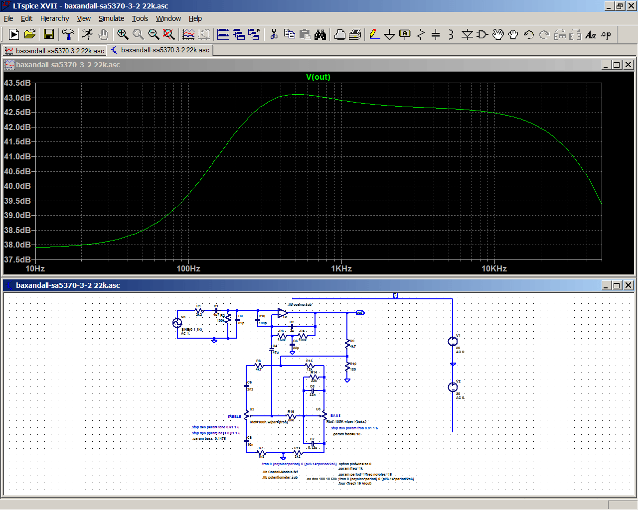

Yesterday evening, while taking a look at the tone control resistors, I noticed that almost all of them were off the specs by margin bigger than the suggested +- 10% . Could this be the source of the tonal unbalance? Do the carbon resistors degrade with time?
Well I think I found the problem.
I measured again all the resistors from R505 to 516.
R505/6 are 10k in place of 12k (a bit under the secs. margin )
R513/14 measured 22k instead 120k, and this is probably manufacturing mistake than degraded resistor.
The rest of the resistors are in the margin of -10% but slightly inconsistent between the channels.
Anyway I'm gonna replace all the caps and resistors around the tone controls and see if this will solve the unbalanced tone.

I'd be suspicious of that 22K resistor before removing it by checking its soldering against the other parts on that tone board.
Wisdom and age may be on to something. 😉

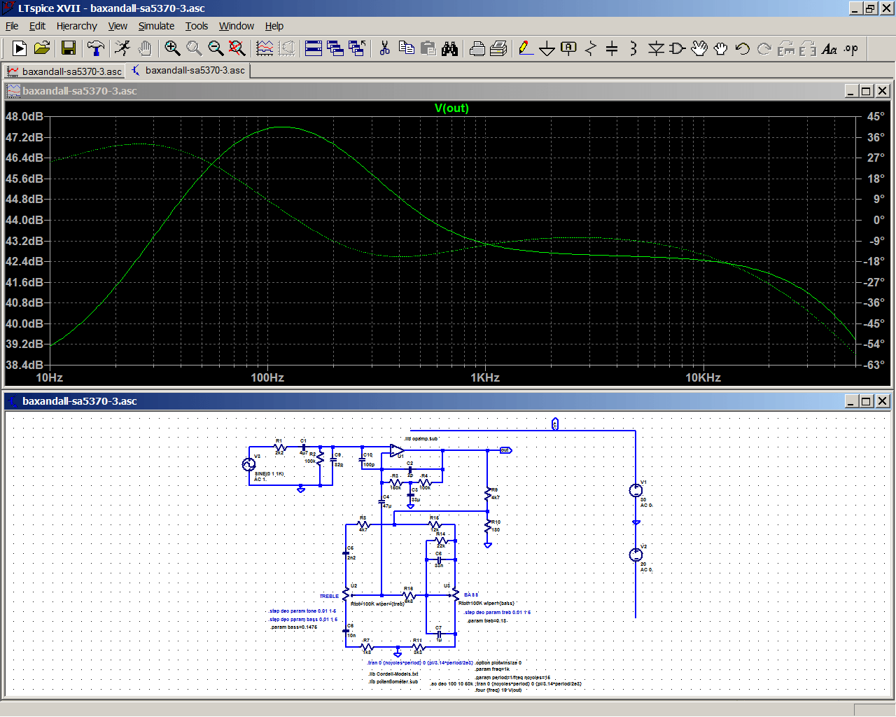

This is what would happen if you took the pot setting that gives a flat response with 120k and put in 22k instead:
attachment.php
Looks very much like the OP's problem, I'd say.
Substituting the 0.12µ for a 1µ then yields this:
attachment.php
Erm... that's too much, dude.
The only reason for putting in a 22k that I can think of is that someone had to replace the bass pot. (Do bass and treble pots look different?) This is a 2x 100k reverse log pot (100kC), and optimum FR flatness occurs at a wiper setting of about 0.1475 in "normal log" terms, or -16.62 dB. I don't know much about antilogs, but from what I've seen of normal log pot measurements, midpoints tended to be around -26 dB, or 0.05. Guess where the flat position with the 22k is? Yep, 0.05.
Still, it should have worked like this. Maybe they did put in the wrong resistors at the factory after all? Otherwise, why would someone even touch these? Putting in modern metal film resistors? They don't look like modern-day blue 1% Yageos, do they?
Anyway, I got maximum flatness with stock values at slightly different settings for bass and treble - 0.1475 on the bass and 0.18 on the treble. You should be able to measure that - 14.75k in parallel with C505, and 18k between C501(-) and C509.
