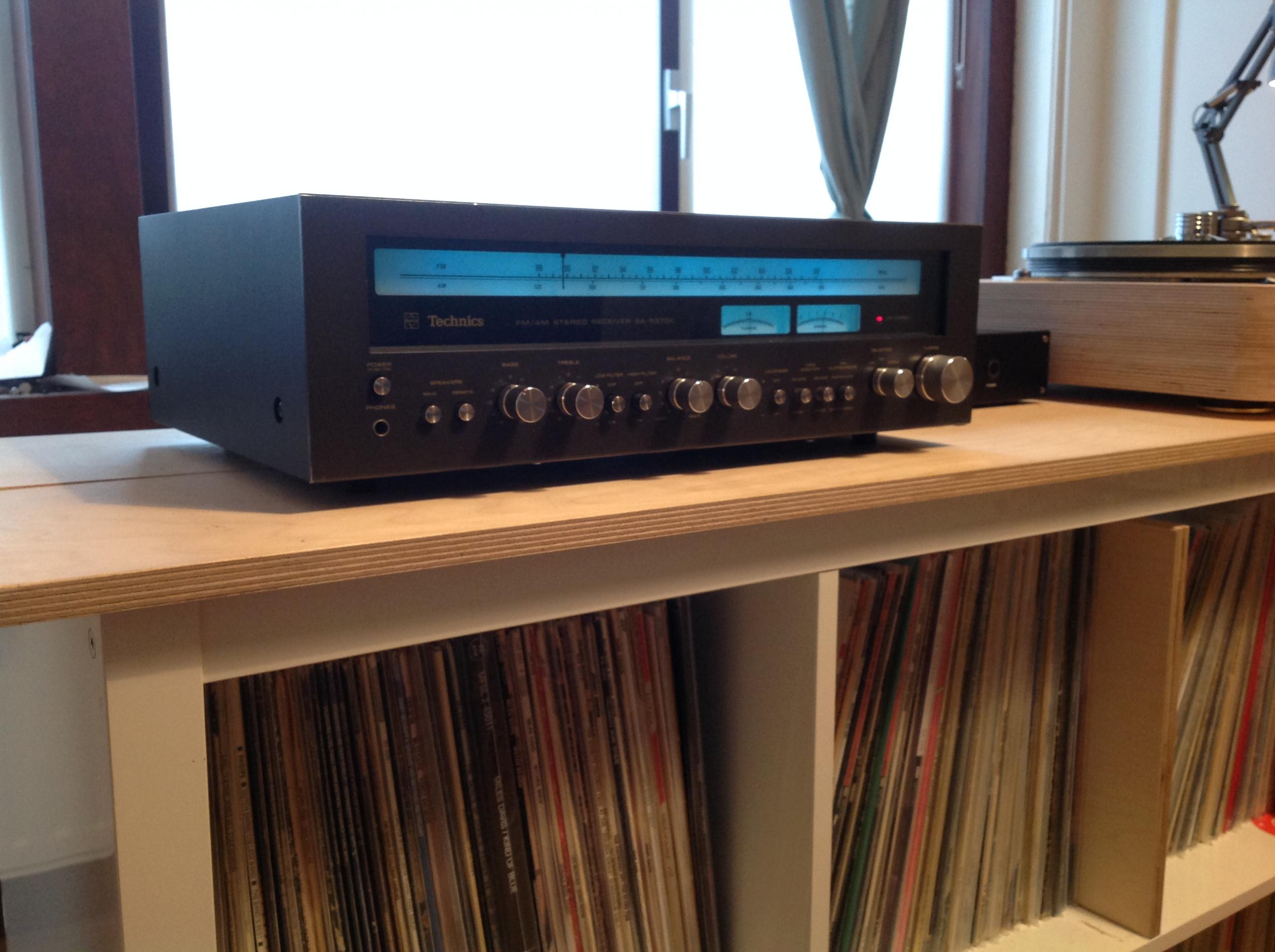

Finally found some time to leave a feedback on the now completely refurbished SA5370.
As I mentioned I replaced R505/6 and R513/4 which were showing bigger discrepancies than the marge of 10% and all the polyester tone controls capacitors with 5% Panasonic metalized polypropylens.
While changing the resistors a weird thing happened. R513/4 were original resistors which wile on board were measuring 22k but when I took them out they were measuring their original 120k. Is anybody familiar with this kind of phenomenon, because I am not. Did the old soldering caused such behavior or did the original resistance got reactivated by the application of heat?
How ever they are now replaced, and as it appears the amps tonal balance is back to its original curve.
At this point I was happy with the development of the project. The next day I also replaced the old rectifier with four 15A Fairchild "stealth" technology (fast switching, soft recovery) diodes. The tonal change after this replacement at first wasn't huge but I immediately noticed that all the sharp edges around the midrange and high frequencies were gone.
Now after a 10 days and and close to 100 work hours I feel that the receiver is still settling in but the the sound it produces has taken its final form in very pleasant way.
In order to have a reference I took out from the basement the Marantz 2238 that also waits for its turn to get reconditioned (in generally it's very bad condition discourages me every time to make the first step) .
In generally the Marantz is heavier mostly because of its chassis and trafo which actually isn't bigger than the one in the SA but it has a big metal shielding around it. The Technics is engendered in very smart and economical way in terms of space and costs. One example of this is that the shealding to its trafo is provided by the chassis bracing and by one of the transistor cooling bodies on the other side. The top cover on the Technics is nice and made of plywood and the bottom cover is made of cheep thin pressboard (which I replaced with 4mm HPL for extra weight and stability) whereas on the Marantz boath are metal.
Other essential differences between these two receivers is that the Technics , in contrary to 2238, is direct coupled and all the electronics lay on two PCBs whereas in the the Marantz the PSU, preamp, phono, tuner and main amp are partitioned on different PCBs.
Qua features, I find the tuner sections equally good, just the SA doesn't have a Dolby filter and the stations airing in Dolby will sound brighter (I use the luidness buton as compensation in such cases ) . Where the 2238 also excels is the tone controls, it's midrange is also controllable whereas the Technics has only controls for the bass and the treble.
Sound wise in their original state they are very different. The SA is lean, transparent generally on the bright side of the neutral with very good resolution. The Marantz tends to sound on the warm side also transparent but with a lot more texture and less resolution.
When I started refurbishing the Technics my goal was to tilt its sound signature towards the wormer side, to add some texture but to retain its transparency and resolution. I think I achieved this by the combination of using a mix of Elna silmic II and Nichicon FG electrolytics ( for C902 a used a Nichicon muse bipolar bypassed with a Vishay MKP 18370.01uf ), Polypropylene capacitors for the tone controls and the rectifier replacement.
Now the tonal balance of the SA 5370 is almost on pair with the 2238. The used combination of parts adds some smooth texture in the midrange that wasn't there before. The soundstage is now darker but still very transparent and the resolution stayed unchanged.
One last change I made is replacing the old type lights with some LED type. This reduced the heat in the insides a lot.
All in all I would say "mission accomplished" and therefore I thank all of you guys for sharing your thoughts regarding my tonal balance problem.
