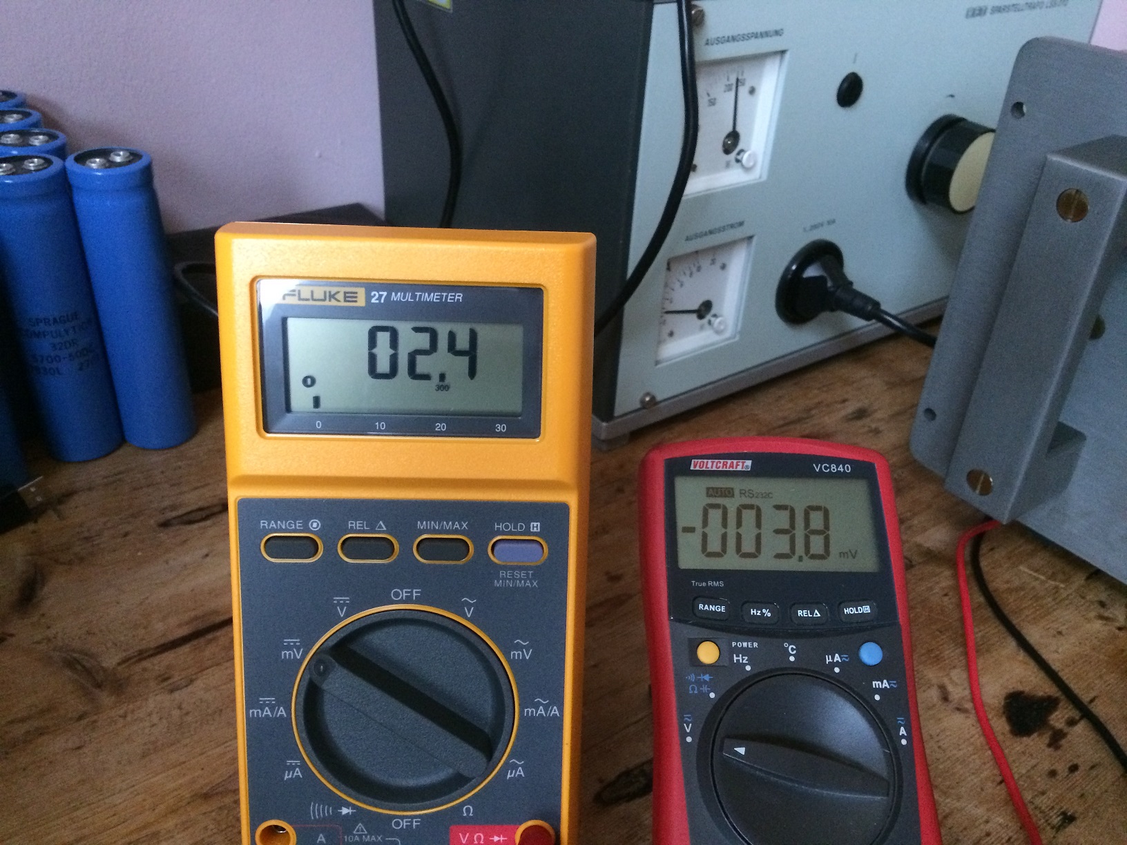

Just finished calibrating my newly acquired Krell KSA-100 Mk 2.
Bias: 560 mV over the 1 Ohm emmiters.
Drawing from the 220 Volt AC line: 3 amps.
DC Offset 135 mV left channel 85 mV right channel.
With DC Offset trimmers (hardly reachable and hard to find) I could get +/-1.5 mV when fully warmed up.
Unit is completely original and very clean inside.
Datecode on Spragues is week 52 year:1986
Any idea why the DC Offset has increased over the 30 years of servicelife?
Maybe components that age and the heat that makes them drift?
http://www.diyaudio.com/forums/attachment.php?attachmentid=595542&stc=1&d=1485771281
did you check input offset?
Did you set the output offset with the input shorted?
Did the output offset change when you connected a source?
The output offset may have been adjusted to suit a source that had an output offset of the opposite polarity. That's the downside of using DC coupling. The output offset can wander all over the range.
No source connected
No, wil do that.
No source connected yet will connect pre-amp today which I will check before for any offset.
Okay, understood.
You really need some form of monitoring of offset and an alarm, or automated protection.
How? I'm not a technician, with a highquality cap somewhere or outputtransformer :)
AC coupling automatically blocks input offset AND sets the DC gain to ~0dB.
That combination results in an output offset that varies little and does not vary with the Source, nor vol pot setting. A nice "no thinking" set up that is nearly speaker safe.
DC coupling does not block input offset and sets the DC gain to roughly the same as the AC gain.
This results in an output offset that can vary with temperature and/or with vol pot setting and/or with source selected and/or with Source On/Off.

First I got rid of the 20 & 9 mV's with the inputs shorted.
Then I connected the pre-amp and got rid of any residual DC Offset.
Unit is deadsilent now.
No mechanical hum or over the loudspeakers.
I decreased the bias over the 1 Ohm emitters to 350 mV's
On the 52V rail that's 73 Watts quiescent current.

Does your KSA100 have 8pairs of output devices per channel?
Each pair passes the same current from +ve rail to -ve rail. The bias curent is simply the bias current.
If you have 4pairs of output devices, then the single bias is repeated three more times, giving a total bias = 4 times the single pair bias.
4 * 0.35A = 1.4A total bias.
Maximum ClassA is almost double this: 2*1.4A = ~2.8Apk
Maximum ClassA power = ~2.8Apk² * 8r / 2 = ~31W
the maximum ClassAB Power is Vpk² / Rload / 2
This is likely to be around 160W into 8r0 for a KSA100
Your exactly right there!
That's what the German audiomagazine 'Stereoplay' in March 1986 measured at 8 Ohms with a Krell KSA-100 Mk 2 and 280 Watts at 4 Ohms and 400 Watts at 2 Ohms. Another typical thing they measured was it's soft clipping behaviour starting at 145 Watts and it's almost flat dampingfactor from 172 at 50Hz and still 168 at 10 kHz.
Yes I have 4 pairs of Krell A and AA TO3's (probably selected MJE15003/4 NPN/PNP complementary pairs) outputtransistors per channel.
It drives the Watkins woofers in my old Infinity's QLS wonderfull.
Strange thing though is that this is the first amplifier that doesn't start mechanical humming (transformers) when driving the Watkins and not only the lows are better but also the complete frequencyspectrum has gotten much better.
Thanks again.
