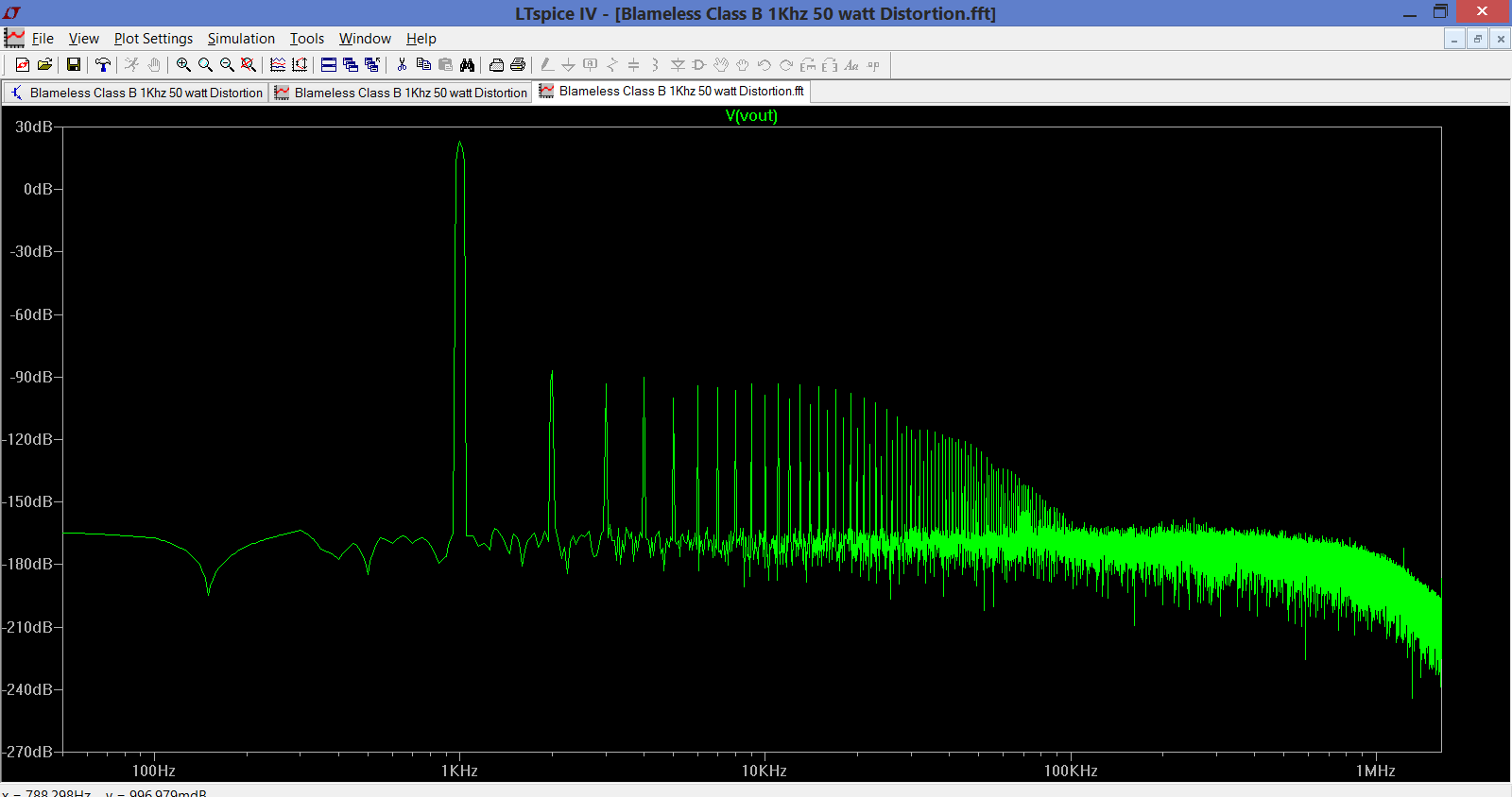

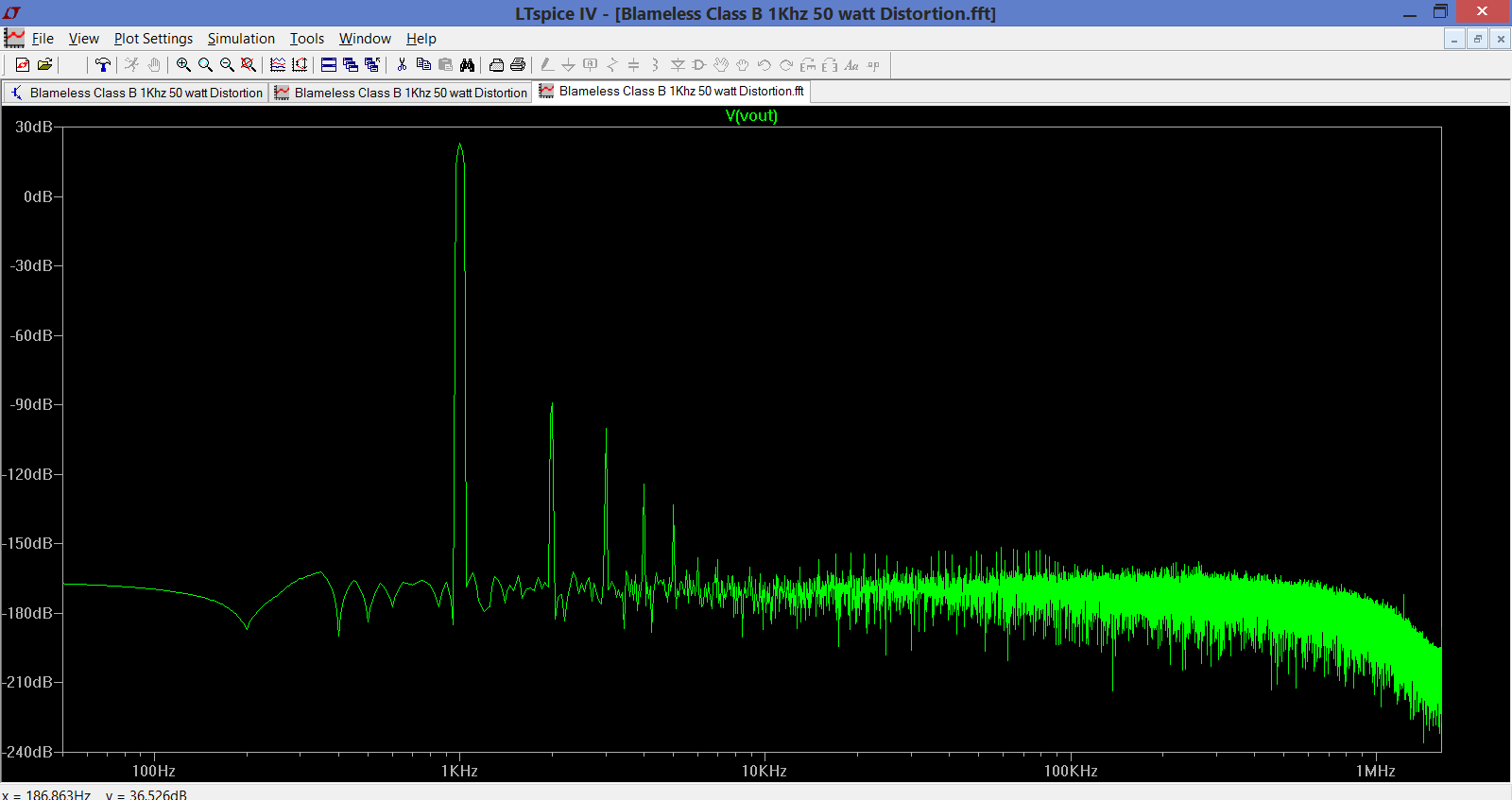

Lets try this with a real amp in a simulator.
A Class AB amp correctly biased (that's only 100ma or so bias) can deliver say 0.0005% distortion at 50 watts RMS/8 ohm. Increase the bias to 2.6 amps (one channel of the amp is now dissipating 200 watts of heat compared to around 8 watts in Class AB) The distortion has now fallen to 0.000268. Both are incredibly small numbers.
Now look at the pictures showing the actual harmonics that make up those numbers. Class AB has the characteristic 'spray' of harmonics that the pure Class A avoids.
Can you tell the difference by listening though.
