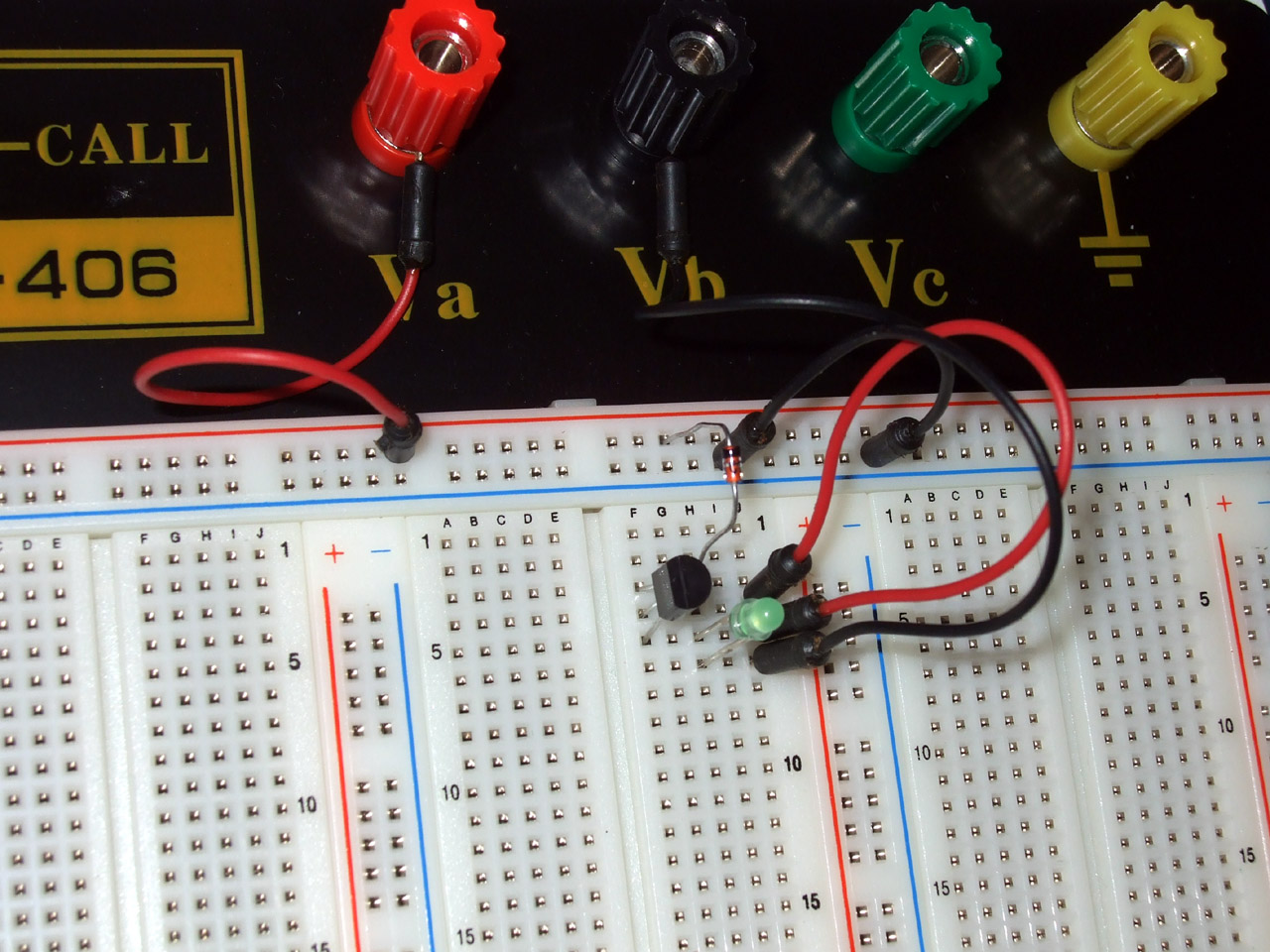

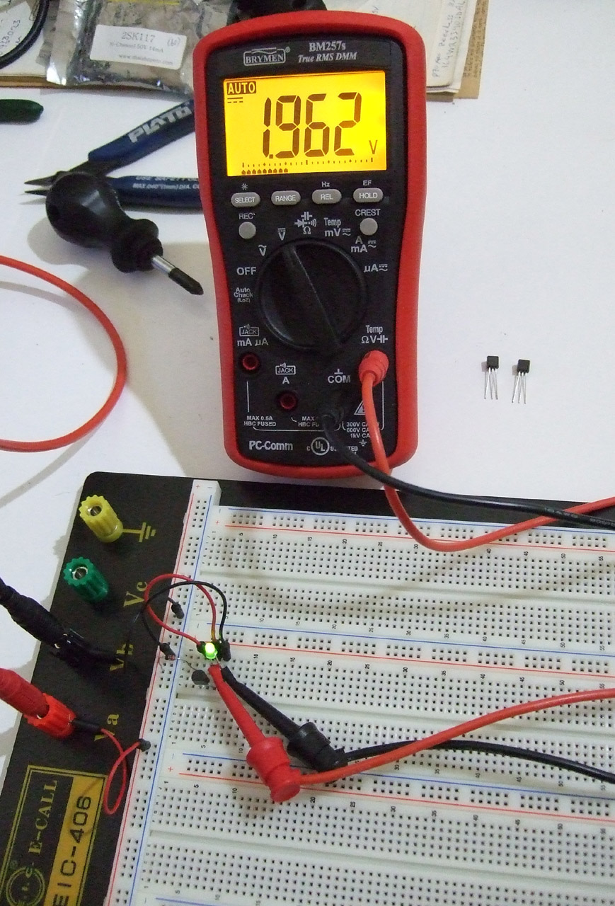

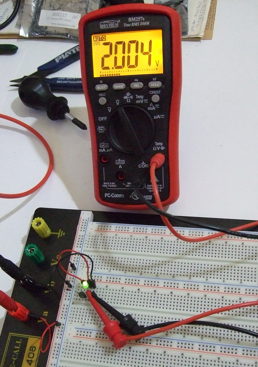

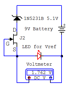

As you have seen there is a simple test jig proposed in the Mini pdf to help predefine Vref components Vf in conjunction with any J2 IDSS at hand. Since the big Ref-D is many times used with J2 also instead of R6 depending on preference I thought it would be nice I explain it a bit more.
What we see in the schematic is a 9V battery, a 5.1V Zener, a J2 2SK117GR JFET with its G & S pins shorted, a Led to test for Led1 or Led2 positions. They are all in line forming a DC loop. A DMM measures the Led's forward voltage drop across it.
By dropping the battery voltage with the Zener to about 4V minus the Led's Vf we come closer to what voltage J2 will see across when in circuit by M2's VGS and to what final IDSS it will produce when there.
In the pictures we see one same green Led that I randomly picked from a no name bag being measured for Vf with two different random J2 in the jig. The difference of Led Vf due to different enough J2s IDSS is evident. A third J2 was resulting much nearer Vf to the first though. That means it had closer IDSS to the first but we don't care to know their IDSS. Even with a single J2 at hand we can just change Leds or add Rx/J/D to reach the voltage we target anyway.
If Leds and jumper only don't make our target and we need add D or Rx for some substantially more Vout or in-between, we test Rx or D in the Led's place also to know what they contribute with our specific J2. But we better avoid adding components when near enough target.
Using the 2.004V Led and a jumper it would give me 3.22V Vout for instance after adding the 1.22V current mirror BJTs standard contribution. I would prefer to look for a stronger green Led so to go nearer 3.3V with just jumper than to seek a small resistor, something like 15R, to see if it can give me 0.08V extra in the jig. Even if I could not find a stronger Led, usually 3.22V will be in spec for any 3.3V chip and I will still avoid the resistor. Less components is simpler Vref. D is preferable to Rx where possible. More predictable.
Since that same J2 will end up in the build we expect the tested Led(s) to encounter its same current and to show the same Vf. With some allowance for practical differences due to various M2 and non exact voltages of course.
So no need to worry about what J2 IDSS characterization to initially pick or to must having more than one.
