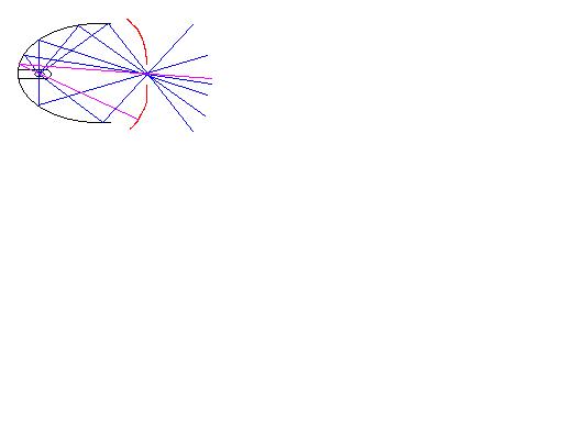

Instead of a spherical reflector, you could make an ellipse: That has two focal points, so the light does not get focussed back into the lamp arc. You could just mill a huge billet on a lathe (or even better a computer-controller milling machine), or you could make a model out of clay and then do a sand-casing of aluminum.

anybody tried this reflector design?
I think you could combine an elliptical reflector with a spherical reflector, to get very high light utilization. In my drawing, the lamp is at one focal point of the black elliptical reflector. The blue rays hit that reflector and then go to the second focal point. The violet ray misses the elliptical reflector, but hits the red spherical reflector, bounces straight back, hits the elliptical reflector, and then goes to the second focal point.
If you size the elliptical reflector correctly, then the expanding cone of light going right from the second focal point fills your lower fresnel perfectly.
Anybody tried something like this?
