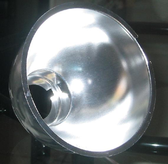

for the reflecter to be used with a hqi its a 30% spehere say like
dia 75 mm and fl 65 mm so any smaller size would also be proportionately smaller but still be a 30% sphere is it?
is there any relation b/t reflecter dia and condenser dia?

I can also suggest that the relationship between the size of the spherical reflector and the condensor lens is that they should cover the same number of radians of arc. Rays that go to the reflector will be sent straight back through the lamp into the condensor. (Assuming you have the lamp placed correctly at the focal point of the reflector!) If the reflector and condensor were both 2" from the lamp, then they should have the same diameter. Or if the reflector is 2" from the lamp and the condensor is 1" from the lamp, then the reflector should have twice the diameter of the condensor lens. Make the reflector too small and the edges of your image will be dim. Make it too big and you won't be able to get the bulb to the focal point.
One advantage of having a large reflector at a longer distance, is that the lamp arc will get reflected more like a point source. So more light will get to the LCD panel pointing in useful directions.

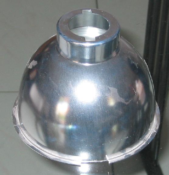

sperical reflecter 52mm dia fl=? , can i find it somehow
a bit small but at 4 usd its worth a try 😉

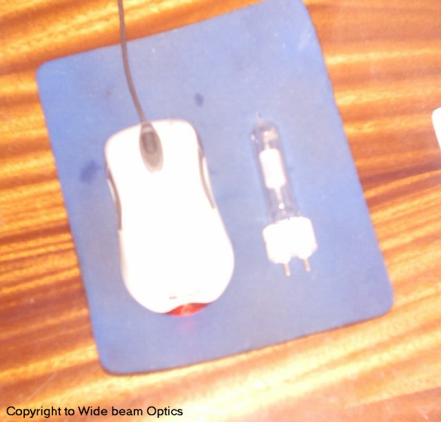

150w hqi-ts with uv filter
wonder how much uv does it stop.
