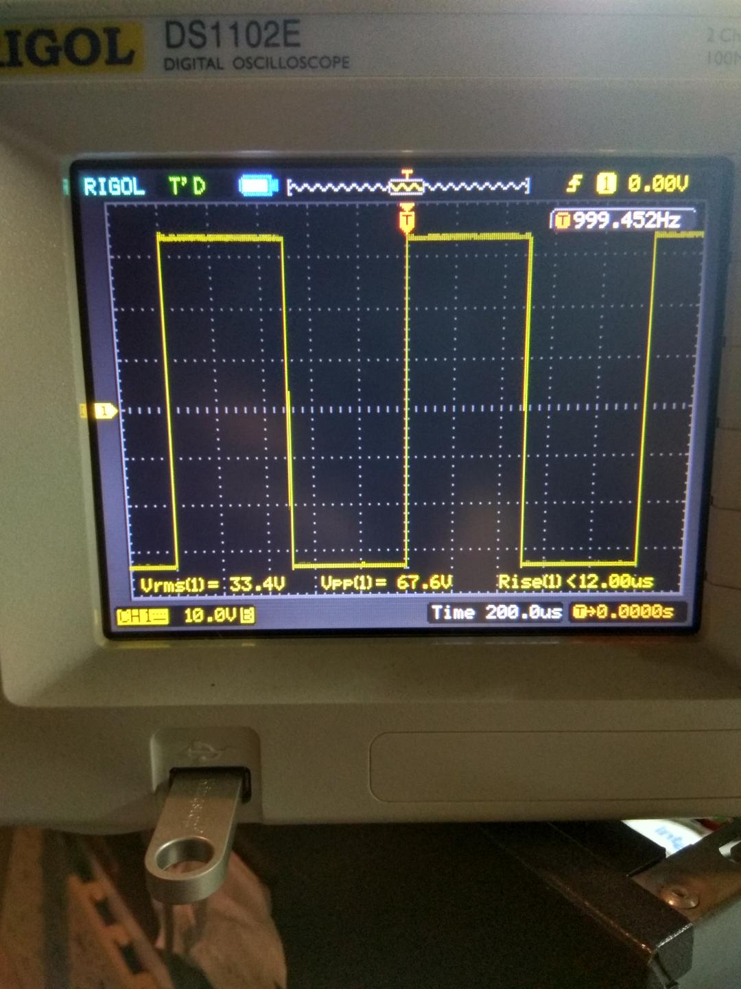

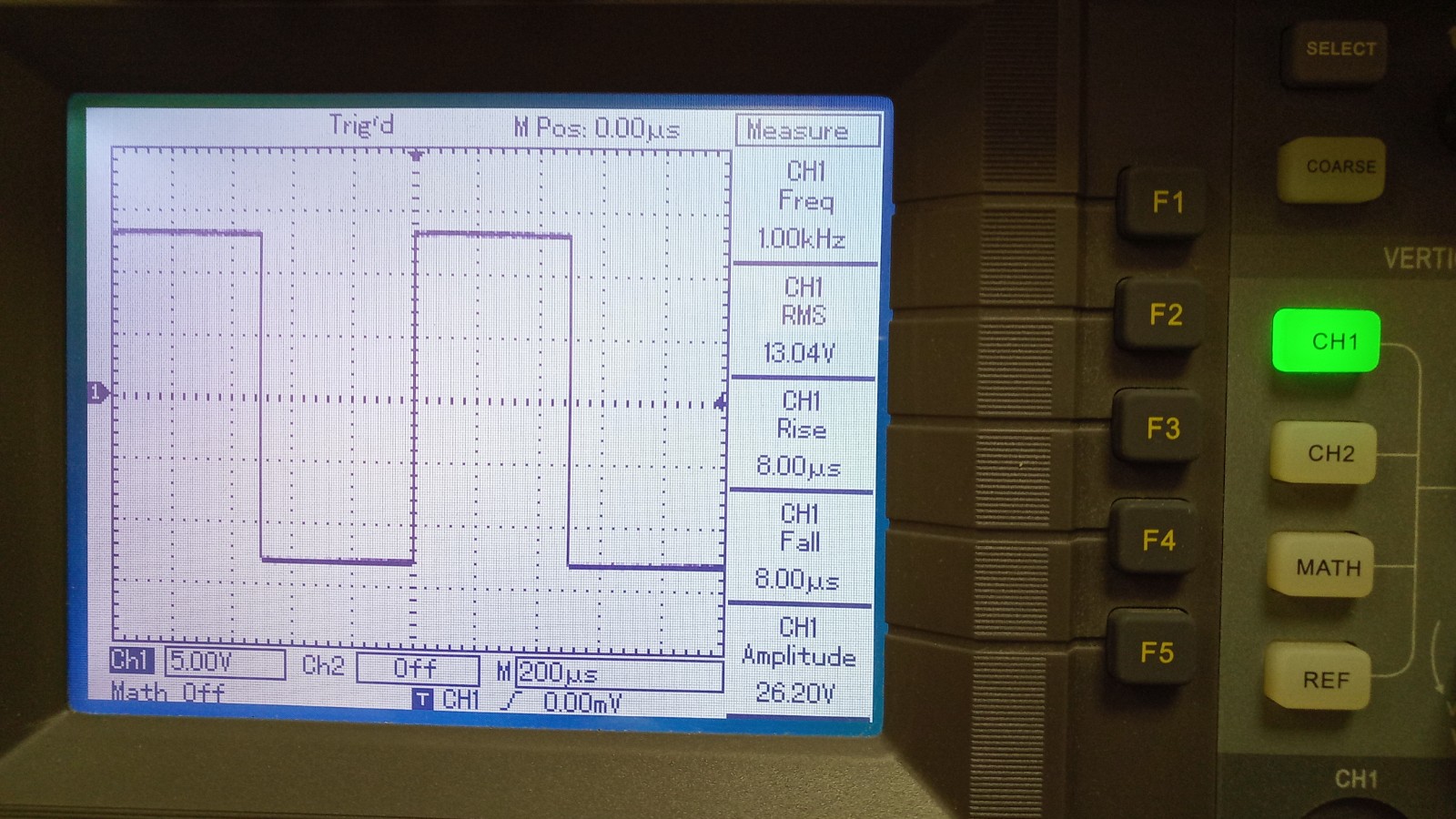

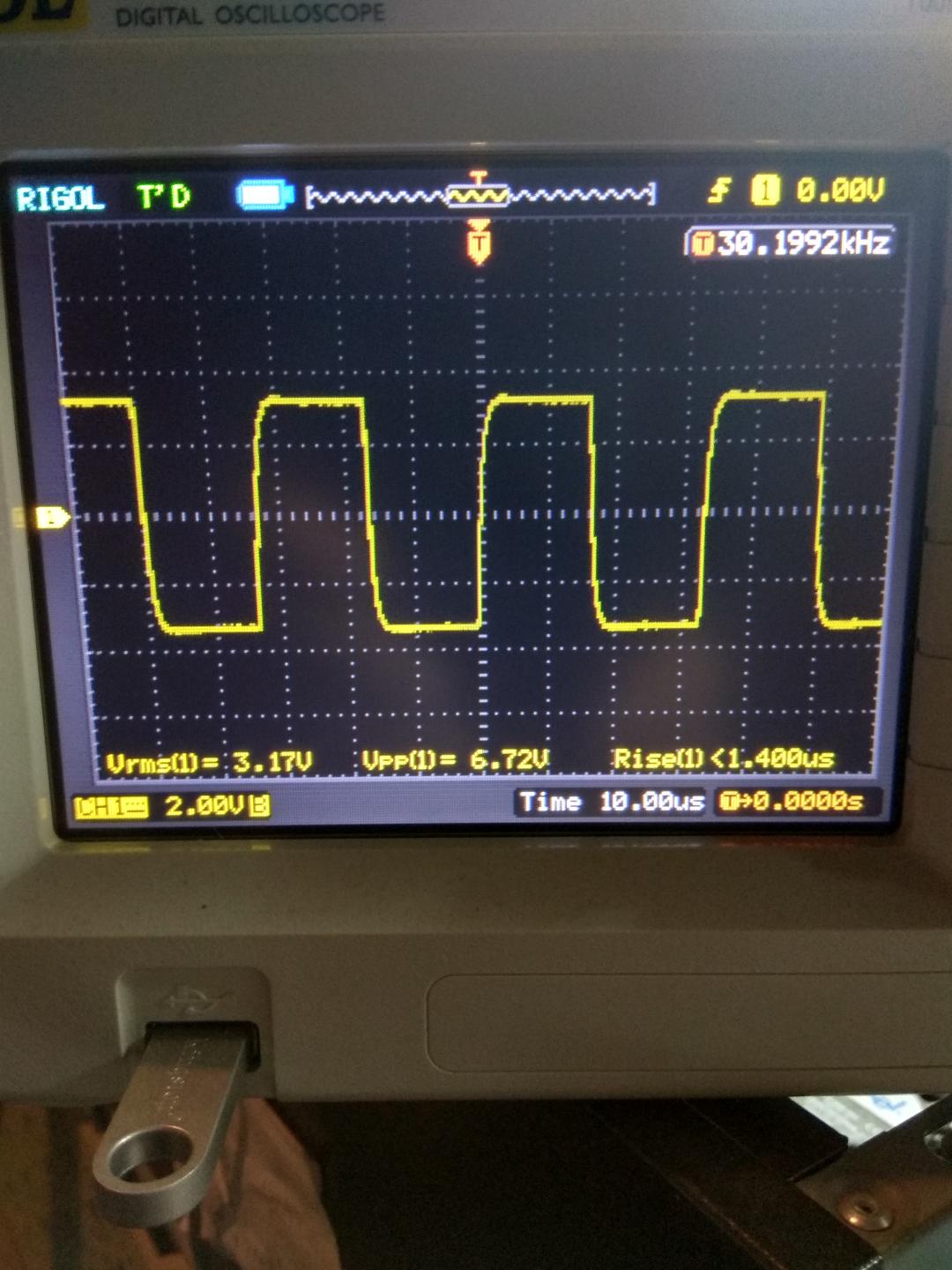

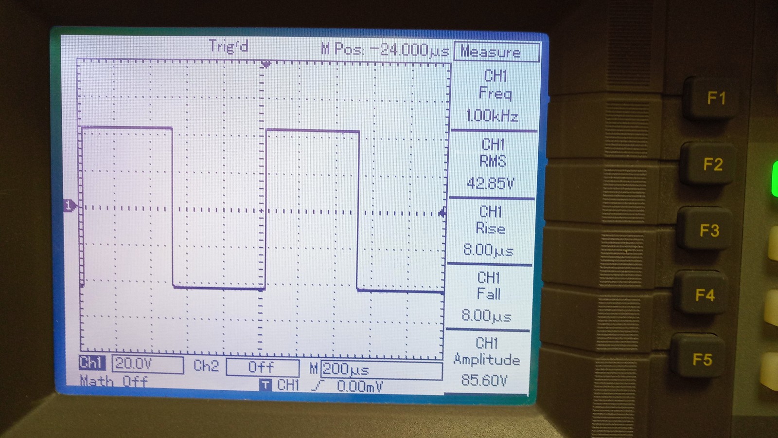

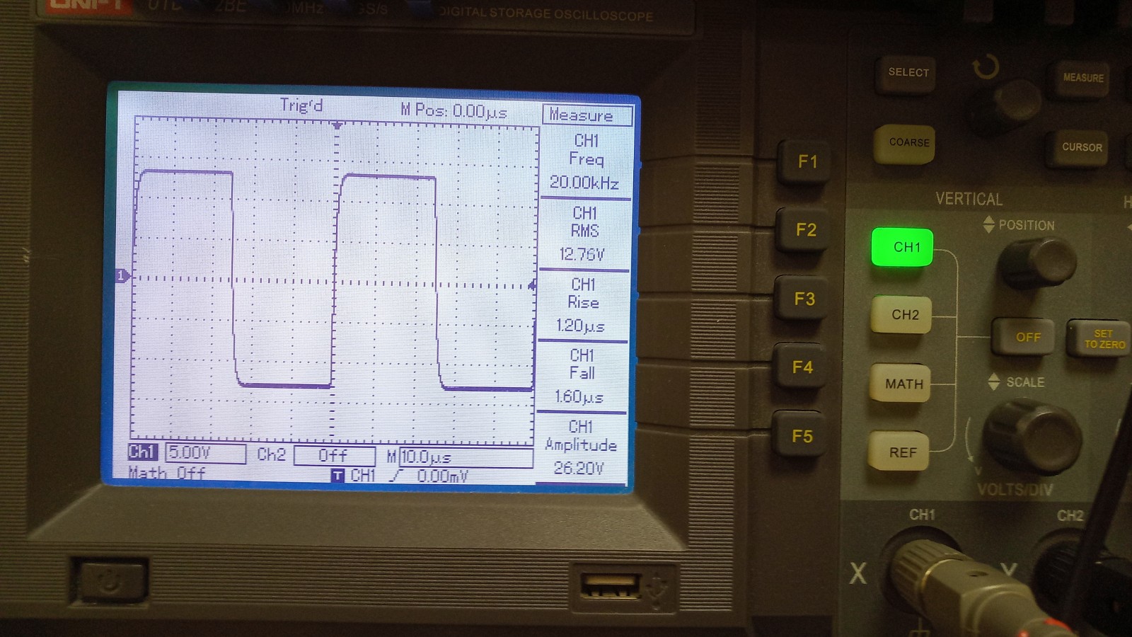

square wave.
Hi Thimios!
Great job as usual. The front-end looks good, especially considering its overall simplicity - 6 transistors in the signal path 😛
It doesn't seem to indicate any stability issues - in line with the simulated loop response analysis.
It would be interesting to know what you think about the sound. I expect rather accurate reproduction - well, especially with this OPS 😀

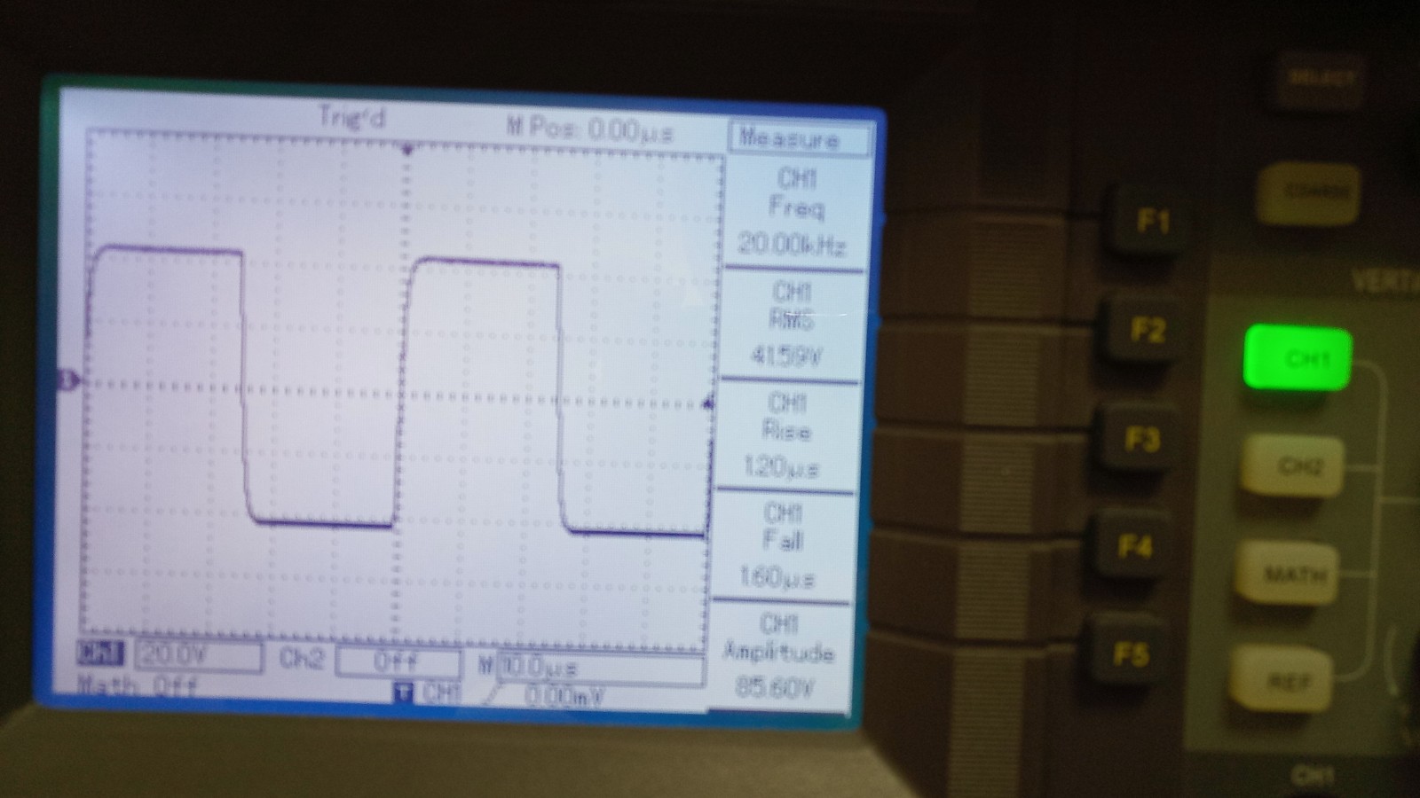

Sorry Jeff no speaker connected yet!
Test patterns first.

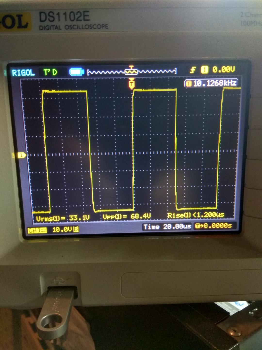

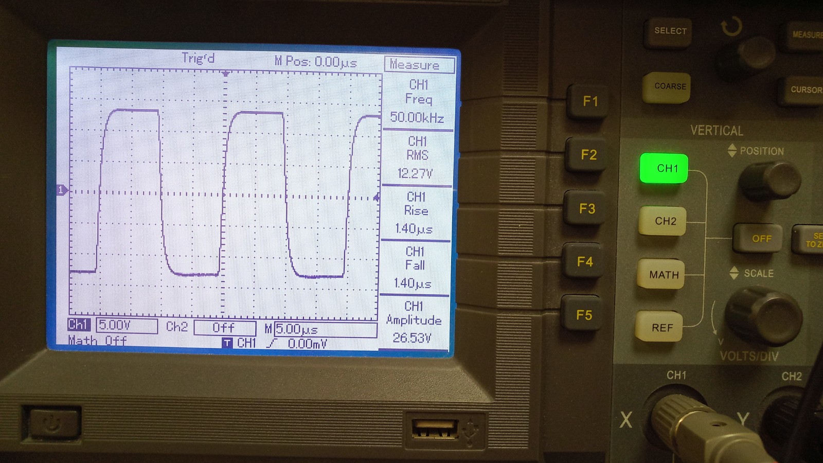

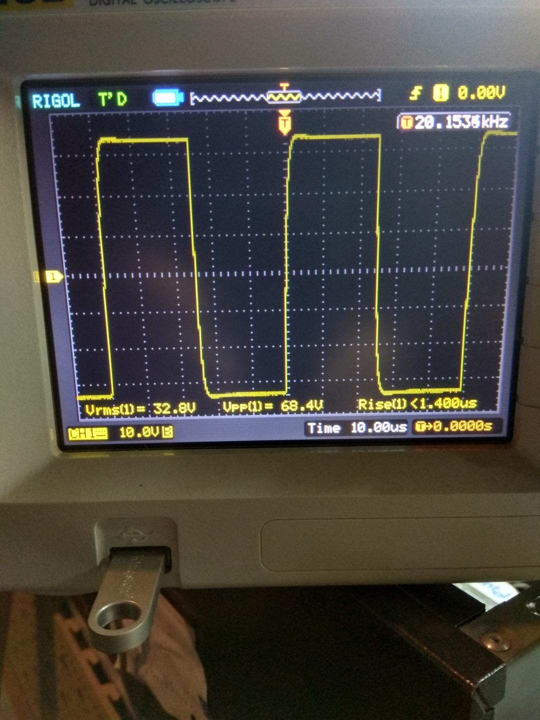

Would you please have a close look at the last pic: What do the sharp edges between the flat and rising/falling parts of the curves mean? May they be interpreted as a sign of oscillation?
Best regards!
Best regards!
Hi Kay,
The last picture is clipping at 20KHz. What you see is a minor "rail sticking" - after clipping, it takes some time for the clipping elements to come back to linear operation. That's why the signal stays at the clipping level for some longer time than expected and then jumps to the right "position" and continues until it clips on the opposite side of the curve.
There is a number of ways to prevent the rail sticking, however, as this design is meant to be as simple as possible, I have left it "as is" for now, especially since the effect is pretty minor.
Nothing to do with oscillation 😉
Valery

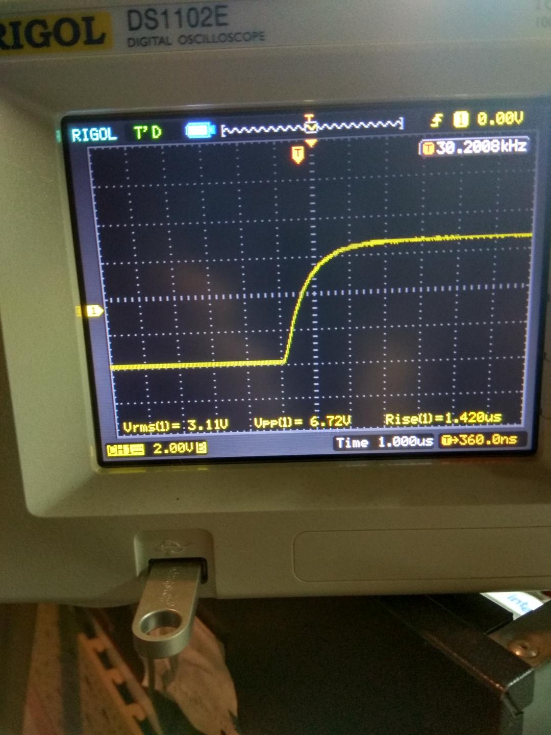

Hi Valery, is it a little overcompensated?
Jeff, is it time for an smd NS compatible version? 😉
Yes, just a little bit, however, it shows around 50V/uS anyway, so I prefer to be on a safe side 😉 If somebody would like to reach perfection in the step response - possible, but it would make sense to perform fine-tuning with particular OPS.

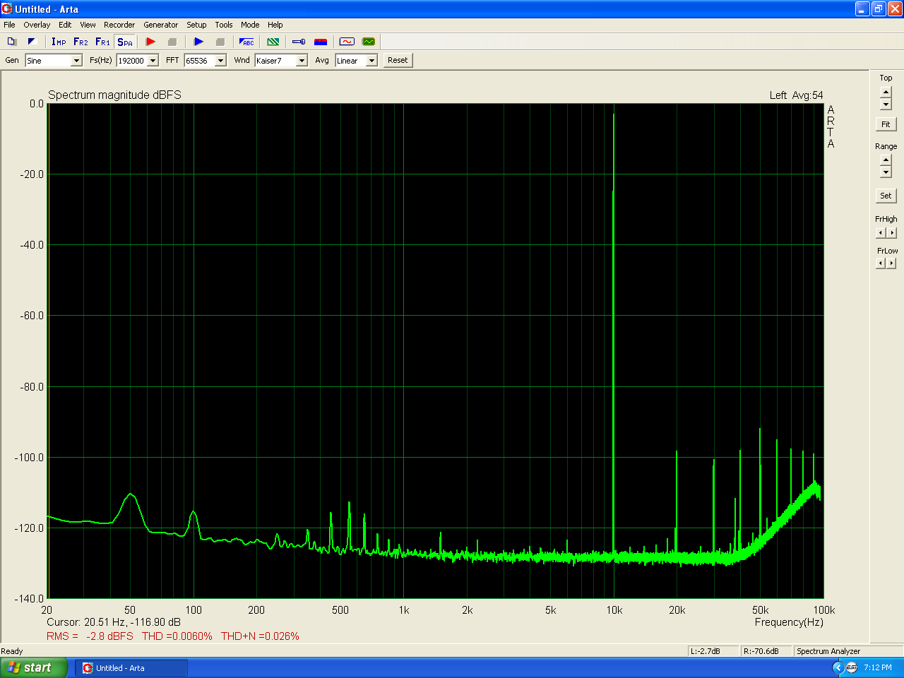

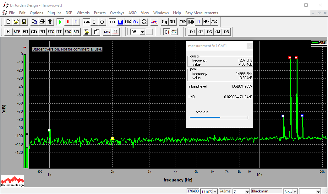

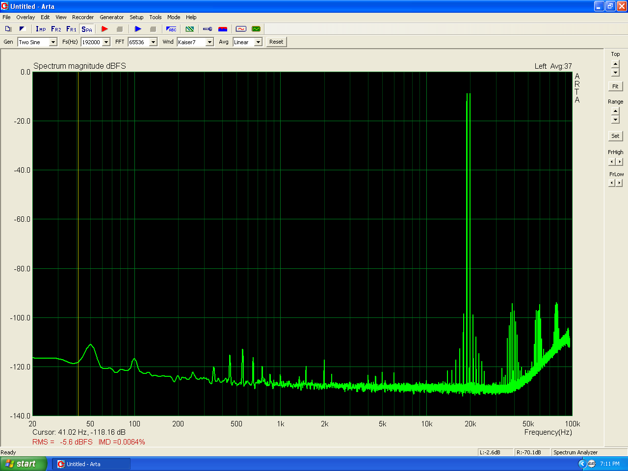

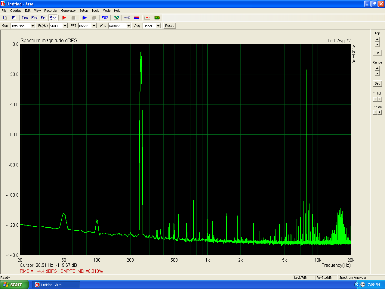

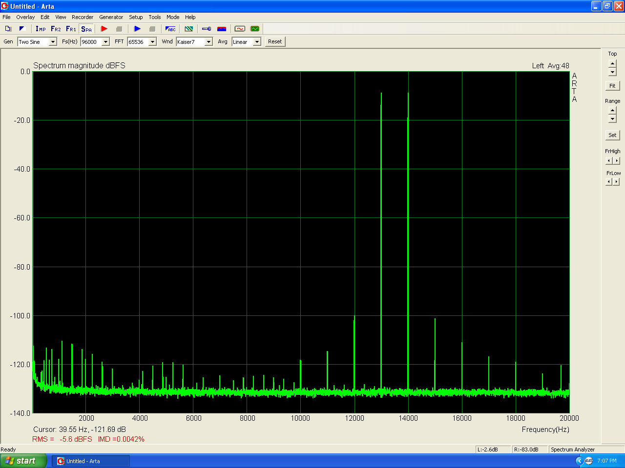

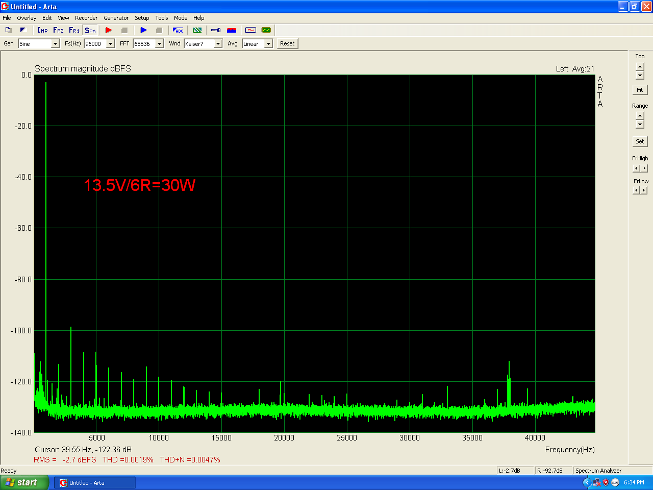

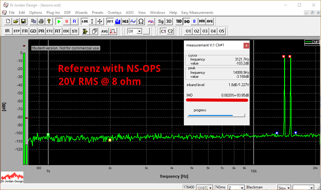

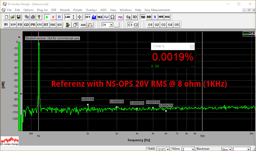

referenz IMD test.
Here are the IMD measurements.
Tested at 30W RMS.
Tested at 30W RMS.

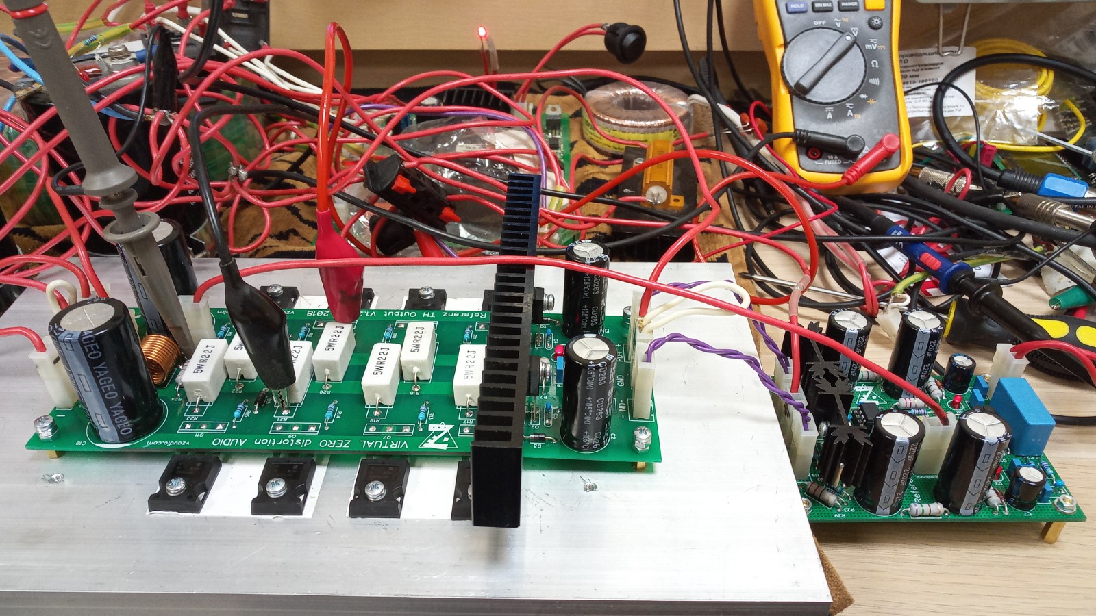

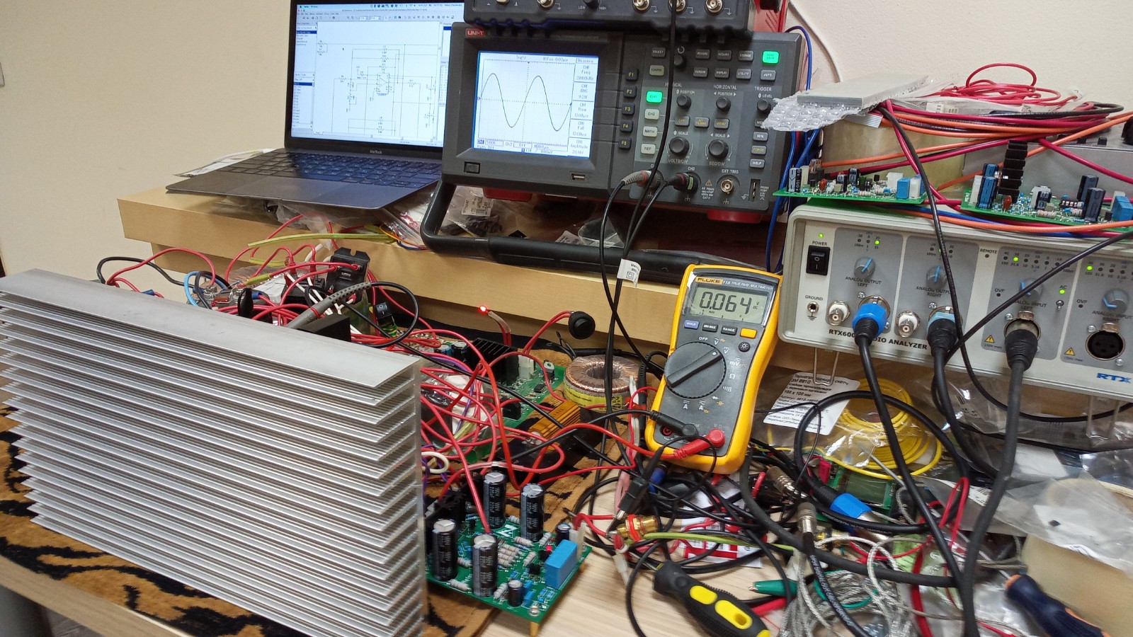

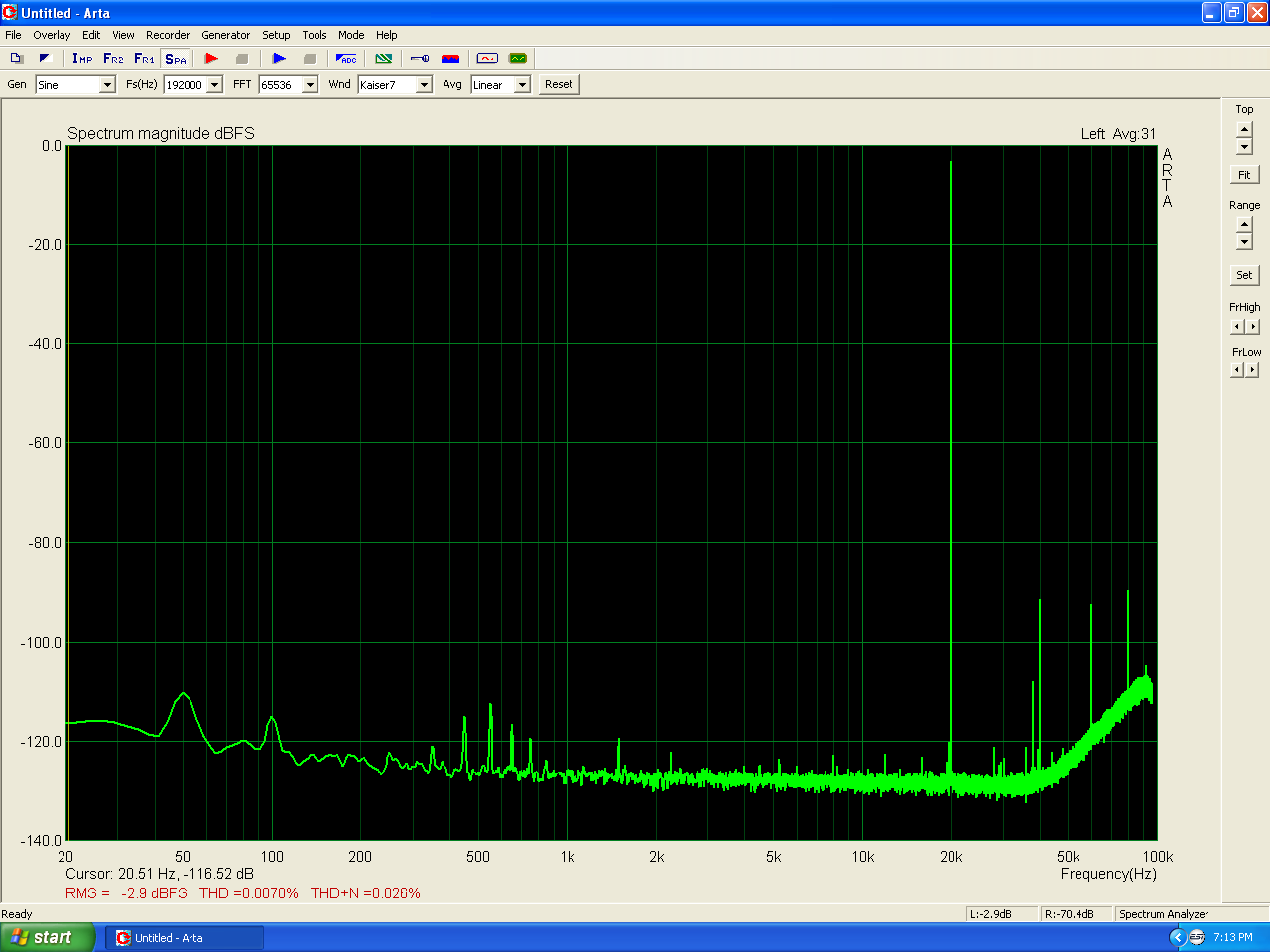

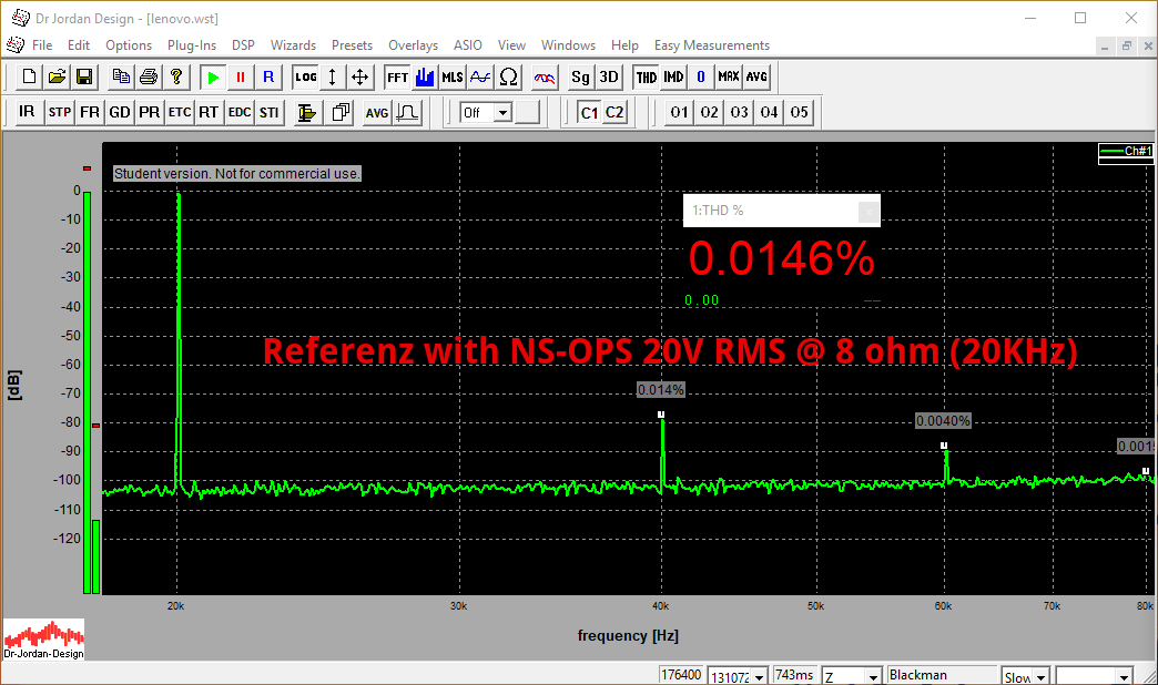

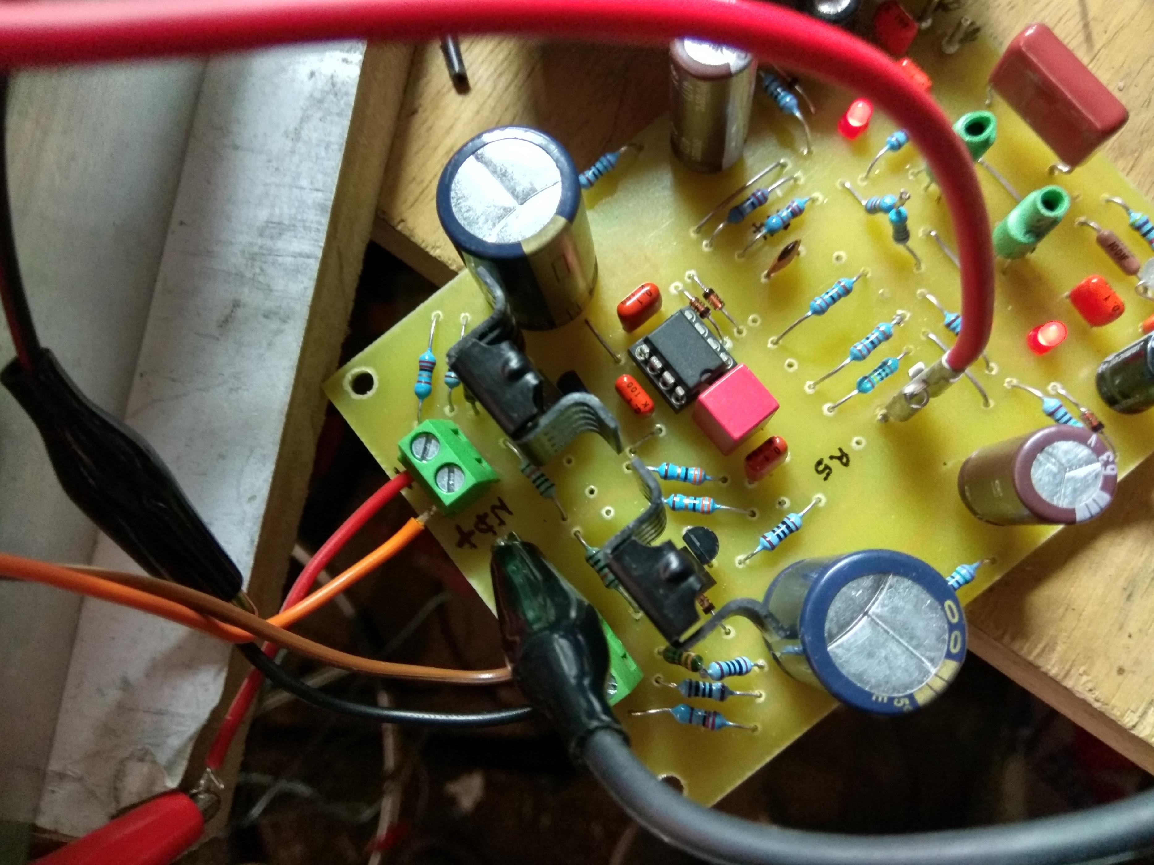

Referenz IPS board prototype - first tests
OK, I have finally got the boards and tested the front-end with my good-old NS OPS early prototype. Running well - I have done some fine-tuning, more details - tomorrow, as well as the full test with Referenz OPS. Excellent IMD performance!
Valery
Valery

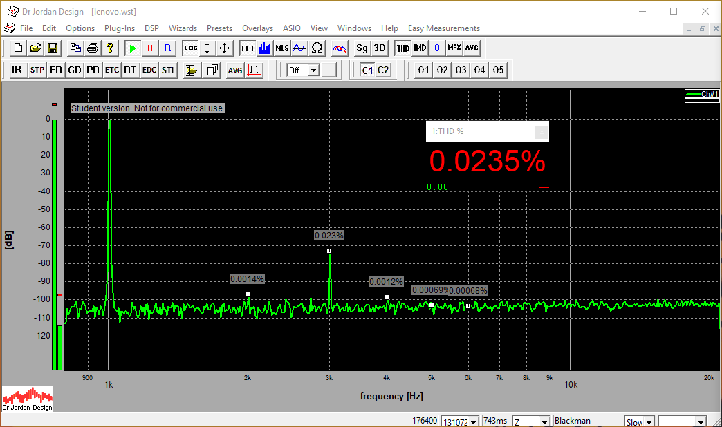

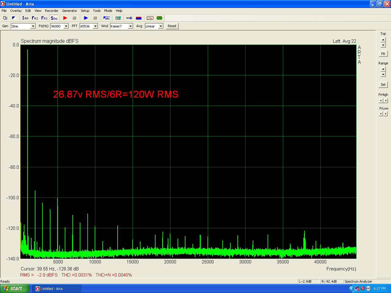

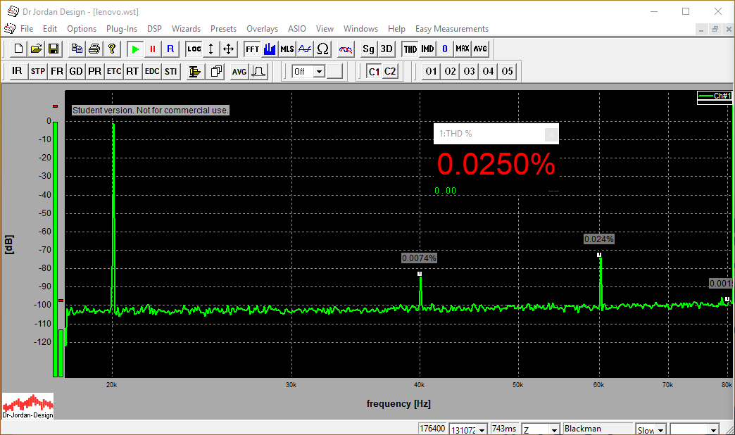

Full Test
As promised - full test with HexFET OPS.
After a few initial measurements I have increased the drivers' quiescent current up to 15mA. With the heatsink good enough they feel fine. HexFETs are running at 80mA per pair.
H3 dominance is the specialty of this OPS. What is important - no high-order components in both THD and IMD.
Spectrums are measured at 20V RMS @ 8 ohm.

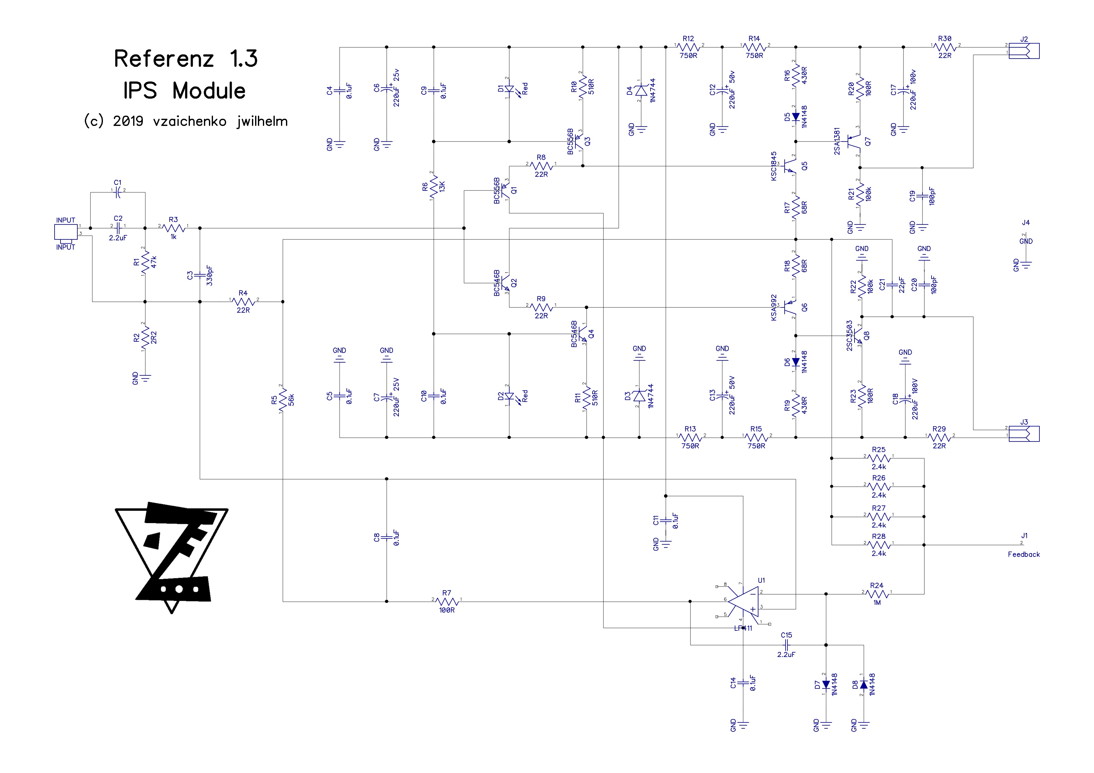

Referenz 1.3 docs "as built"
Here are the docs based on my live prototype, as built and tested.
PDF images for etching with bigger pads and smaller hole marks are in the archive. I did some tests at the increased ambient temperature, heating up the IPS board with professional dryer - as soon as the temperature increases, the VAS current goes a little bit down (from 6mA to 5.8mA), ensuring safe operation in varying conditions. The drivers require a good local heatsink though.
I also did some listening tests with the shelf speakers in my lab - although I was listening to the single channel, its "character" is rather similar to the one of VHex+, providing the transparent sound with solid bass and lots of details in the mids-highs. Dead silent with no signal. A very fine amplifier.
If assembled correctly - it will work properly at the first power-on. Just set the HexFETs' idle current to 80mA per output pair and readjust after 20-30 minutes warm-up. DC offset is zeroed-out automatically - controlled by a servo.
Some questions - please let me know.
Valery
Valery

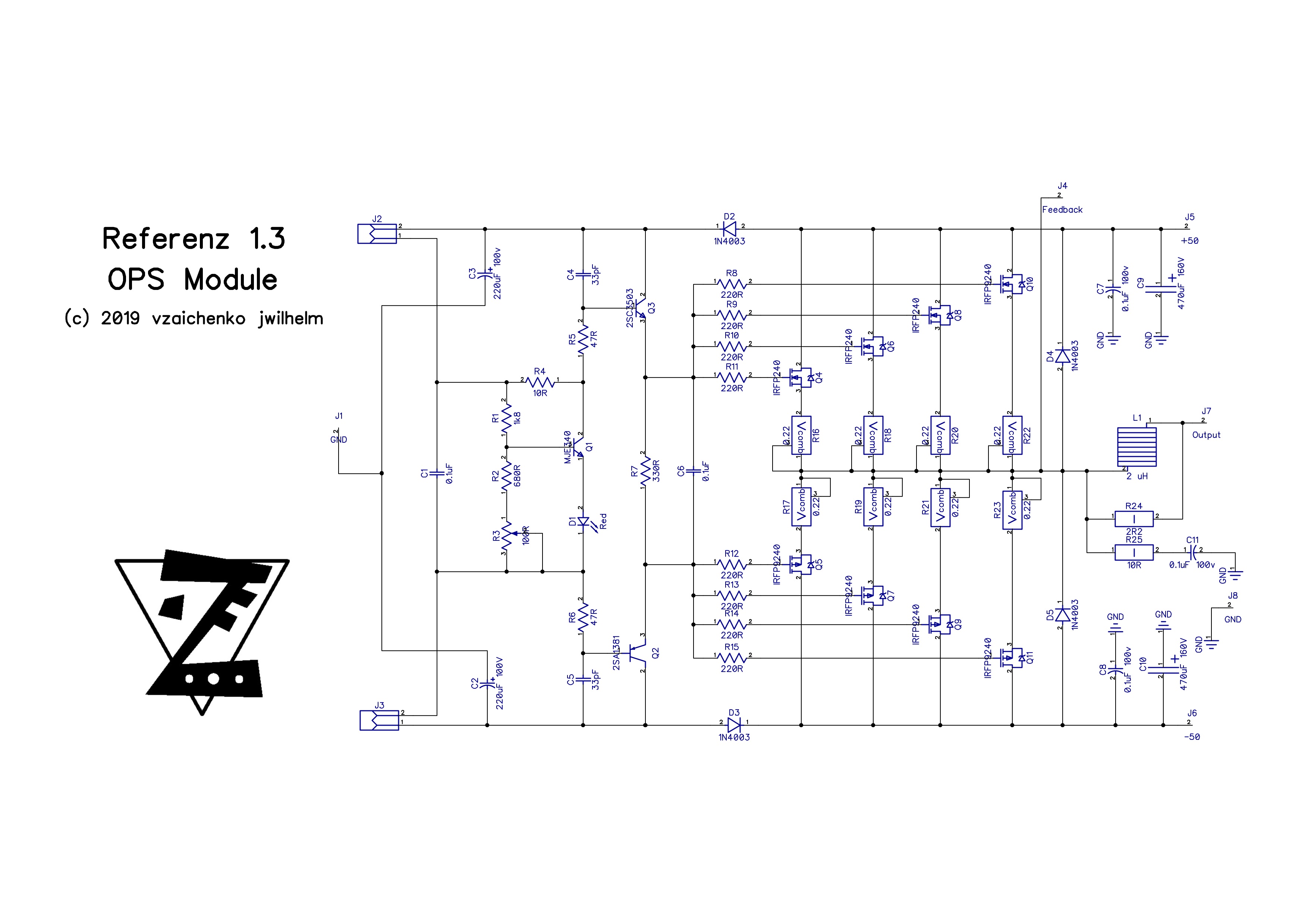

R5=56k(servo out) different connected in this schematic and different in post #20.
What is the right connection?
Thimios, thank you for the observation - this mistake has come back again.
It's connected the right way in the layout though.
I will correct it again. It has to go to the amplifier's input pair.
