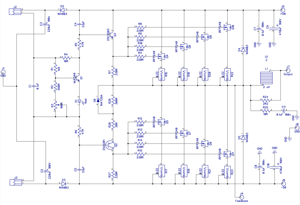

Should resistors R17/19/21/23 be on mosfet Q5/7/9/11 sources instead on drains in quasi output stage? Top mosfets operate as common drain (gain less then 1), but lower ones operate as common source (with the gain more then 1) as they see speaker +drain resistors as load? Also, would putting resistors in sources instead of drains in lower half quasi OPS will give better current sharing between mosfets and better temperature compensation?
Gosh! 🙂 Of course, they have to be on sources. Thank you for pointing this out.
I have them on sources in the initial design and simulations, but then re-drawing the schematic in Diptrace with some copy/paste always leads to some stupid mistakes :Ohno:

Could you try in sim whether adding "Baxandall diode" parallel to R26 in quasi output stage brings anything useful...the idea is to mimic the same paired V drop and impedance characteristic in the lower output half of the output stage as the paired base-emitter junctions occurring already in the top half.
I have already performed some experiments - because of the HexFETs' rather high Vgs, I have to use something higher-voltage than a diode, but the idea is pretty much the same and it works well, also eliminating the "blip" when clipping. Please see the schematic in the next post.
Updated Quazi OPS with lower distortion and good clipping
OK, now this one is good.
The network with zener at the driver's emitter leads to slightly lower distortion and much better clipping behavior. The bottom side clips a few volts earlier than the top one, but that's not an issue, considering there's no rail sticking or any other artifacts - clipping is flat now.
I will update the layout accordingly soon.
P.S. The OPS runs well at the quiescent current = 100mA per output pair. It can be raised up to, say, 300mA per pair for widening the class A region - just make sure to have some good heatsinks in this case - overall dissipation at 1.2A of the total idle current is not a joke anymore 😉 With +/-55V rails it comes to 130W per channel.

Could you try an IRF640 (without any suffix) wired as diode...btw IRF540 is the same m-fet as IRFP240 in different housing.
Good idea!
IRF640 with "gd" as an anode and "s" as a cathode works great.
Very slightly lower distortion at 1KHz, more significantly lower distortion at 20KHz. It has to be paralleled with 300R resistor for the best performance - this parallel combination provides the best "mimicking" of the top driver's characteristics.
Good🙂...but for the best "mimicking" of the top driver's characteristics more radical surgery is needed...see LM12CLK simplified OPS for inspiration (this one comes from "old guys" at National Semiconductors)
No it is not...it is the same quasi output stage found in all Overture series amplifiers like LM3886 and all sisters and brothers. That is the reason why every one is asking: "what that diode doing in the output stage"... it 'not an diode, it is npn transistor which behaves as diode at certain frequency.
