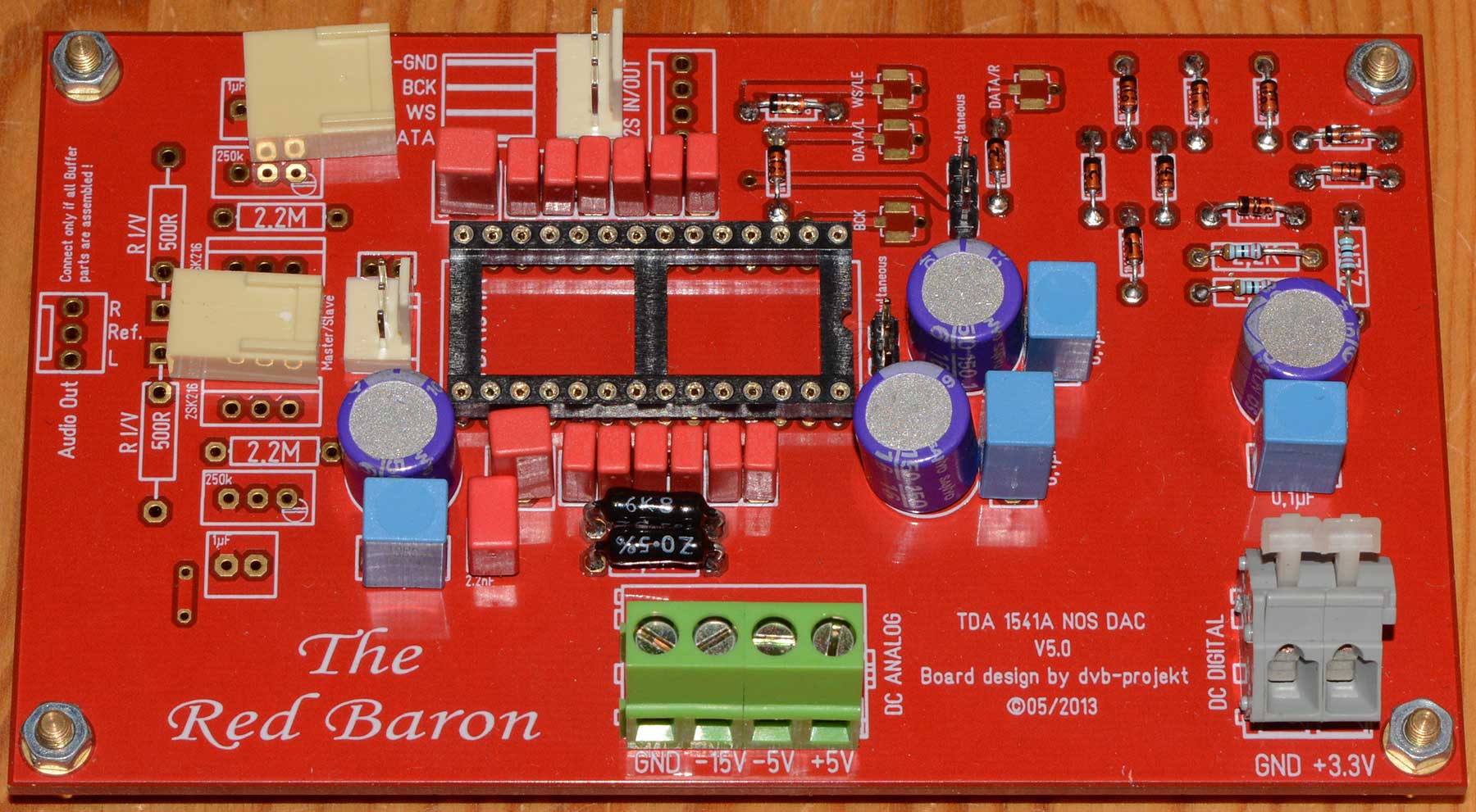

hi Oliver,
are there any reasons why you use smd caps in red baron v.5 pcb?
is it because the smd are better than the film caps at this positions?
so far i couldn't find any best reason about why using the film caps like mks mkp or smd caps like ceramic or mica, for those decoupling caps.

This is the board I ordered recently that will be parallel with the one on pre-order.
I've got all parts needed to fully populate the board should I want to except the 2SK216's as the ones I ordered were fakes(wrong pinout). Got my money back no questions asked though.
I got BEYSCHLAG 500R UXC0309-25 0.1% 1/2W (0.5W) 25ppm for the I/V, OS-CON SA for the 150uF, WIMA FKP2 for 2n2, VISHAY BC MKP380 for the 100nF, Holco's for 6K8 and Vishay's for the other resistors, followed the BOM for the decoupling caps.
I actually made the effort to match the 1N4148's, I had tons and figured it wouldn't hurt.

Hi wengtech,
i modified active divider decoupling pads for better SMD 1210 caps soldering, because of a recommendation from -ecdesigns-, but you could also use the Wima MKS on the position.
-ecdesigns- said:Stacked foil PPS SMD caps that have very low inductance and very low mechanical foil resonance.
Conventional foil caps like the WIMAs consist of foil winding that's pressed into a flat shape (I opened some of these caps to have a look inside). This results in areas with high mechanical foil tension (curves) and low mechanical foil tension (flat area). This results in mechanical foil resonance. This basically creates conditions similar as with an electret microphone. The charged foil movement translates into unwanted ac signals that distort the DC bit currents.
Leaded caps also have higher inductance (increased resistance for RF ac signals). This in turn degrades decoupling effectivity.
Keep in mind that the active divider decoupling caps are used to suppress glitches from the electronic switches and ripple current from passive divider mismatch. Fundamental is at approx. 200 KHz, higher harmonics are also present. So RF / HF decoupling is required, this also means that every mm counts and shortest possible wiring is required.
Since the decoupling caps connect directly to the bit current outputs, the slightest ac ripple current on GND (> 61nA) will result in dynamic bit errors as unwanted ripple current is super-imposed on the DC bit current. The cap acts as low impedance and simply "pass on" the GND ripple. Thus the cap itself cannot prevent this.
This means that no other (supply or interference currents) must share decoupling cap GND return path.
I mounted the SMD caps underneath the DAC chip and routed GND for left and right decoupling cap group straight to pin 5 (AGND) thus preventing other GND currents to pollute the bit currents.

what about this one?
the supplier said it is 180nf mica (wima)
is it good/enough for decou positions?
thanks.
If you want to go with the SMD´s, please use the recommended in the BOM.
