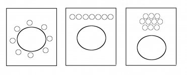

So, Arrays are a thing, speakers grouped together perform as one diaphragm, theoretically, yes? These are the ideas that came to mind, the chosen 15" along with the chosen 4" coaxial. I think the 3rd is the most practical and the first example is extreme and I have no idea what it would sound like but it sure would look cool. This is also a solution for power, and distortion that might of other wise been a factor. I could go even farther and do a sub array below. Thoughts?

so array speakers are a no no for near field.....
Room correction is needed in my room, I have a null around 50 and 100. I could probably set them up better. It seems that the 4" coaxial I desire is not a real product. I guess I'll just focus on my subs =( its not that I needed this to work but. I love using best practices.
Arrays are problematic, in that in a normal domestic room, at some frequencies you are near-field, and at some far-field. And you really need EQ for a line array, and DSP provides the easiest, and most powerful EQ.
For near-field it is hard to beat a good single driver speaker.

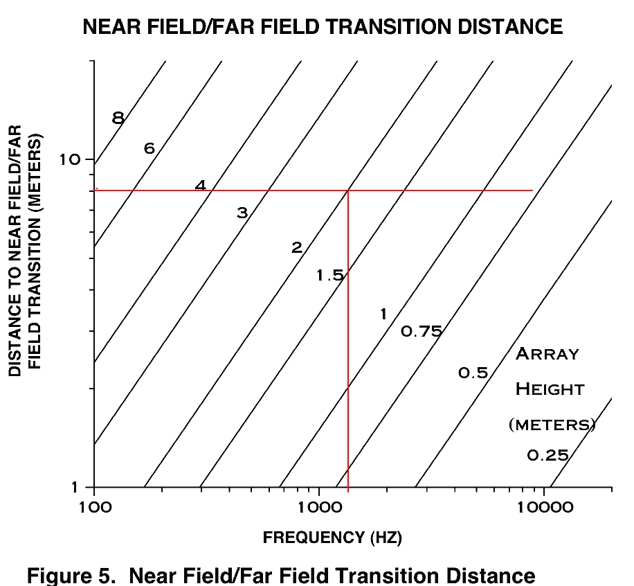

You certainly have a vastly greater experience with line arrays.
I only follow from Griffin:
attachment.php
Where it suggests that at 2m from a 2m tall line the transition is just above 1k.
For anyone considering a line arrary, Jim’s paper covers off a lot:
https://audioroundtable.com/misc/nflawp.pdf
But a much earlier (1964) paper by Paul Taylor also has relevance (and some very telling diagrams):
http://p10hifi.net/TLS/downloads/taylor-line-array.pdf
And a recent theoretical analysi: Infinite Line Source: analysis
And the question of near/far transition has a thread of that title: Line array size vs near field/far field transition distance

The reason for me to mention a floor to ceiling line array and not a finite array :).
I thot that with a bessel array one had to be in the far-field for them to work?
dave
It depends on where you want to 'draw the line' on what constitutes an array's 'near-field' distance: The Bessel Array
In retrospect though, not really interested in rehashing/defending this, so I'll qualify it as something one ought to try, especially if for a TV soundbar system or as part of a multi-way speaker where depth doesn't allow horns.
