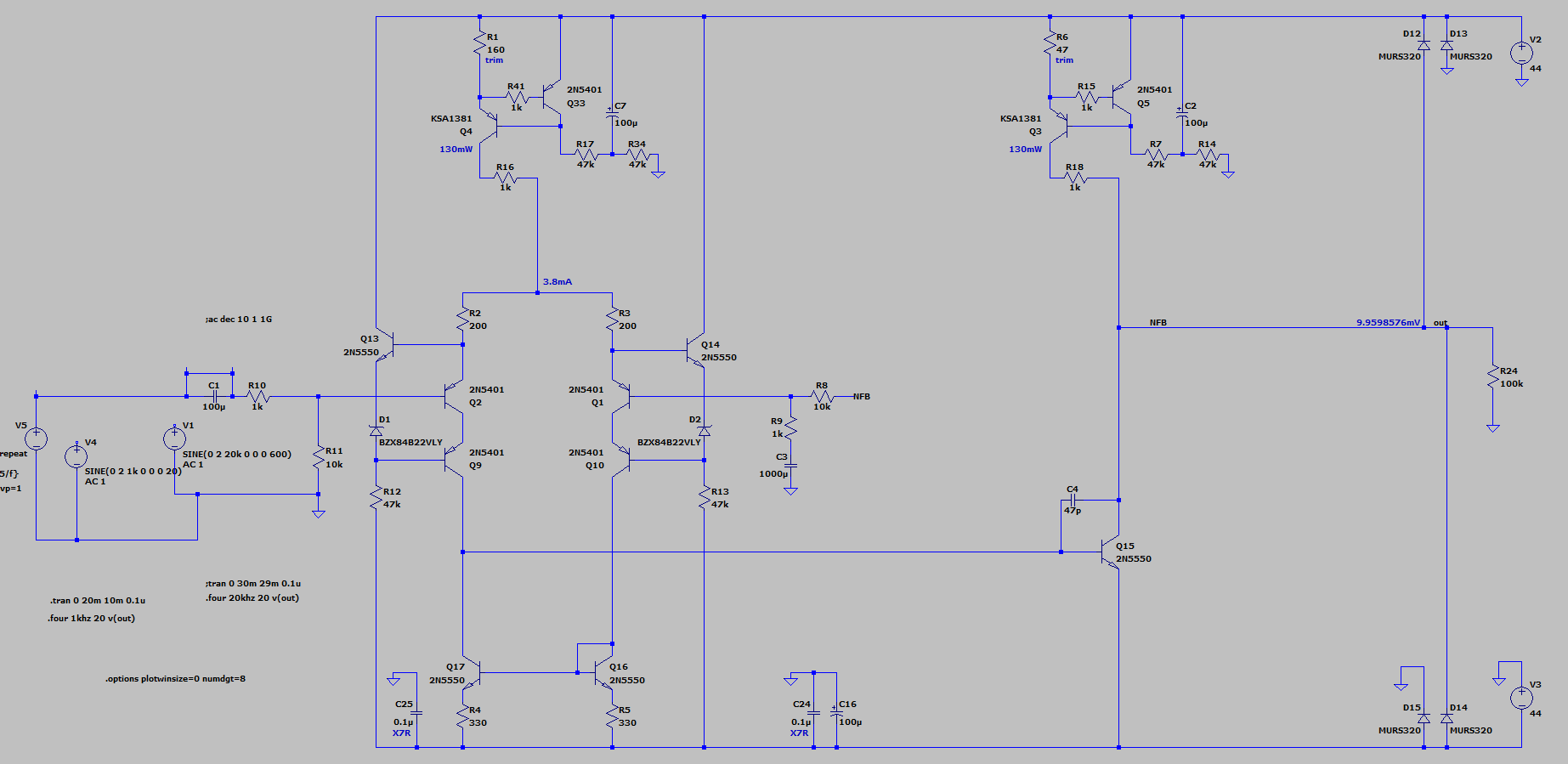

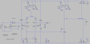

Reference discrete amplifier inspired by Wolverine and Cordell book
Check what Vcesat is for Q1 and Q2, as they probably aren’t working as well as you are hoping. In reality, Q9 and Q10 are probably working as the differential pair, rather than Q1 and Q2.
You were right. All of the current was passing through common base transistors instead of equally sharing between the two.
The fix is to select zener to bias to the half of the power supply voltage.
I verified by isolating bootstrapped cascoded IPS.
Now all of the power dissipation is nicely shared between LTP transistors.
Square wave response is nice and clean with no ringing.
